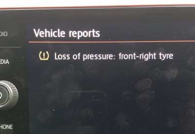

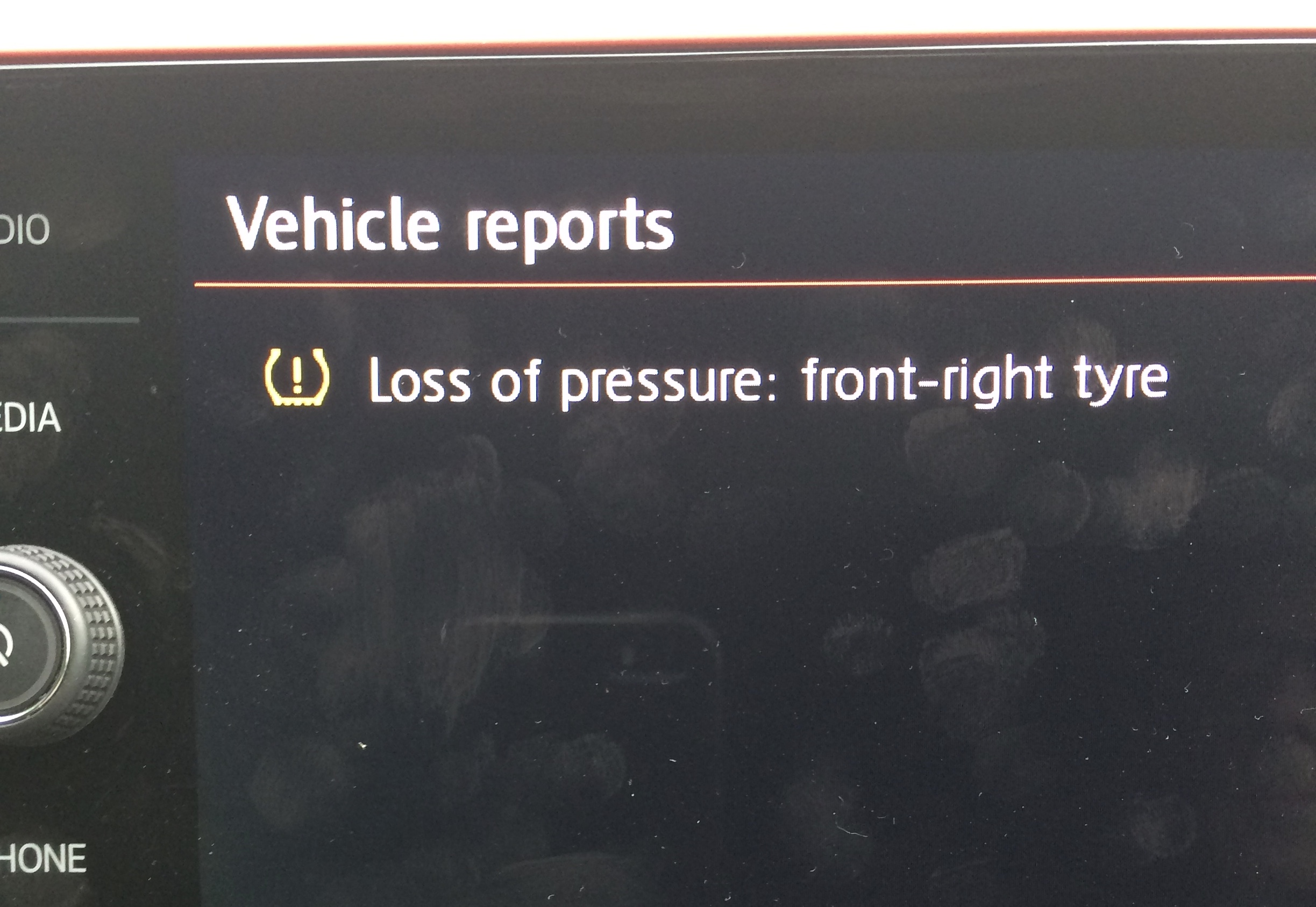

Further to my previous post about a spurious alarm - without an indication as to which wheel was the problem .......
Today my wife calls to say the tyre alarm has activated. Front RH has a problem.
She checked the pressure and found it had lost about 8psi.
I trundled over to her location - complete with full wheel change tool kit - to find that there was no visible leak or puncture.
Found a garage airline a mile away (£1 a pop) and inflated the tyre to 40psi.
She got home ok, so I’ll check it all over again tomorrow when all are cool.
My biggest surprise after the previous alarm, was the fact that the alarm detail identified the front RH wheel, which didn’t happen first time.
ps - new winter wheel / tyre set has only been on for 13 days and a few hundred miles. Grrrrrrrrr.

Boxerboy wrote: Fri Jan 24, 2020 7:39 pm Further to my previous post about a spurious alarm - without an indication as to which wheel was the problem .......
With an 8 psi pressure loss in one tyre over a relatively short period, it does sound as if you’ve picked up a nail, screw or some other sharp object in the tread or the inner sidewall, so isn’t visible when the wheel / tyre is on the car. Is it possible the tyre has been damaged as a result of hitting a pothole? Alternatively, you may have a faulty valve, or the tyre isn’t sealing perfectly around the rim of your wheel, but that’s probably less likely than a puncture.
I’d suggest removing the wheel and inspecting the inner sidewall and tread thoroughly for damage.
