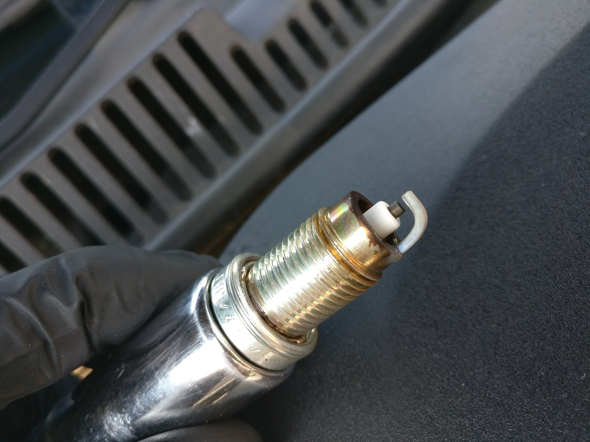

I ran up the engine to full temp and gave it some high rpm running today.
Old NGK BKUR6ET plugs were replaced with ZFR5P-G.
It's not running rich:

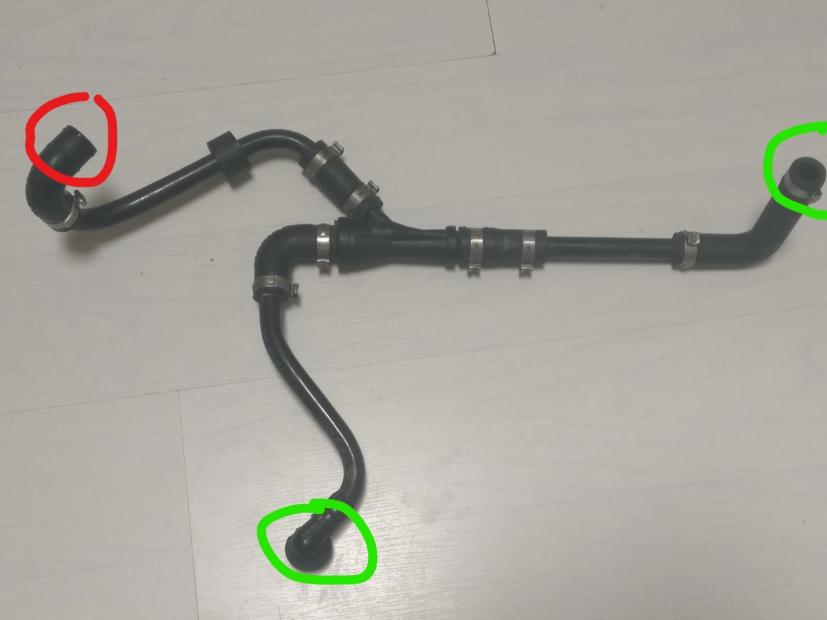

I removed the hose to check visually for any splits, etc. but could not find any. The openings indicated by green ink pass air one way (by lung power at least). There is no air passing either way through the opening indicated by red ink (which connects to the air box).
The connector to the brake servo did seem a little loose but I guess it's sealing OK nevertheless.
I don't have a high pressure line to test properly. Might try and rig up a bicycle pump and use a bowl of water.
Any other possibilities for the emissions problem? Inlet manifold?

Possibly. Its air coming in after what the engine is expecting via the intake.Smoke test might be helpful
