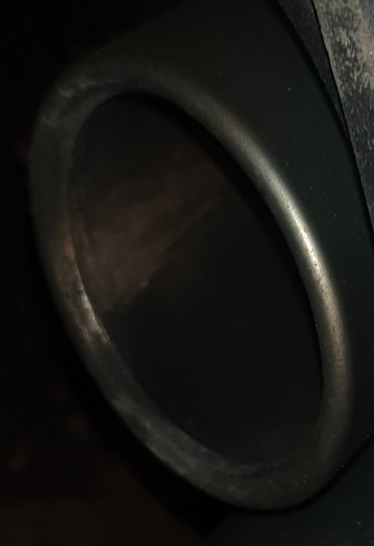

Car itself is very dirty right now but lower part is black (not wet) and in summer this part was visibly black while rest of that lip was nice and shiny.

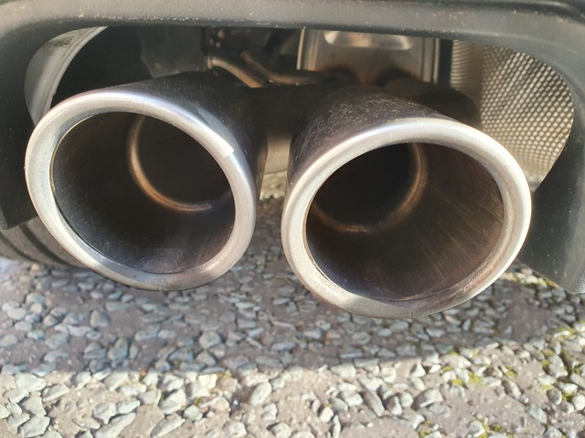

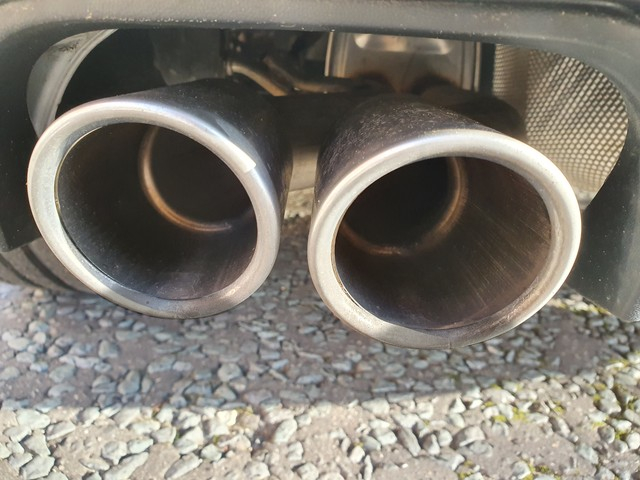

I'll take pics of the tailpipes on mine and the wife's GTI+ to show difference between the 2 cars.

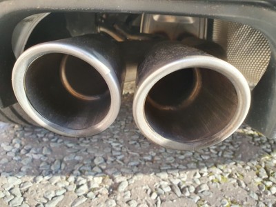

GPF fitted 2019 GTI+ tailpipes, approx 4k miles.
2018 GTI+ with no GPF, approx 12k miles.
Excuse the filthy exterior on the non-GPF pic, that'll be general grime (pipes never been cleaned). Compare the interior of both pics to see how good a job the GPF is doing.

:D oh nothing like that on my GTI :D
I edited your photo to show how was mine looking few months back :) definitly nothing like your non gpf polo :D
