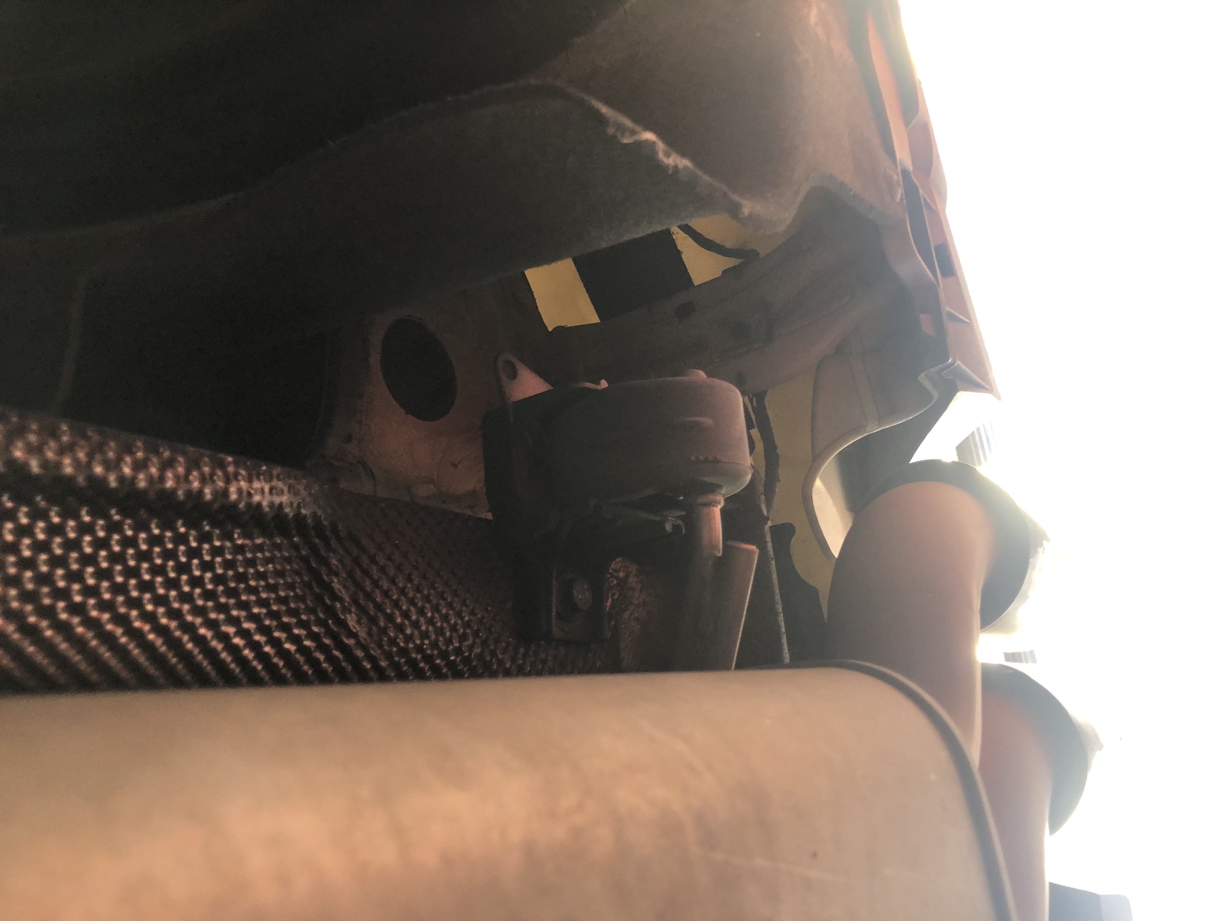

Not sure if this helps anyone.
What is this on the right on the exhaust? Looking at it from underneath the car.
stuartrendall
Posts: 141
Drives: 2020 POLO GTI+
Location: Derbyshire
Re: Exhaust valve and aftermarket exhaust
Post by stuartrendall »
jbGTI wrote: Fri Jun 26, 2020 7:56 pm EBF983CC-E01B-48E8-B984-CF32C217D45B.jpeg
That's a rubber exhaust hanger. Holds the exhaust on place while also allowing it to flex.
