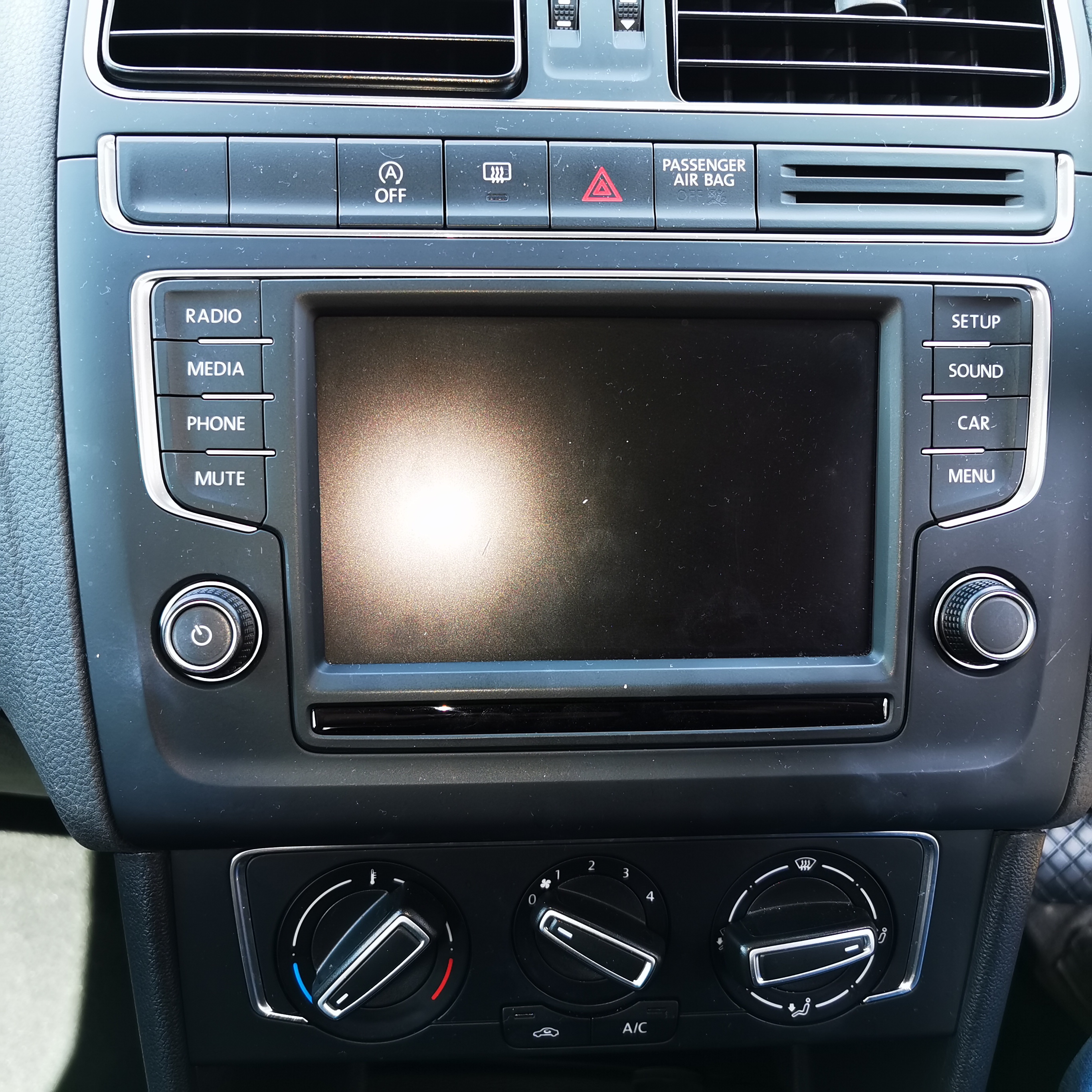

did you accidentally disconnect the passenger airbag switch in the glove box?
- Posts: 25
- Joined: Tue May 26, 2020 8:08 pm
- Drives: 2014 1.2 TSI blue motion.
- Location: Dublin
Re: 6C or 6R..I'm not sure
Disconnected it completely to remove the glove box to allow access to the head unit and connect the new radio to the quadlock..
