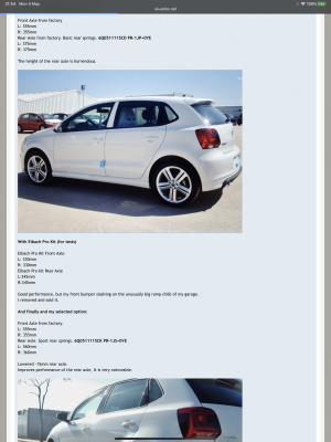

Can I ask you what's the ride height? (from the center of the rim to the fender) Because I'm collecting everything to put the original configuration back but I'm taking measurements to see how much will be taller than my current configuration
Ride height I fitted as per ciclo guide the lowest genuine rear springs which makes the car with original front spring drive much smoother and hand very well,
Search his post on his R-line the guide of all spring heights is in there.
Perfect, thank you so much
