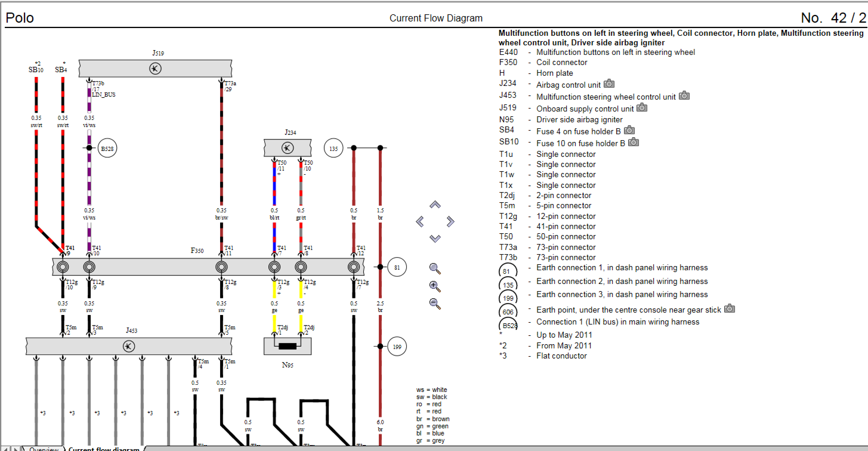

I have the base trim of Skoda Rapid (PQ 25), and it does not come with a steering having mounted buttons. Even the MFD function is not enabled as there are no controls on the steering wheel or on the wiper stalk (the higher trims in Indian Rapids have the MFD toggle on the wiper stalk).
Now, I have had the benefit of reading your responses on this thread, which tell me which steering controls will work considering my car is based on PQ25 platform. However, the queries were in response to another member whose car already has MFD enabled and has a steering with mounted buttons. Considering that my car has neither of the two, I have the following queries:
1. Can I install a steering with mounted buttons (from the list mentioned above for PQ25 cars)?
2. If yes, do I need to do any special wiring, or will it be plug and play? I understand that I will be needing a new airbag harness as my current harness does not have the black cable for mounted controls. Anything else?
3. If I choose to opt for a steering which has MFD controls on the right side, can I use it to access MFD data?
4. If yes, do I need to do any special wiring, or will it be plug and play?
Happy to share detailed pictures with part numbers, as required. Sorry for the long post, thought it will be good to provide all the information in one place for your consideration.

skoda_indian wrote: Tue Sep 22, 2020 10:26 am 1. Can I install a steering with mounted buttons (from the list mentioned above for PQ25 cars)?
1: Yes you can, depending on whether your steering wheel is mechanically capable of mounting the buttons
2: you'll need to run two wires to your stalks/slip ring connector (one to the BCM, one to the fuxe box) and indeed an adjustment of the airbag wiring harness. And code it with i.e. vcds
3. Yes
4. You also need to enable this with i.e. vcds, no further wiring needed.

I finally managed to do the wiring and coding on my 2020 Rapid TSI (PQ25), but even after the wiring, the MFSW doesn't work or light up. Even the horn doesn't work. I have verified that the LIN wire from the BCM and the +12v wire from the lightswitch are getting power, yet nothing works. Also, the steering buttons are also compatible.
Could it be the airbag harness? Will be very grateful if you can help me out here. Brief details of the part numbers set out below:
Car: Skoda Rapid 2020 - PQ25
BCM: 7E0937089D
Steering controls:5E0919719C
Airbag Harness: 5JA971584
Please let me know if you need any further info. Thanks a ton!

Managed to do it!!! :D :D There was an error with the LIN wiring. Fixed that!
