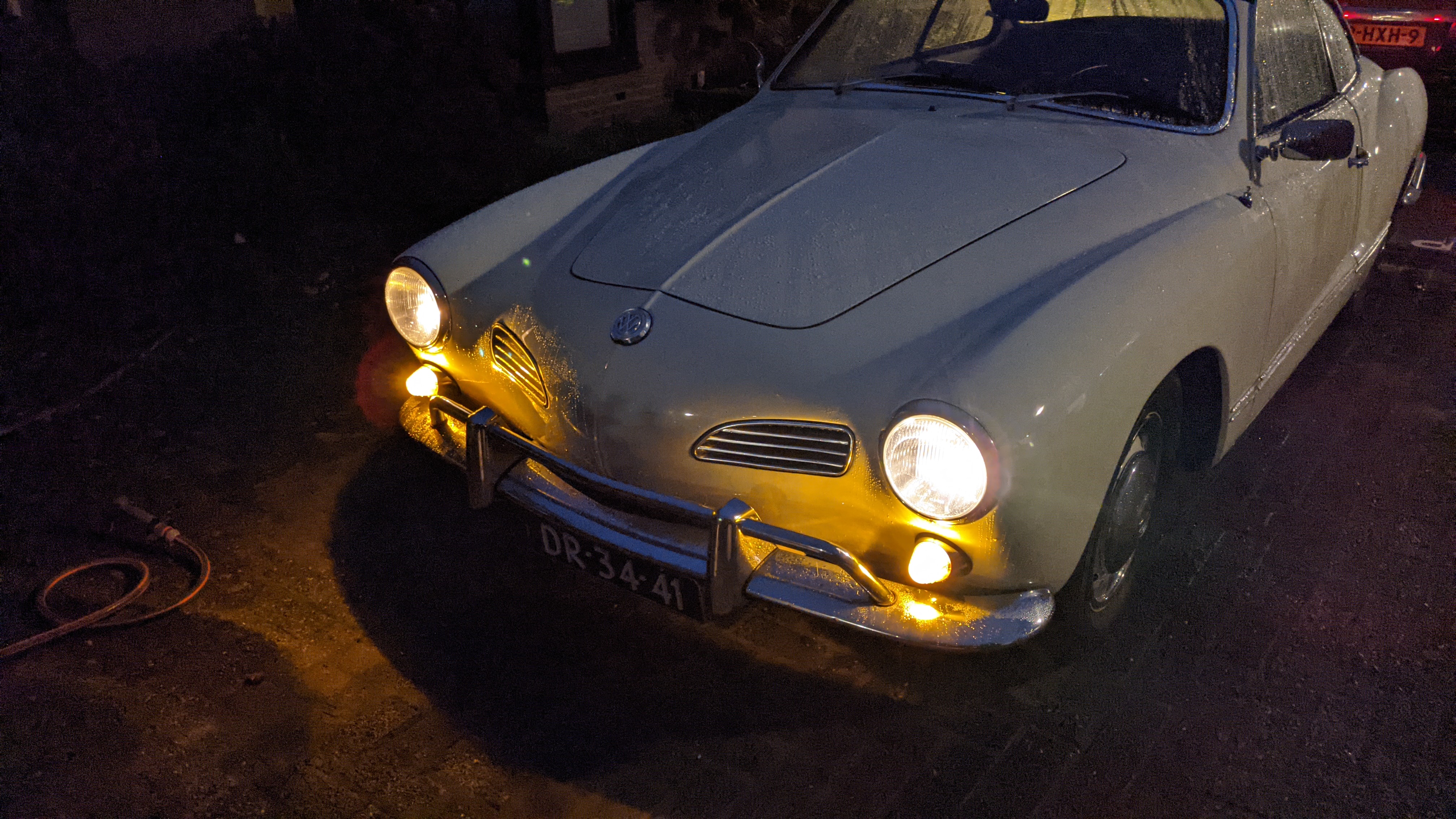

- Changed the front indicator fittings for bay15d so I can have US lights. after all, it is an original US car.

- Changed the windscreen washer pump from air pressure (from the spare wheel powered) to electric one from a Mexico Bug + modded switch to take a microswitch + relay

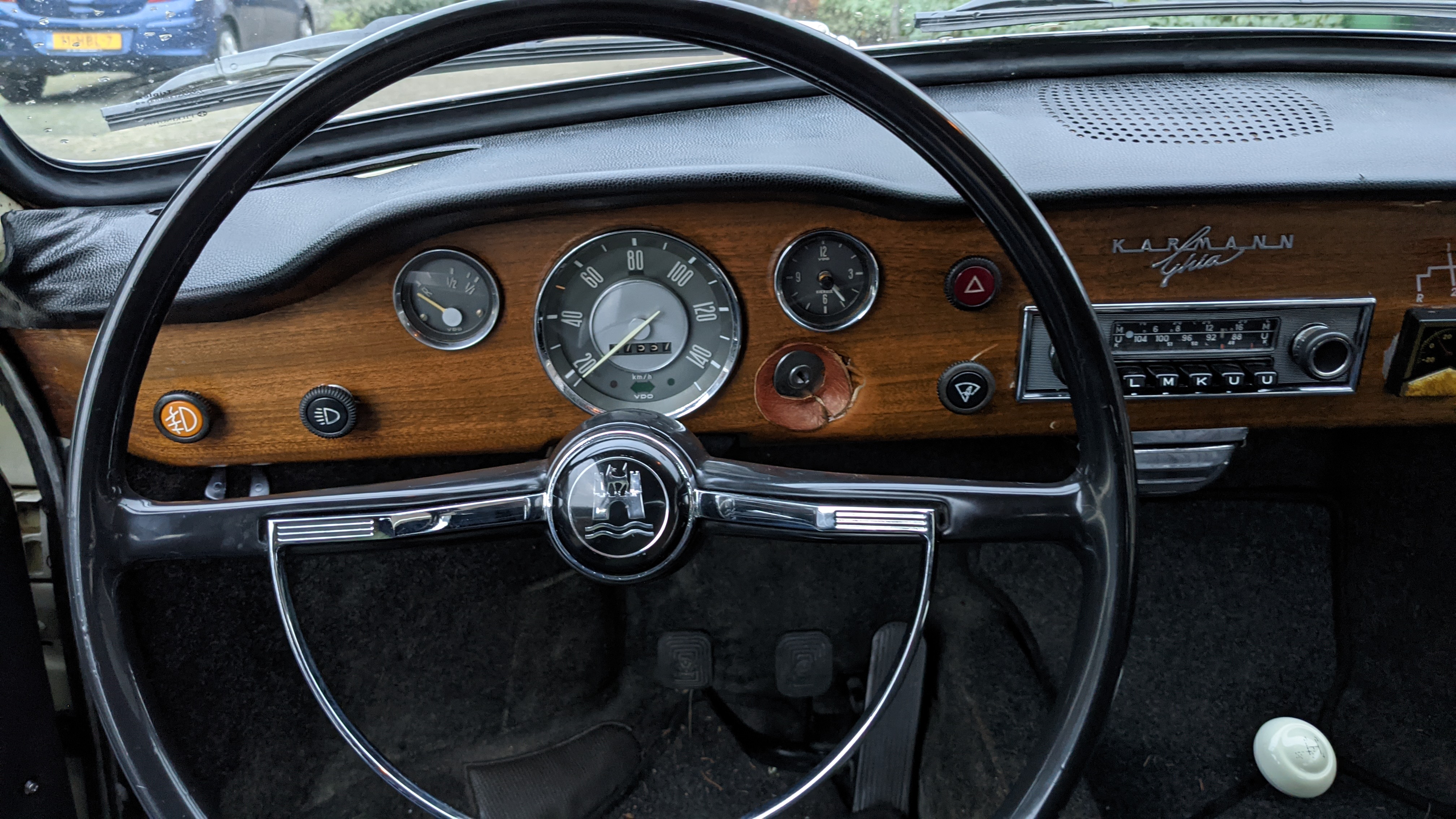

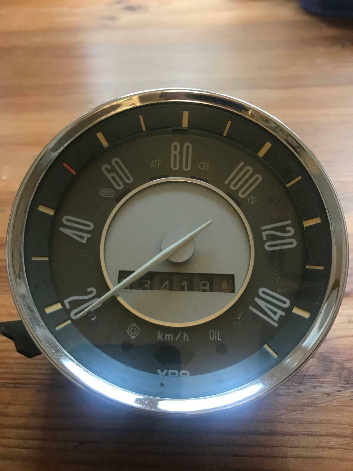

- Other instrument cluster with warning light for low beam, heated rear window and ATF temperature

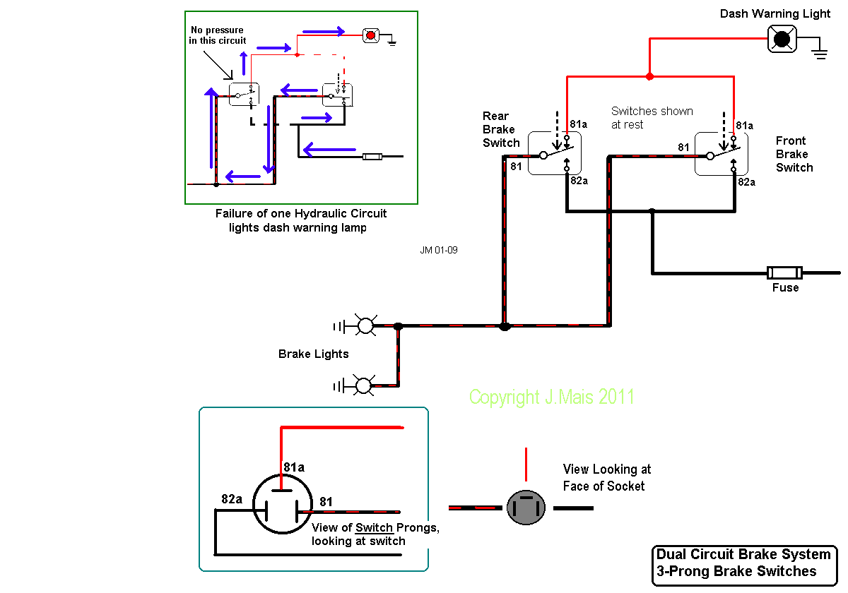

- Brake circuit warning light (will use ATF temp light for this)
Next job is to change the brake light switches from 2-pin to 3-pin versions and I'll be doing that on friday.

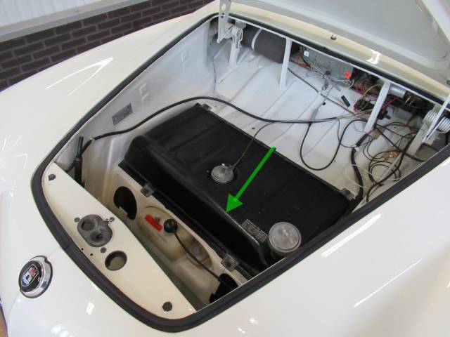

However I was referring to this oil leak, which is generating a layer of crust and dirt all around.
Re: iichels 1967 VW Karmann Ghia 1500 Coupé
Posted: Thu Dec 03, 2020 3:05 pm
by iichel
Yes, we're talking about the same leak haha.
I already dipped it dry, it smells like WD40. It will leak from the luggage compartment to below the fuel tank, driven by gravity.
The hose you're (almost) circling is the fuel line from the fuel tank to the rear of the car (it goes through the central tunnel of the car).
