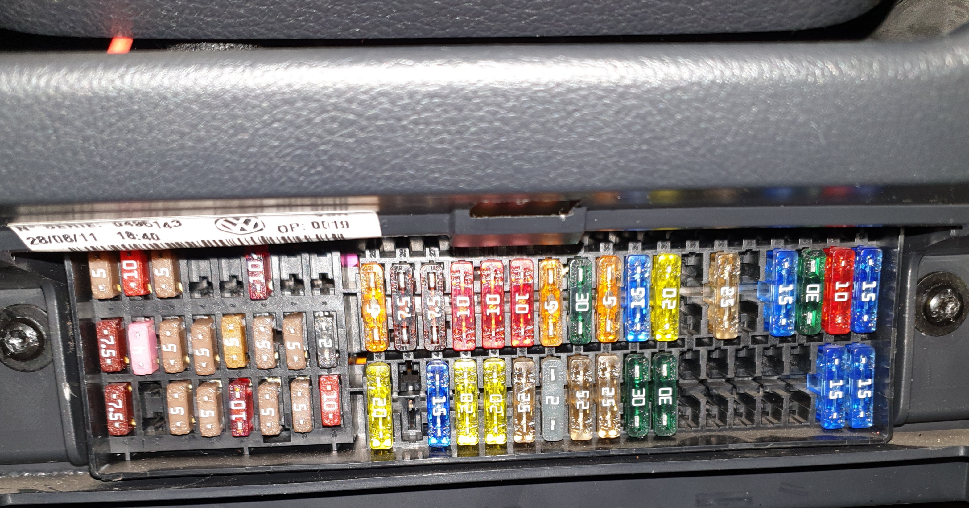

Check that a wire black/green reaches T73b/11. Take a picture of the fuse box.
Check/Set BCM adaptation channels 53 and 54 to 0 in case the values are 1. That is, from 1 to 0 in both cases.
In case you have installed LED lamps in some of the lights, tell us where you installed them and the exact model.
Study how the CH, LH and automatic lights work on the PQ25...

ciclo wrote: Tue Feb 16, 2021 5:36 am Check that a wire black/green reaches T73b/11. Take a picture of the fuse box.
No wire present at T73b/11
My fuse box
Channels 53 and 54 was 1, now set to 0
I have WV Original LED license plate, thats it, otherwise halogen bulbs

Your 6R is missing the SB57 fuse, the SB57 output wire feeds the BCM for the SCLs and Backup lights as per autoscan.
Easy.
Fortunately your 6R has an empty slot for the SB44 fuse.
Install a 1.0-1.5mm2 wire from SB44b to T73b/11 and put a 15A fuse on SB44.
I imagine your high beams are now working properly ... :?:
New BCM coding
: (LED plate lights)
3CB02FB848210000213807B17CEB1FD85A80672F600530C1200000030000
