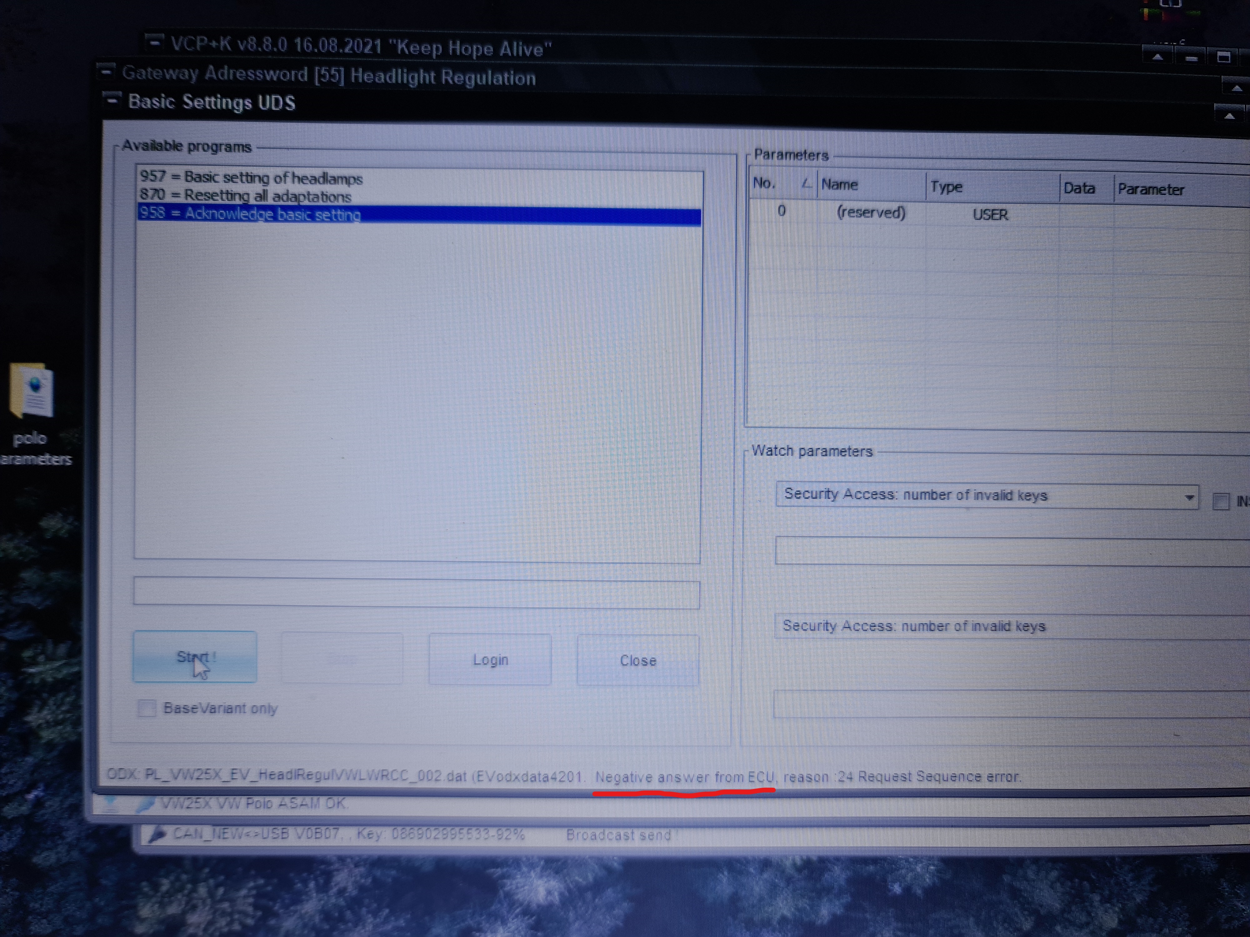

When i try to do the basic settings for the headlights i get this:

Still no results, when i try to code the module with 0112000001000000 it refused..

Try this coding: 0D4A000001000000
Re: 6C Full LED Headlights number
Posted: Thu Nov 04, 2021 4:32 pm
by ZahariGeorgiev
I always get this message: Recode error - 24 Request sequence error. I am not really sure where is the problem - the coding, the headlight range module (which is brand new), the rear axle sensor (which is used and it is from polo), or i dont know what happening, but cannot finish my project for HBA until i solve this mystery with the LED headlights :cry:

Hello ciclo,
I already did this, and get rid of that error, but still can't code the module, and do the basic settings and got flashing low beam, and no front parking lights at all :cry: :cry: :cry:
