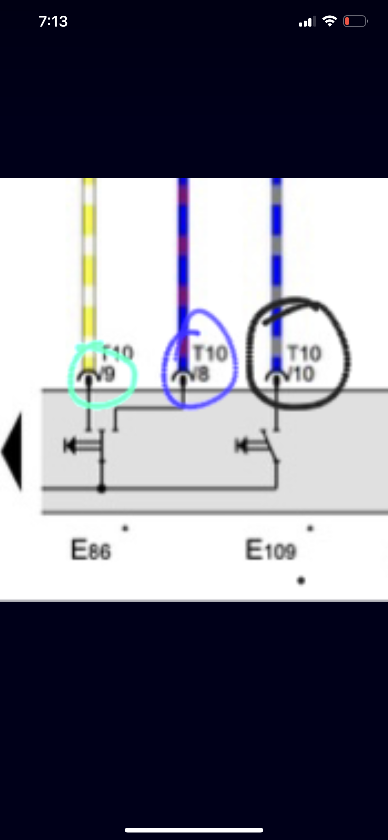

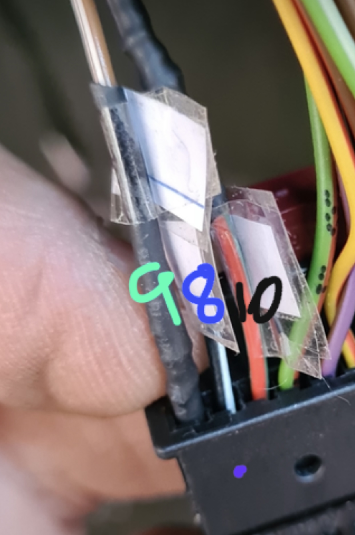

Atalv
Posts: 6
Joined: Mon May 03, 2021 5:19 pm
Drives: 6c 1.0 mpi
Location: Las palmas
Re: Giannis20vt's Polo 6c 1.0MPI
Post by Atalv »
Hi, a write to you in youtube sorry, but my english is not so good maybe here i can explain myself better
I was in doubt about the t10 connectors, the correct order is (9,8,10)
in the photo of your post you can't see it and I don't know if the order is actually (8,9 and 10) not (9,8,10)
giannis20vt
Posts: 425
Location: Greece
Post by giannis20vt »
no the orientation is always in the row of the numbers.
So the No10 is the cable at the end of the connector, the No9 is the next one and the No8 the next one.
