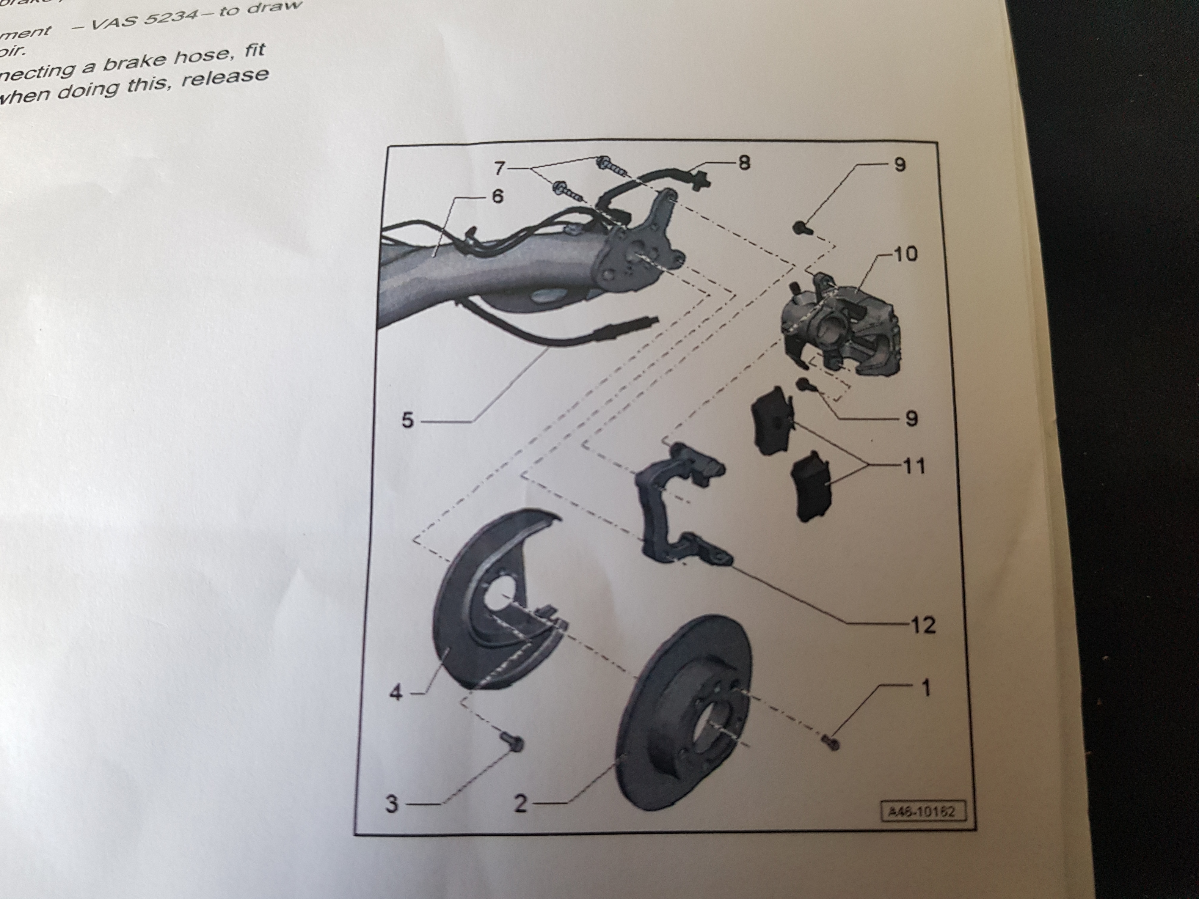

After seeing me friend at VW they gave me a print out, the caliper bolts get changed on removal, and torque to 35nm the caliper bracket to wheel is 30nm +30 deg and nothing saying about changing them bolts.
No:-7 Caliper Bracket
No:-9 Caliper bolts
What I need is a tool to do the +30deg, one I have seems crap, any ideas?
