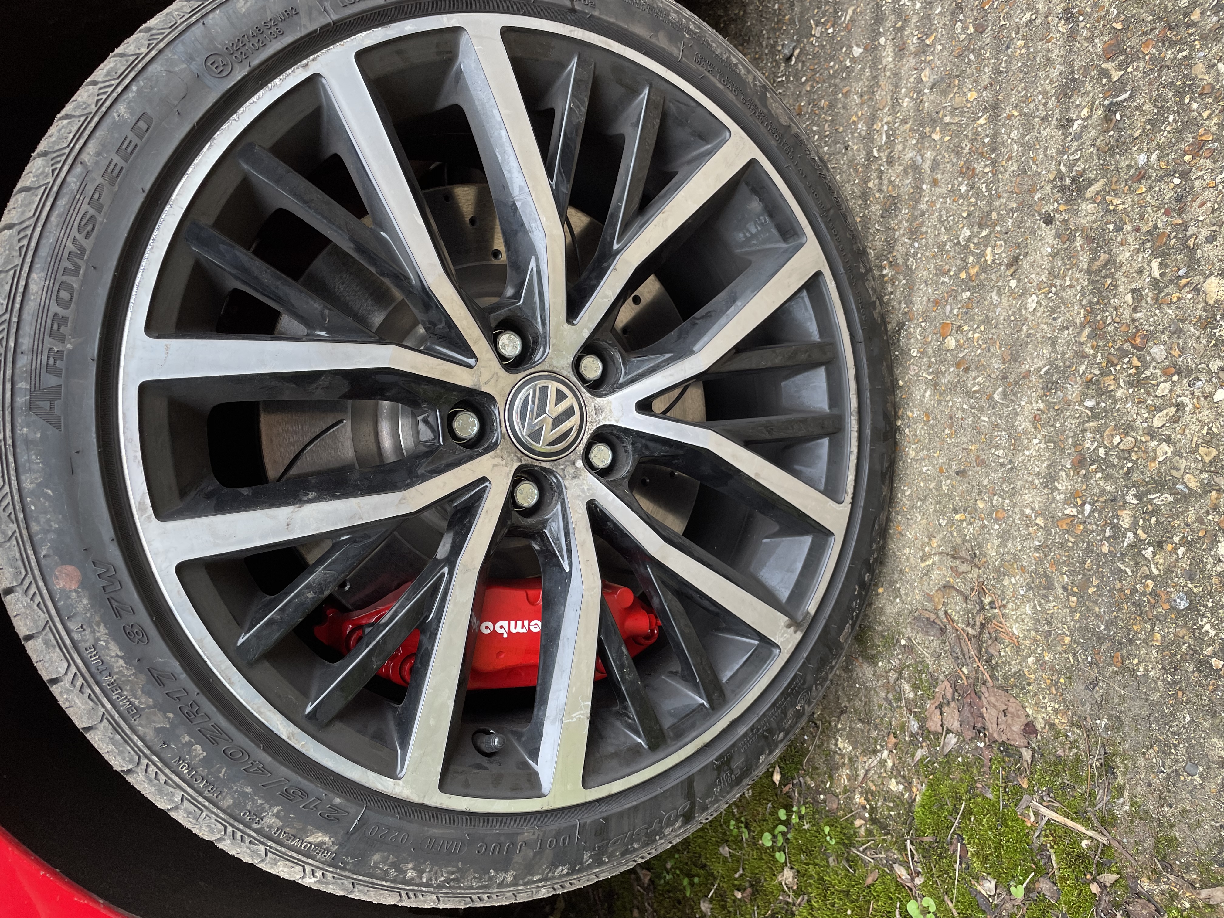

Thanks so much for your advice mate.
All fitted and working perfectly.
Polo Brembos
Polo Brembos

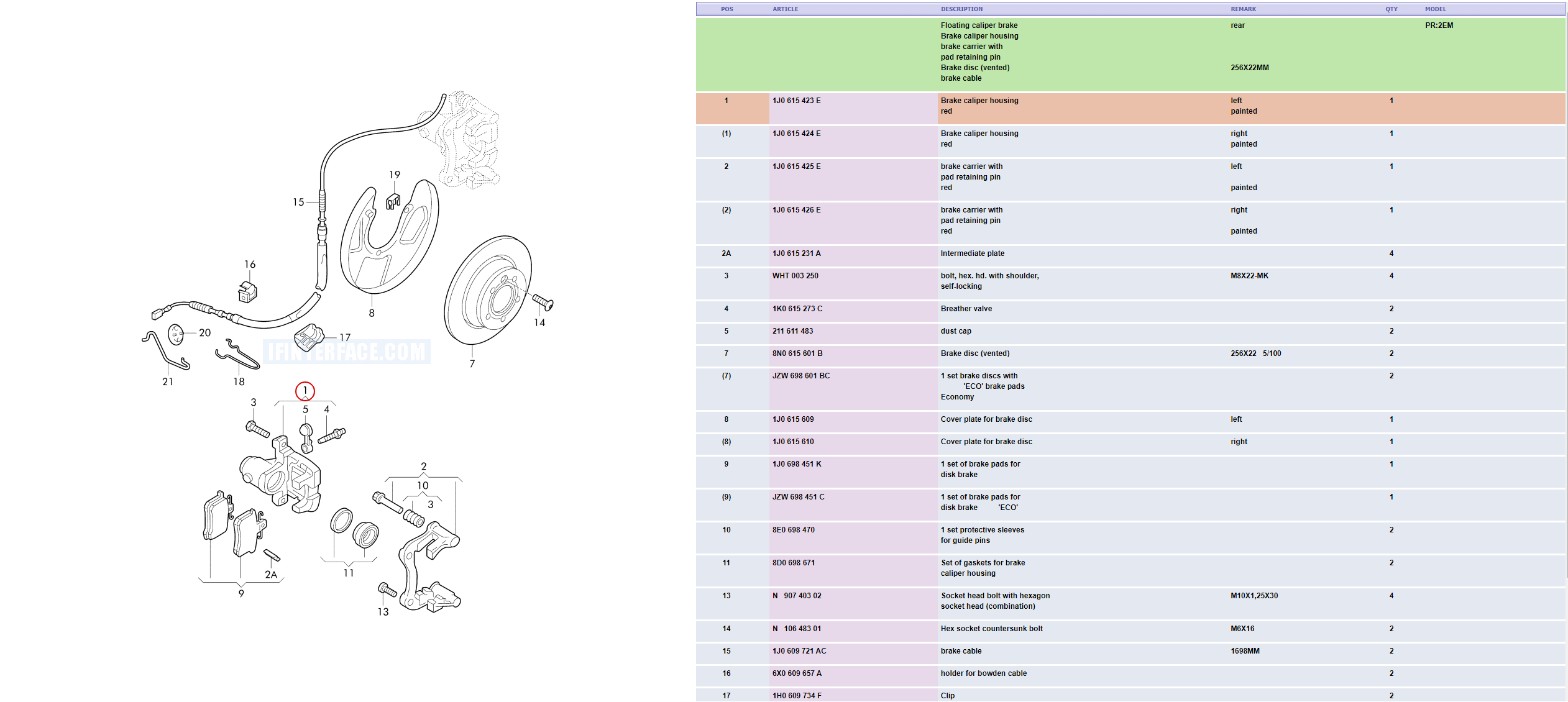

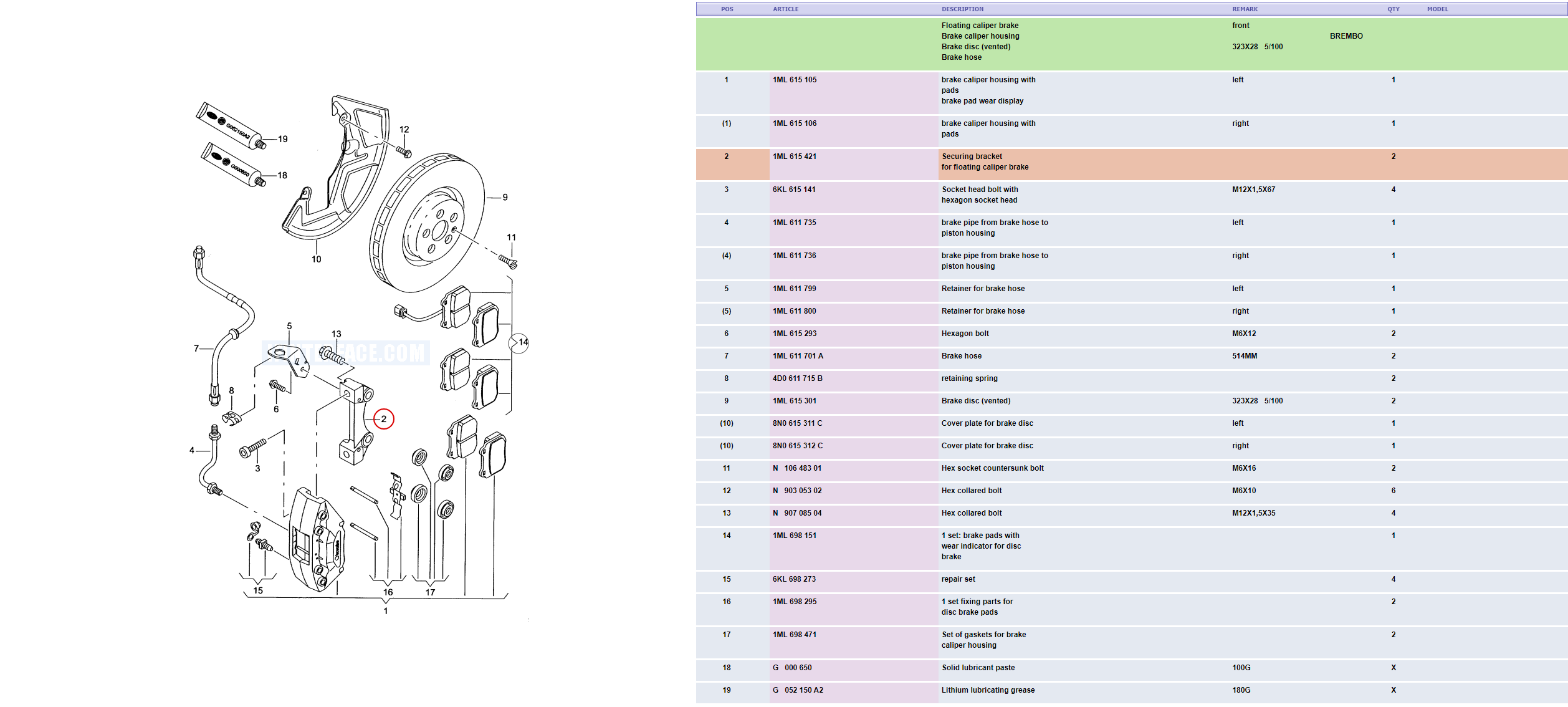

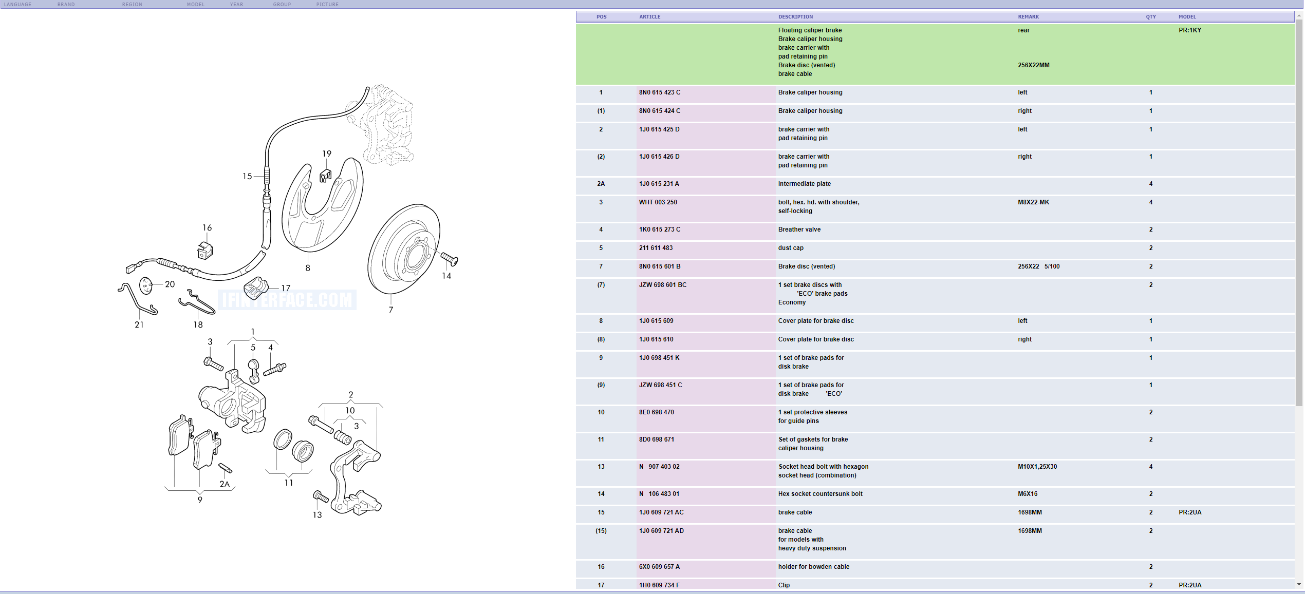

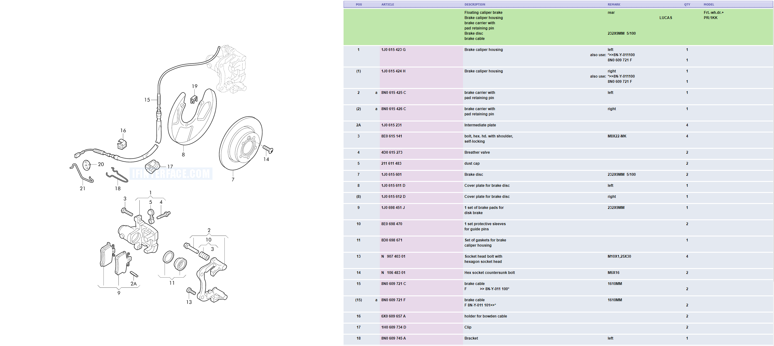

Making a post for future reference by others. I'll try and collate information about this topic taken from this and other threads regarding brake upgrades for the 6C GTi using parts from other VAG cars.
Post any corrections or extra info and I'll edit the post to add them.
Front brake conversion using mk1(1M) Seat Leon Cupra R, Brembo front brakes you need:
Calipers (left: 1ML615105) (right: 1ML615106)
Carriers (1ML615421)
Hoses
Discs and pads
15mm spacers with factory wheels
Rear vented 256mm conversion you need:
MUST BE FWD. AWD CARRIERS AND CALIPERS WILL NOT FIT
Calipers:
Seat PN:(left: 8N0615423C) (right: 8N0615424C)
Seat painted PN: (left: 1J0615423E) (right: 1J0615424E)
Audi PN: (left: 1J0615423G) (right: 1J0615424H)
Carriers:
Seat and Audi PN: (left: 8N0615425C) (right: 8N0615426C)
Seat Painted PN: (left: 1J0615425E) (right: 1J0615426E)
Discs and pads
From ( AGAIN, MUST BE FWD. AWD CARRIERS AND CALIPERS WILL NOT FIT):
Seat Leon Cupra 1M
Audi TT 8N
Skoda Octavia VRS (can someone confirm the type code?)
Golf 4 Jubilee edition (can someone confirm the type code?)
Any reasons that the part numbers differ between the Seat and Audi part for the rear caliper?
Also if anyone that has fitted either or both upgrades could comment on their experience with them in regards to sourcing parts, fitting them, and how they feel/act compared to stock that'd be great :)
Below are the sources I used and some part diagrams attached.
Not to take any credit away from those that surfaced this information, I just put what I could find together in a single post for easy reference by others.
Source(s):
The thread you're reading right now :lol:
https://www.uk-polos.net/viewtopic.php?t=77394
https://ifinterface.com/prog/car/cp2/inprog.php
