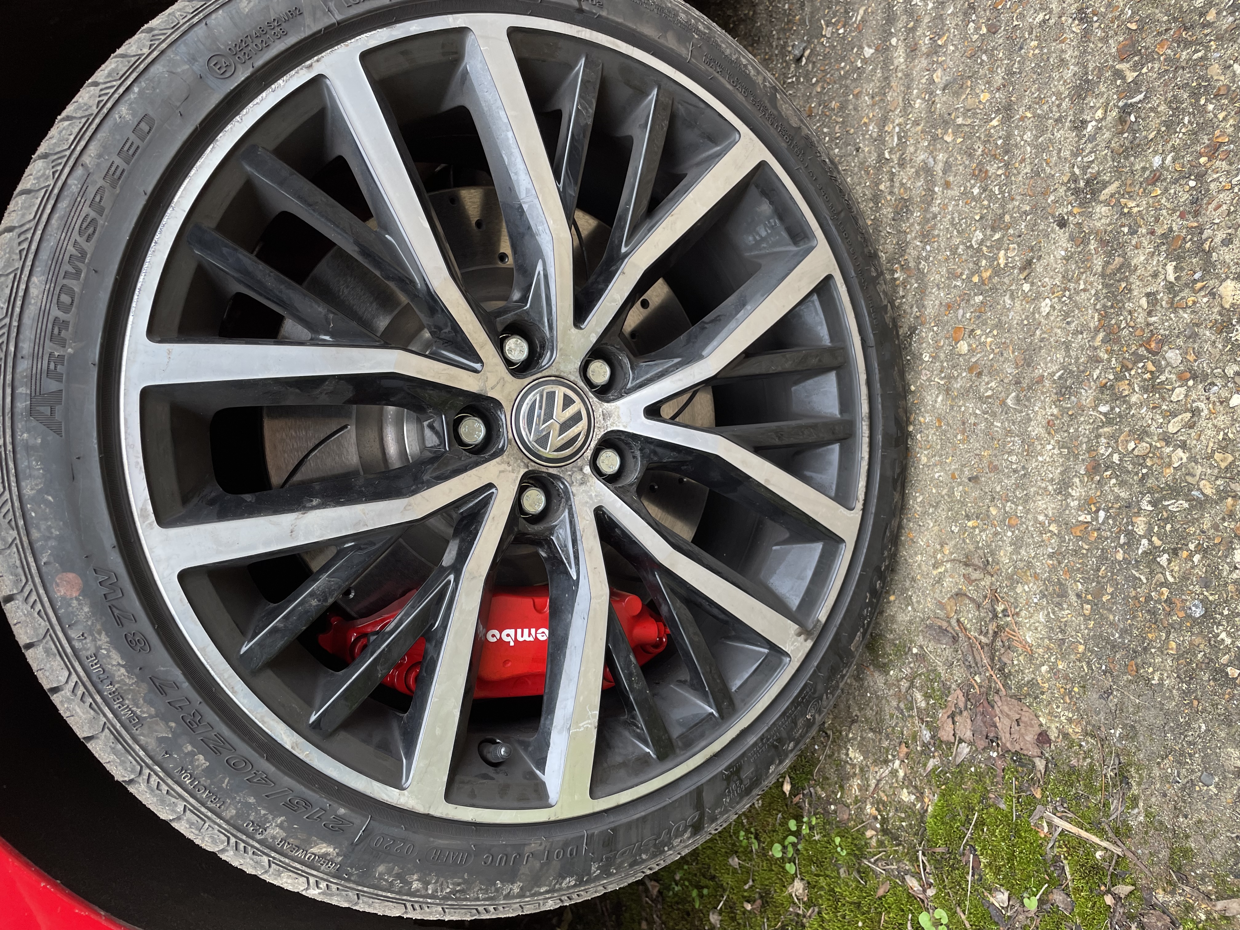

loopy257 wrote: Fri Nov 05, 2021 9:11 pm So I’ve decided to order some MK1 Cupra R Brembo front Calipers today… other than discs, pads and hose, what else will I need to get? Do the brembos fit on the same calipers mount as the stock polo?
if you get the carriers off the Cupra R they are a straight bolt on.
you will need 15mm spacers to clear the wheels ( i tried 12mm and it wasn't enough)

I don’t suppose you remember dimensions and what ends you have on your custom brake hose?

it's something like a M10 male thread. I got them from HEL and just explained what i needed and they turned up

Got everything sorted now, only thing I’m wondering I might have missed is the bolts that mount the carriers to the wheel hub. Do you know if you used the stock polo bolts or did you use Cupra R bolts?

stock polo bolts work perfectly

Thanks so much for your advice mate.
All fitted and working perfectly.
Polo Brembos
Polo Brembos
