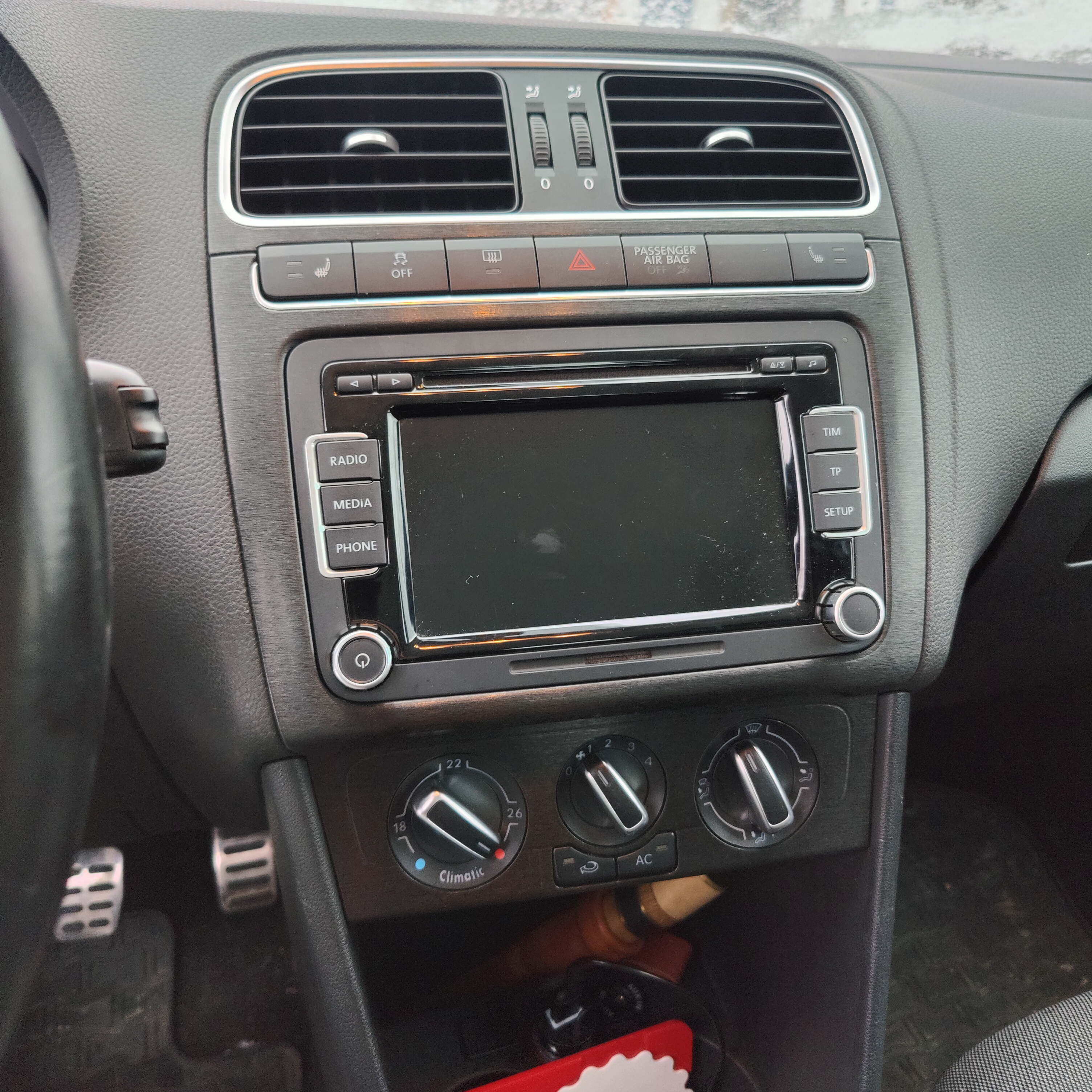

My latest mod on the car. So glad to finally upgrade these interior trims. The OEM matt look was so boring and hurting eyes.
My other car is Octavia IV Style so each time I drive Polo I really want to improve it as the difference has been so big, but Polo has been steadily improving. Octavia is bit boring as there is not much to mod, but maybe with new models there will be something new that can be retrofitted on it :D
Here's the wrap. Disassembled everything in cold and dark winter weather, that was not too nice but when I finally got inside and started wrapping these that was fun.
Re: Toymachine1' Polo 6R Comfortline 1.2 TSI
That's really nicely done, looks OEM.

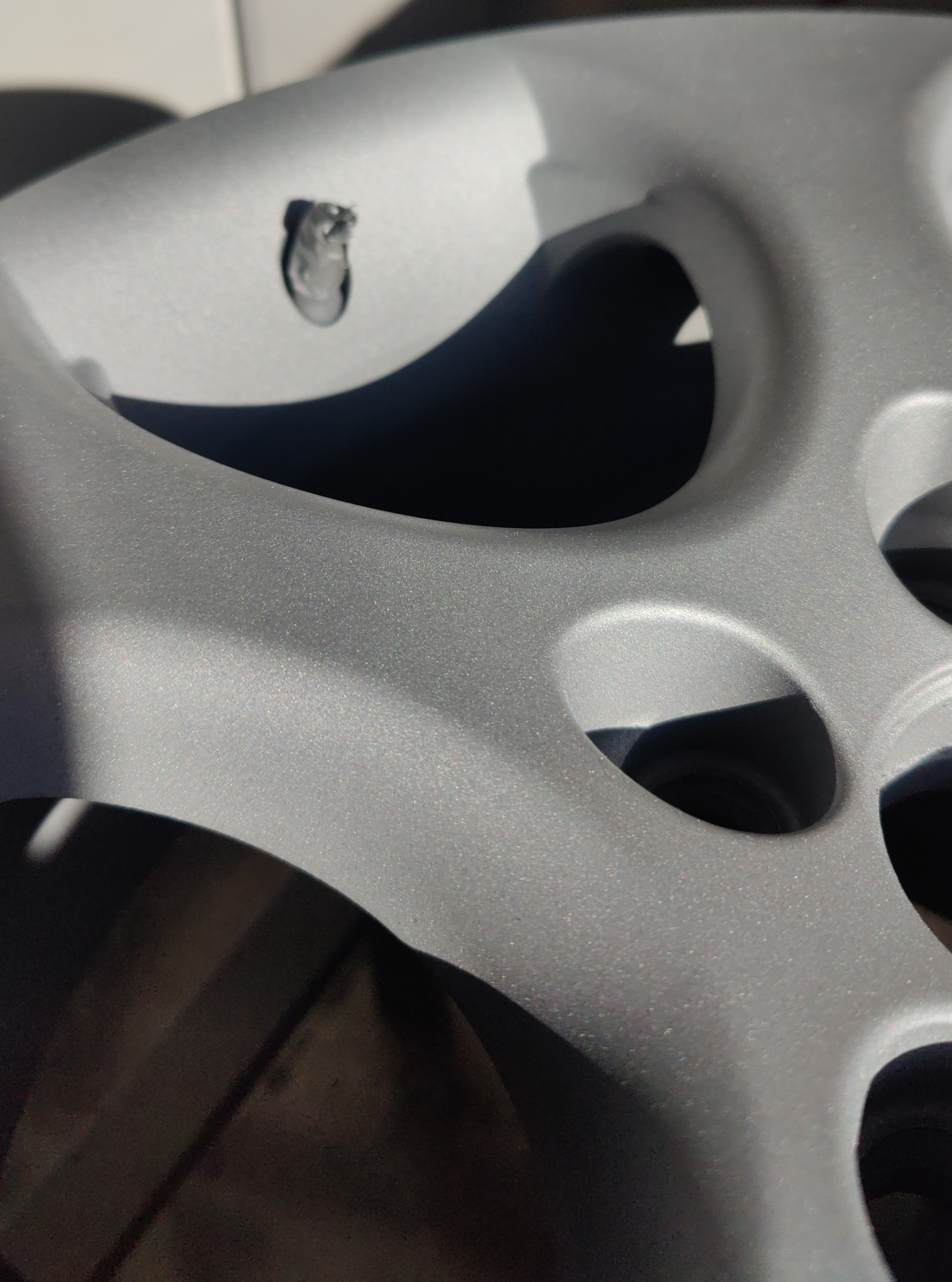

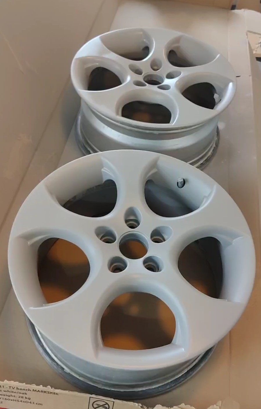

I purchased 16" Denvers that were in very bad condition. They are straight but had lots of curb rash and overall looking bad. Reconditioning them completely, will be fun to install them to the car when summer comes.
After primer
Final surface

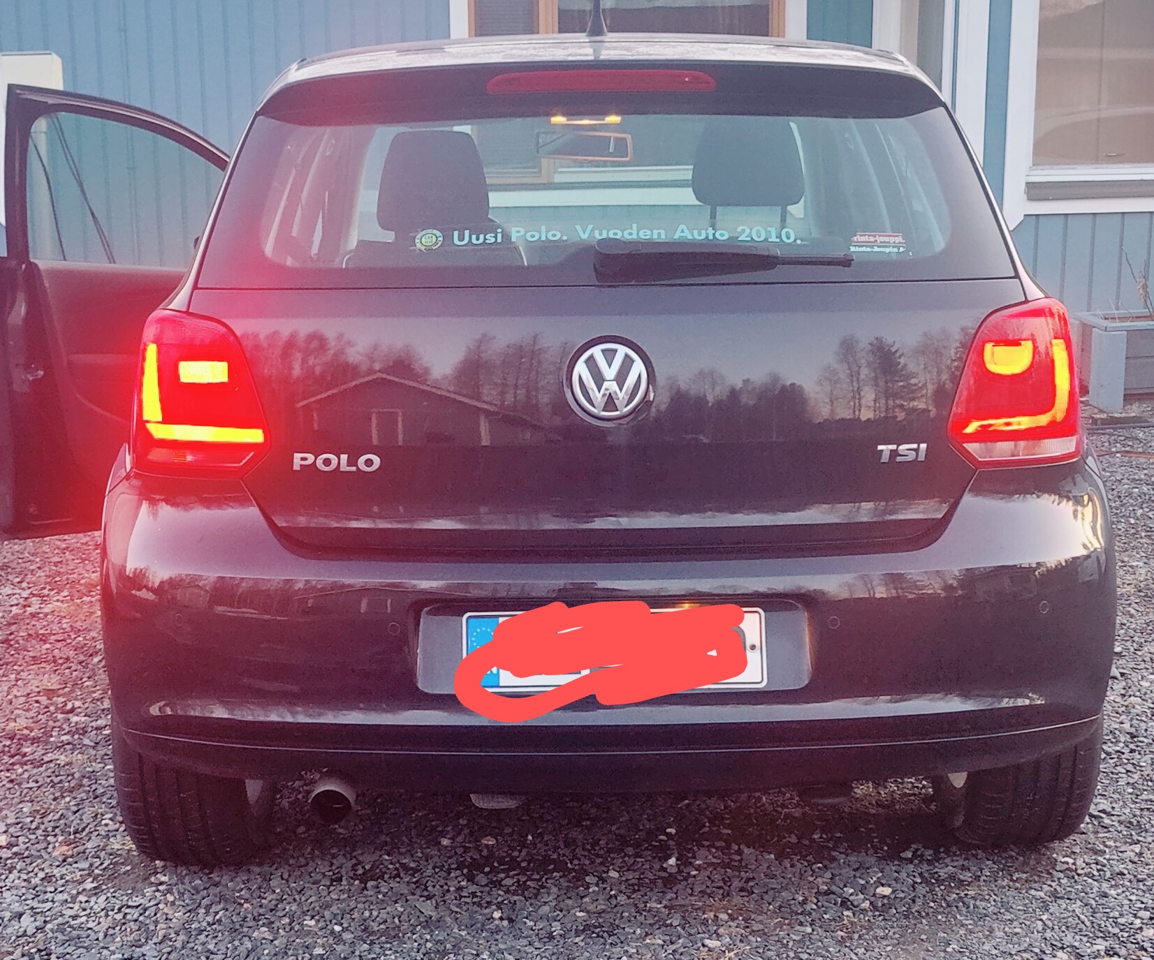

OMG this 6C taillight retrofit is a must do for all 6R drivers!
The left one is the 6C tinted version. Right side is the original 6R version.
I was lazy and just cut my original wires and soldered in the 6C suitable connectors. One connector I got with the other taillight and one I ordered from Allegro. Also before installing these new taillights I installed all new bulbs.
