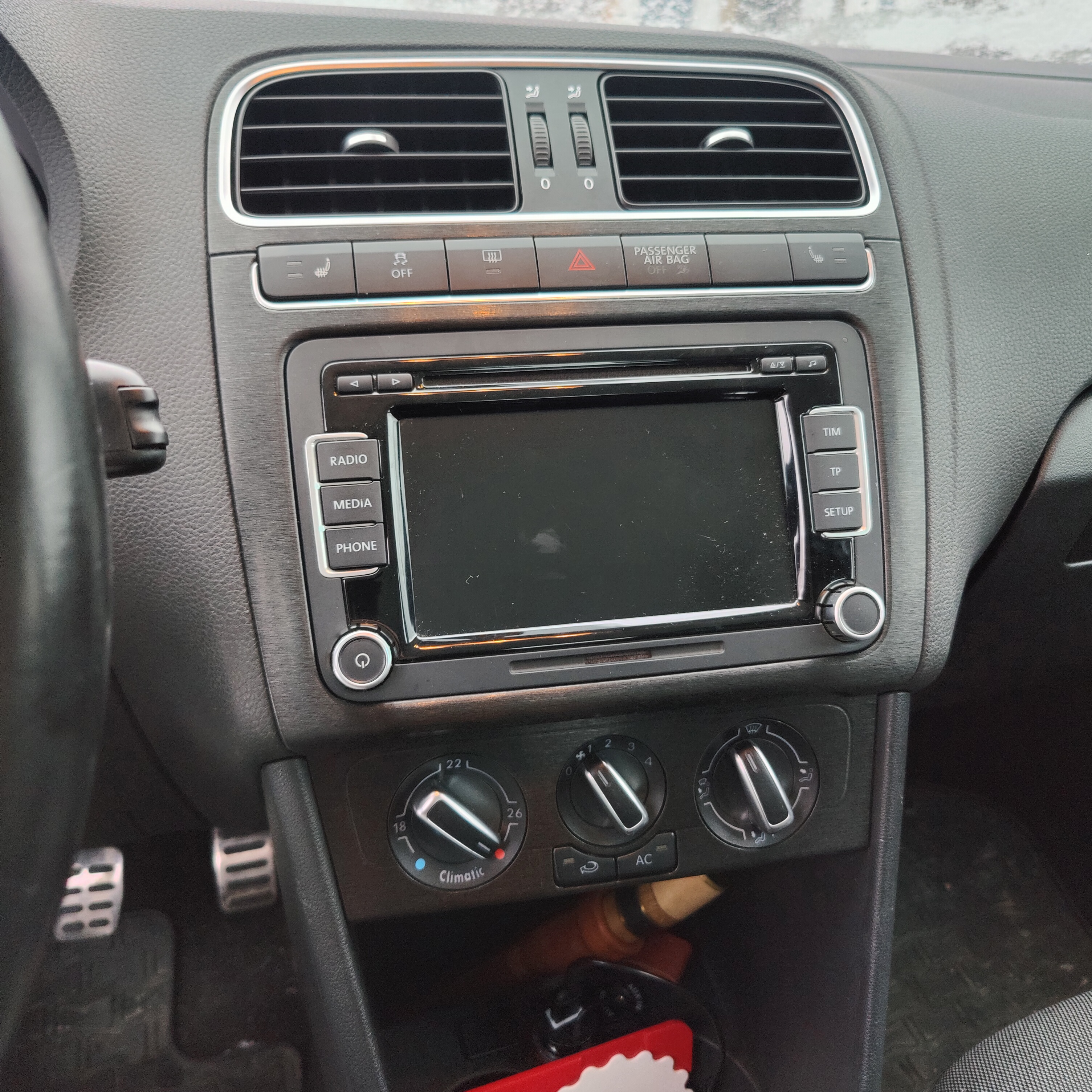

Had a day off today so went ahead and installed the Passat 3C8 MFSW. Works very good as you said Iichel. Thank you.
Now able to use all menu's of the MFD+, and successfully paired my phone. So glad to have Bluetooth back, but now better than ever because of the MFSW buttons.
Telephone book still gets scrambled with RCD-510, although I now have the latest firmware installed. Also no song titles are still being displayed, so not fully satisfied. Probably need to install RNS-510 at some point. Then I can have Navi and RVC retrofitted also.

Upgraded RCD 510 to better version, Bosch 3C8035190C. Very cheap find. This one shows song titles and since I have MFD+ I can now see song names there, so browsing through music from Bluetooth is pretty seamless now with multi function steering wheel.
The screen is much more brighter and sharper and the theme has slightly better look than the older unit.

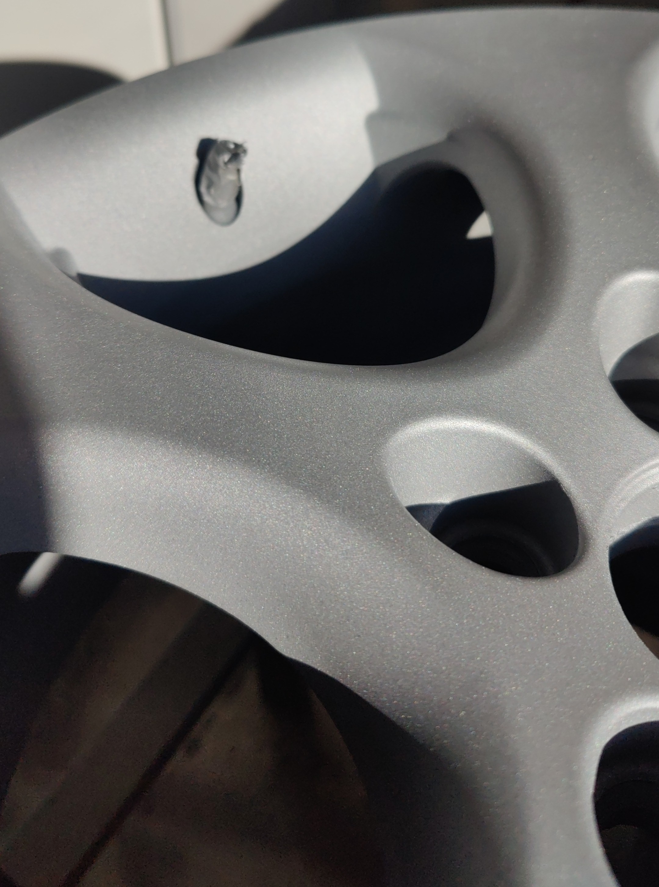

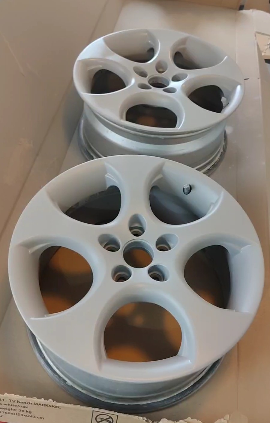

I purchased 16" Denvers that were in very bad condition. They are straight but had lots of curb rash and overall looking bad. Reconditioning them completely, will be fun to install them to the car when summer comes.
After primer
Final surface

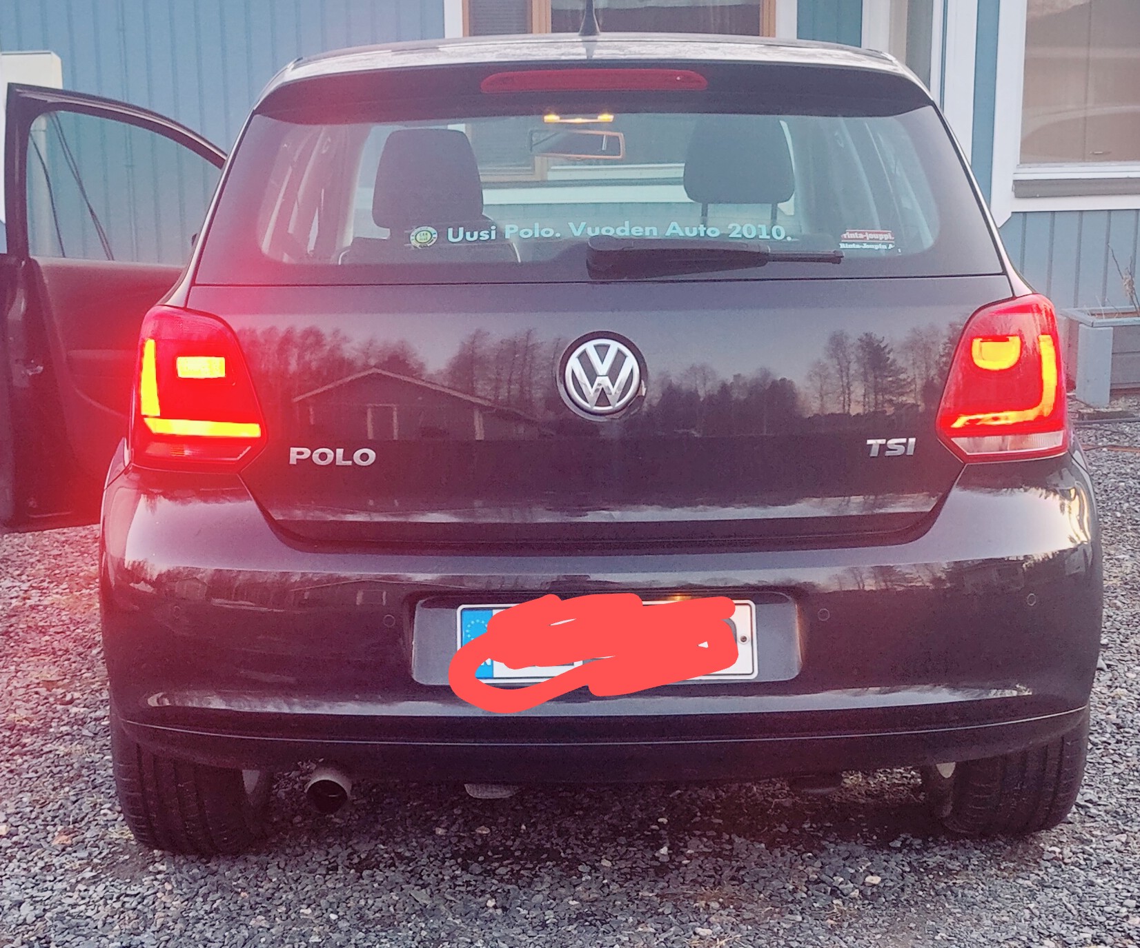

Also ordered 6C rear lights with the tint (M revision). Looking forward to install these. Still need to build the adapter/wiring in order to fit them to the car.

OMG this 6C taillight retrofit is a must do for all 6R drivers!
The left one is the 6C tinted version. Right side is the original 6R version.
I was lazy and just cut my original wires and soldered in the 6C suitable connectors. One connector I got with the other taillight and one I ordered from Allegro. Also before installing these new taillights I installed all new bulbs.
