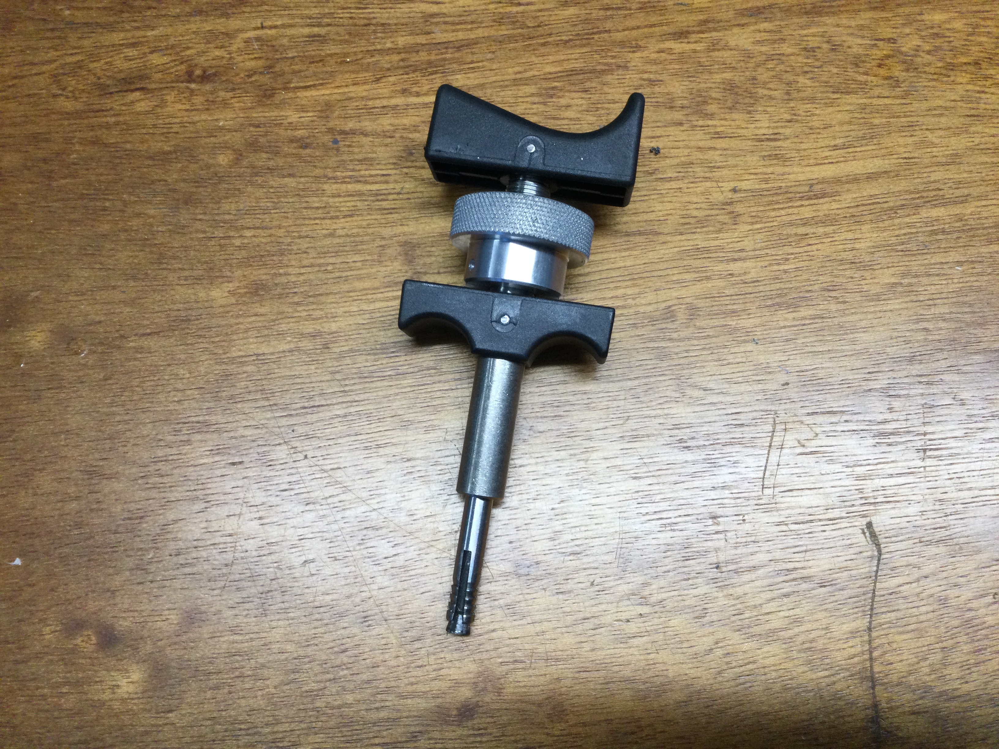

Regarding purchasing the the coil pack removal tool from China, here's a picture of the one I bought. Cost about a tenner all in. Works just fine. My only criticism is that the thread in the large knurled nut is a bit sloppy, but then I am rather fussy!
Re: 1.2TSI Spark Plugs: Iridium or Platinum?
Posted: Fri Feb 03, 2023 10:53 am
by RUM4MO
So even that copy one has been evolved to include ribs/ridges on the "expander" end.
I just hope my older version, which again is a copy of the real thing, will still grip the coil pack well enough - time will tell!
Mind you that BGS 9094 does look impressive, but I'd need to buy a display box for it and mount it on the garage wall - or even in the house, well maybe not!
Edit:- maybe apply some grease onto the area that the nut ends up running over because if that nut is just alloy, is its thread is slightly floppy/rough, then it will get worn down by the steel thread on the tapered wedge pin.
Second Edit:- corrected the BGS tool number to 9094.
