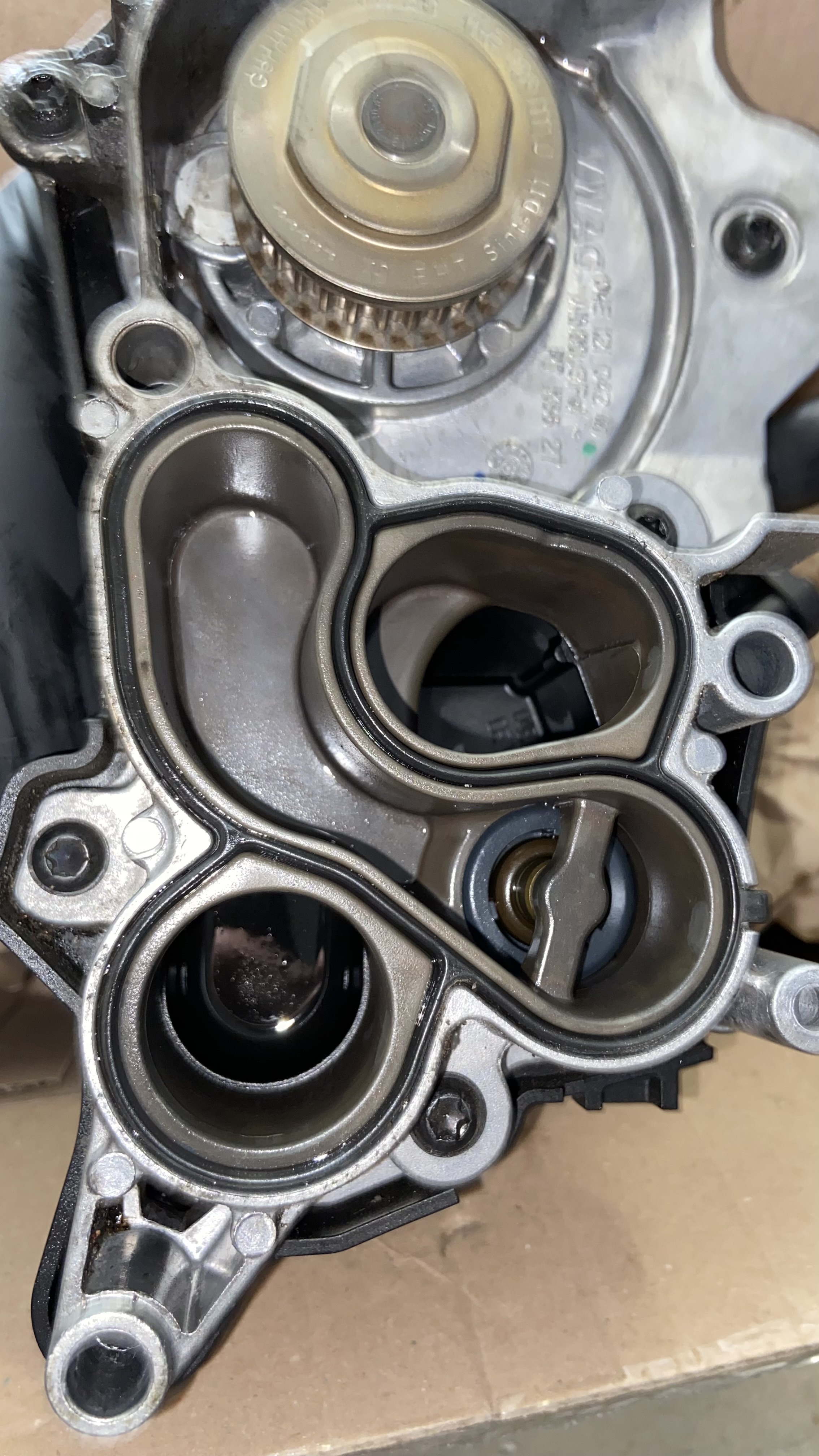

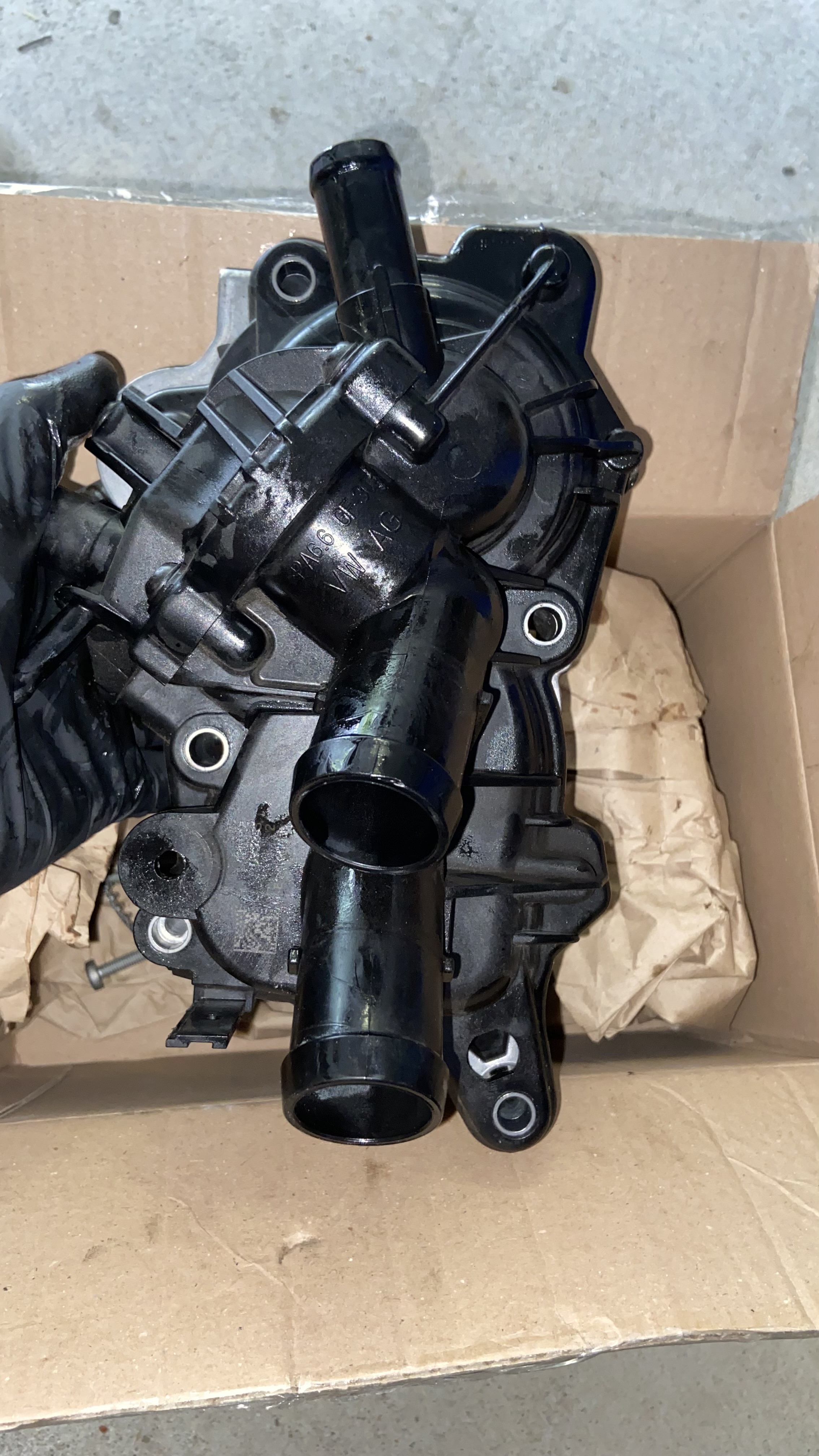

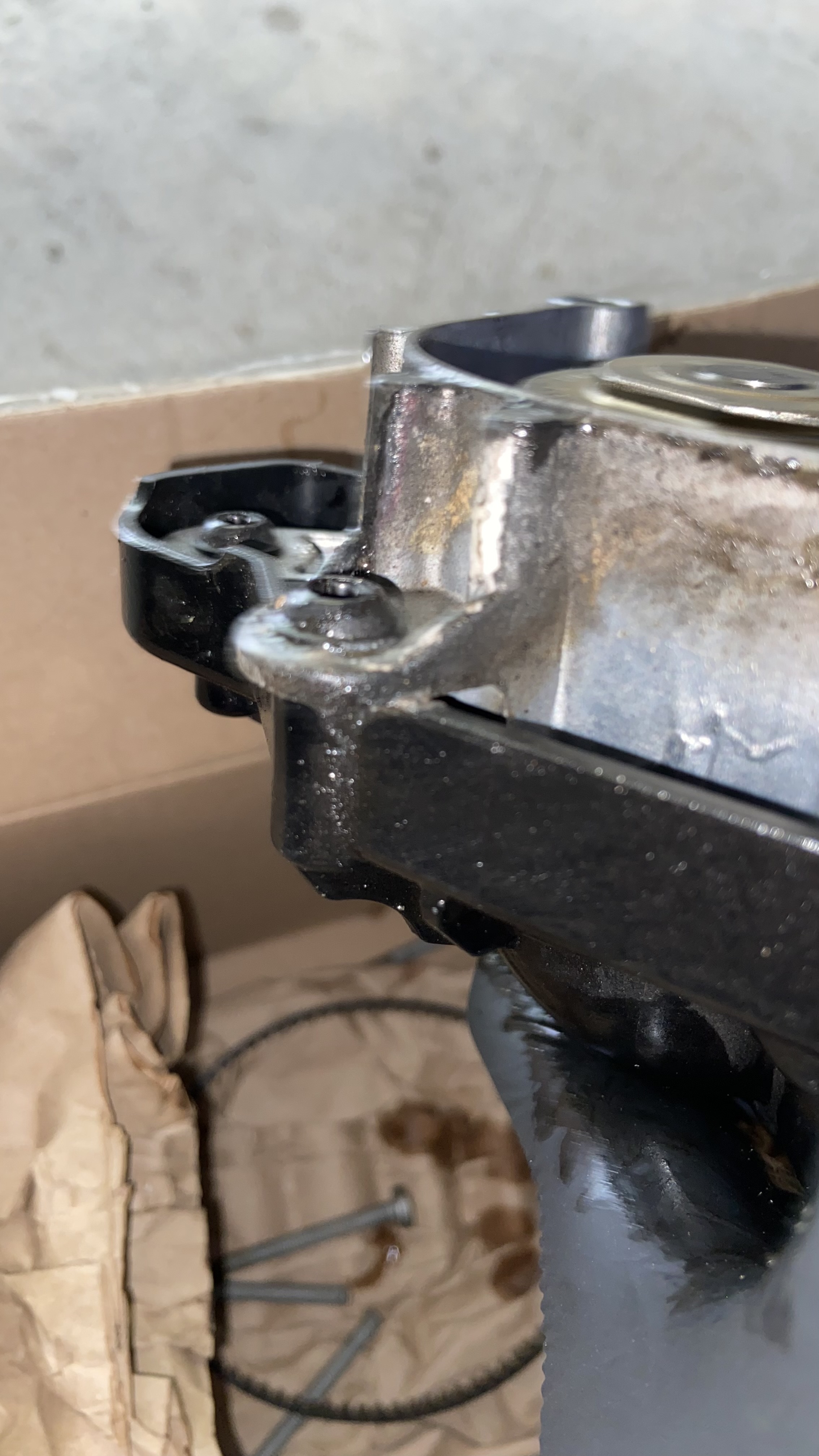

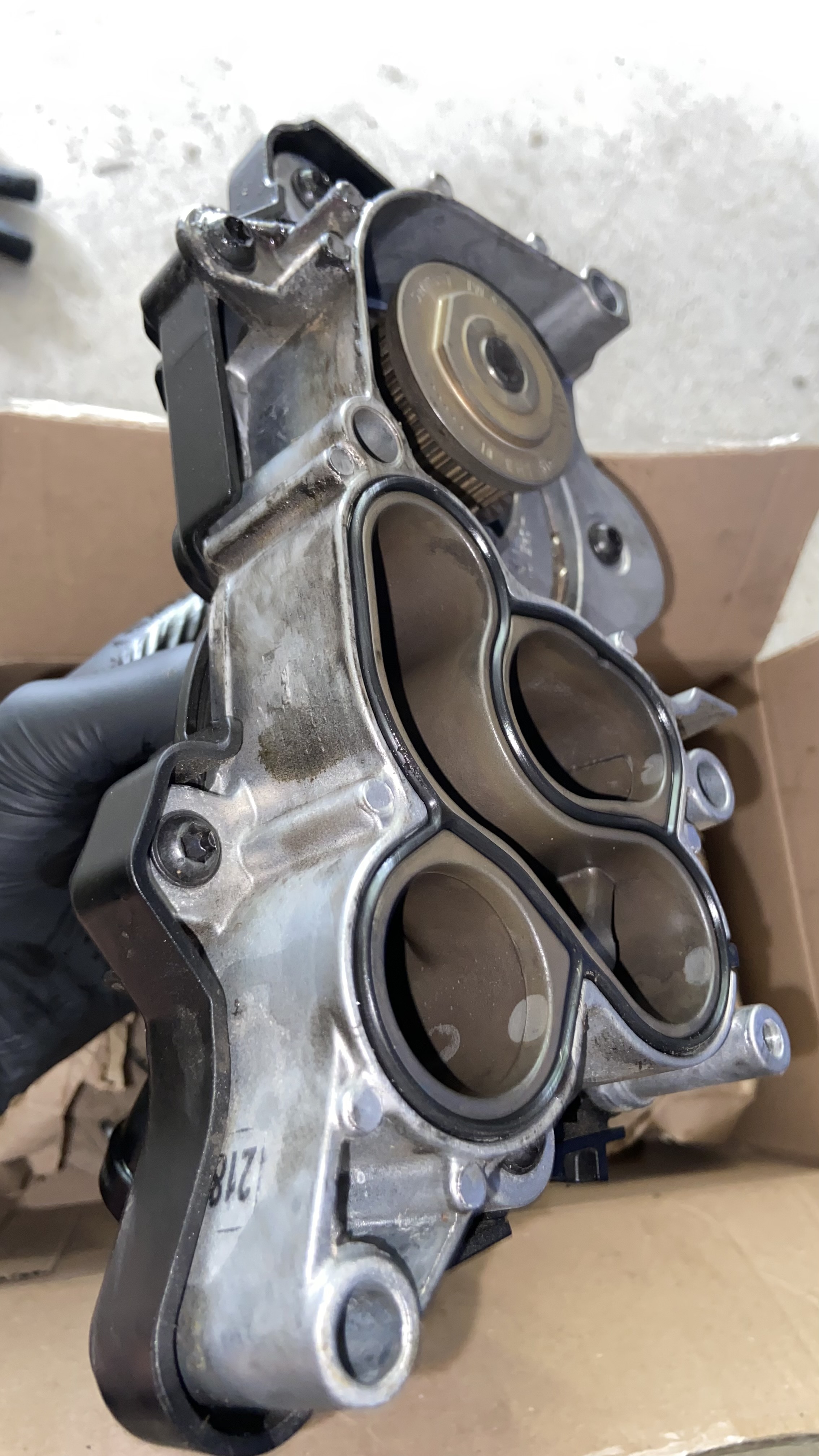

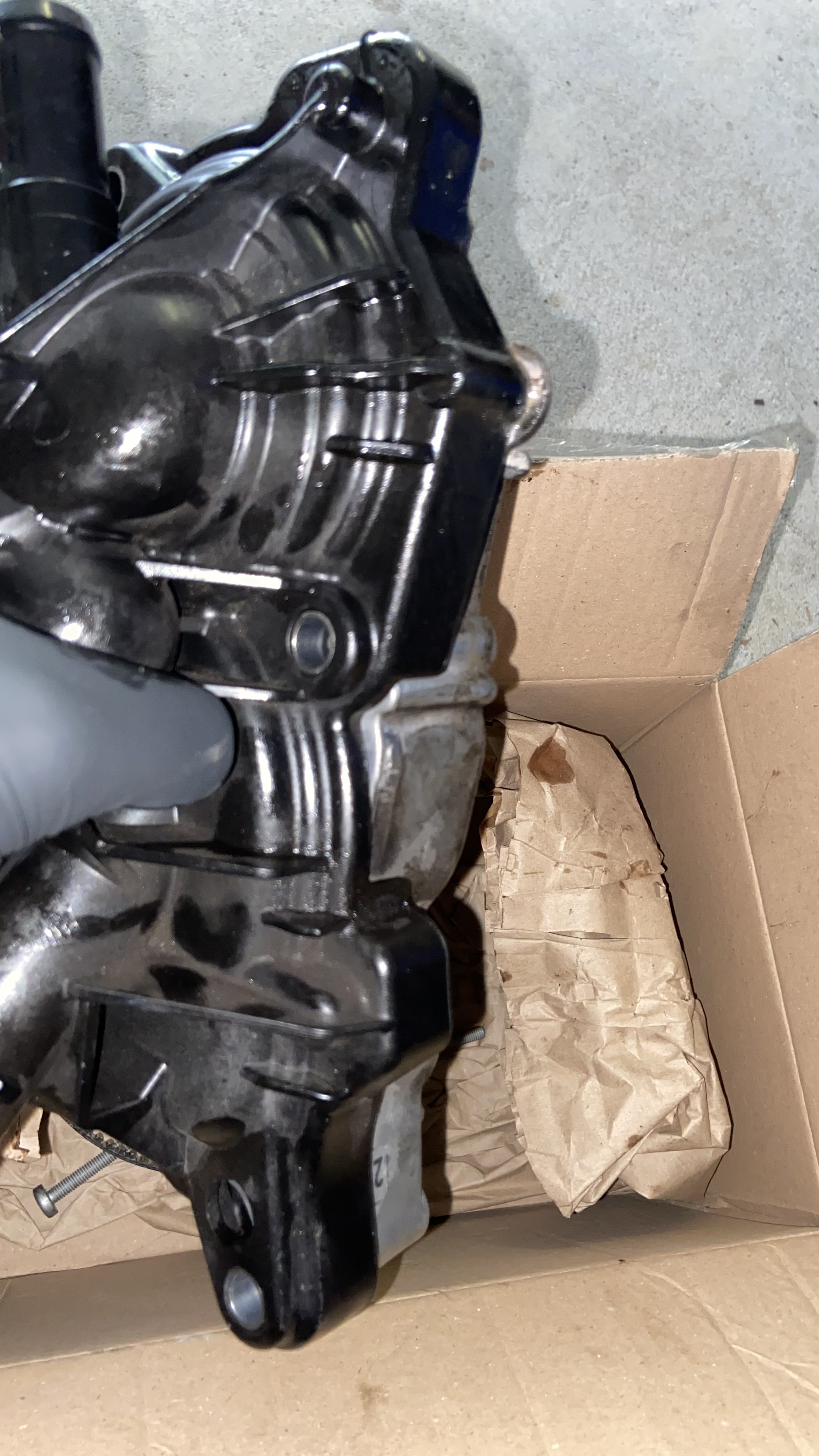

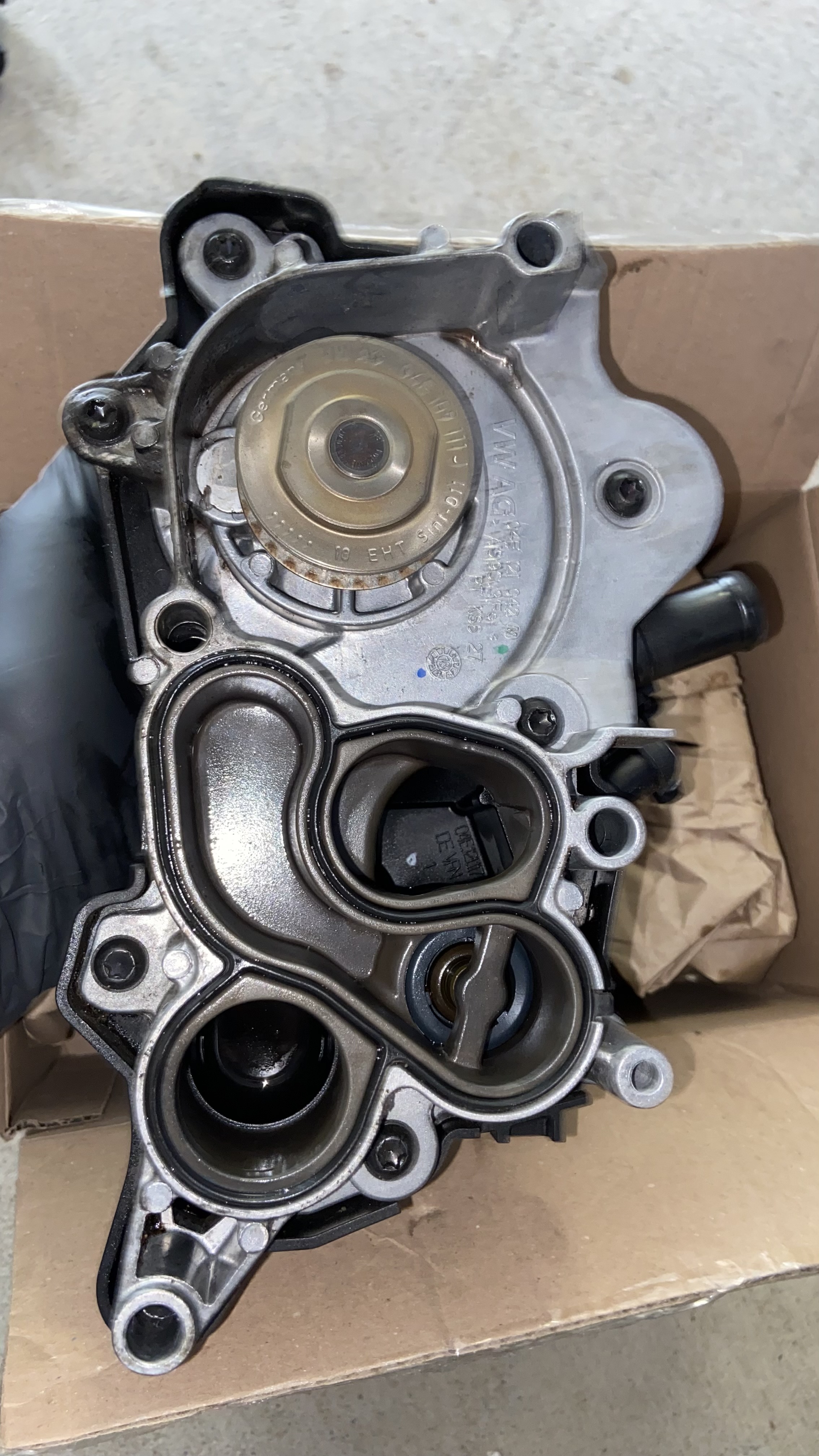

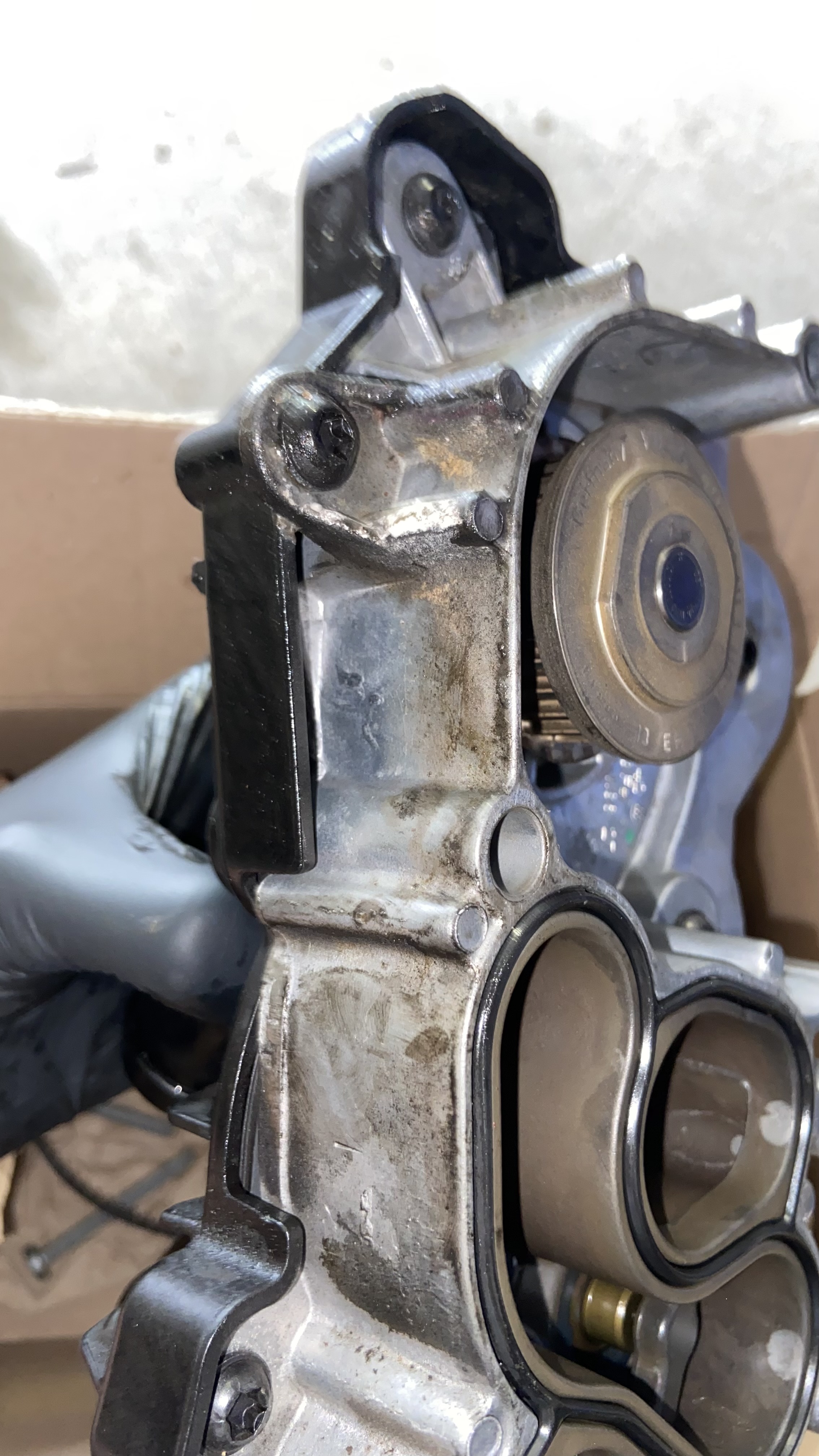

Water pump was swapped today. All went well and the car is working fine. I have approximately (by eye) just over 2L of coolant left over… so it took just under in 8L (but don’t quote me on that I could have the measurement off). I would definitely recommend to someone to buy 2x 5L containers of coolant, it works well.
See the attached photos of the old water pump.

Thanks for the images, it is the usual leak, fortunately detected in time.
Everything should be fine with the new pump and coolant.

No worries! Can you provide any insight as to what exactly might have failed in my pump? I couldn’t identify the failure looking at it briefly. Perhaps part of the plastic assembly cracked.

There should be no coolant where the water pump pulley is located, so the leak originates from the seal between the pump pulley and the pump.
