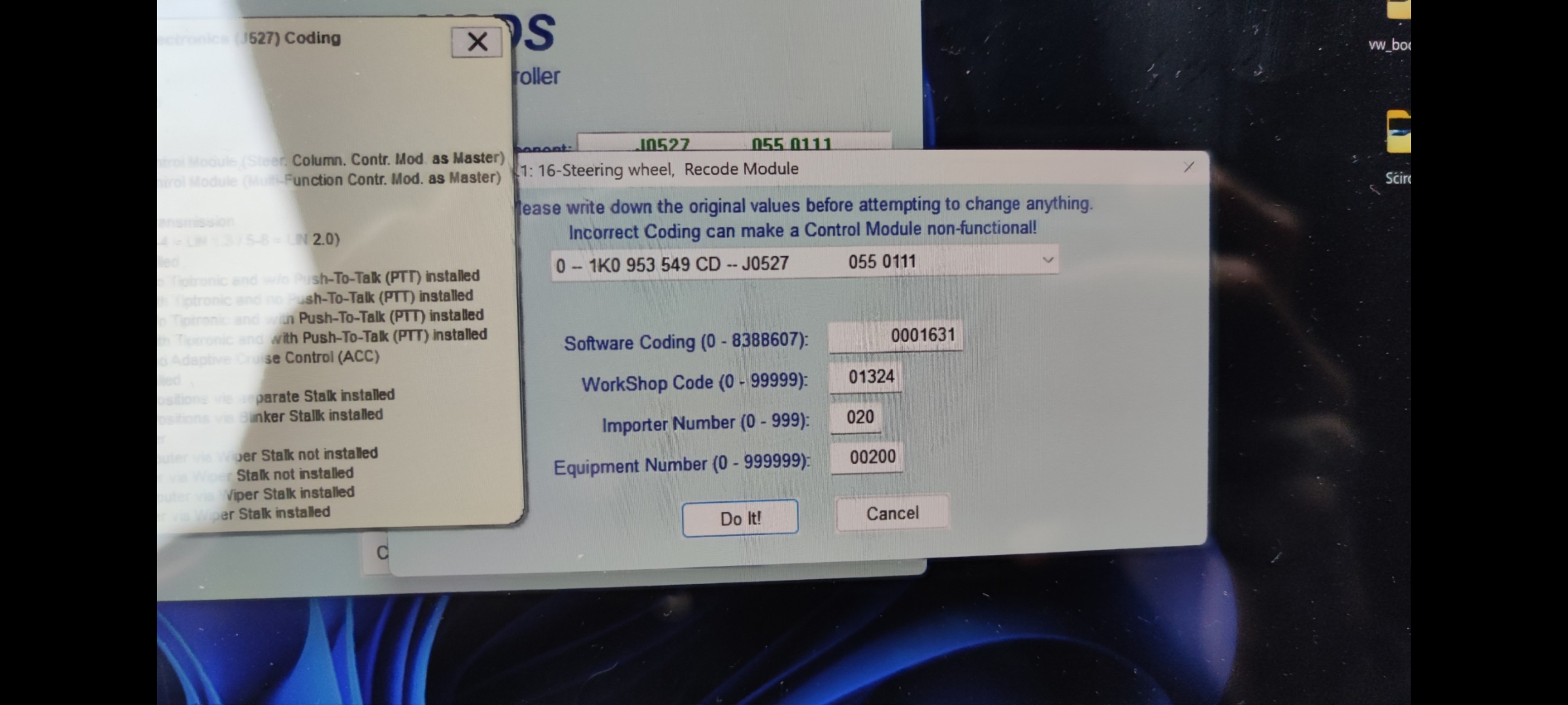

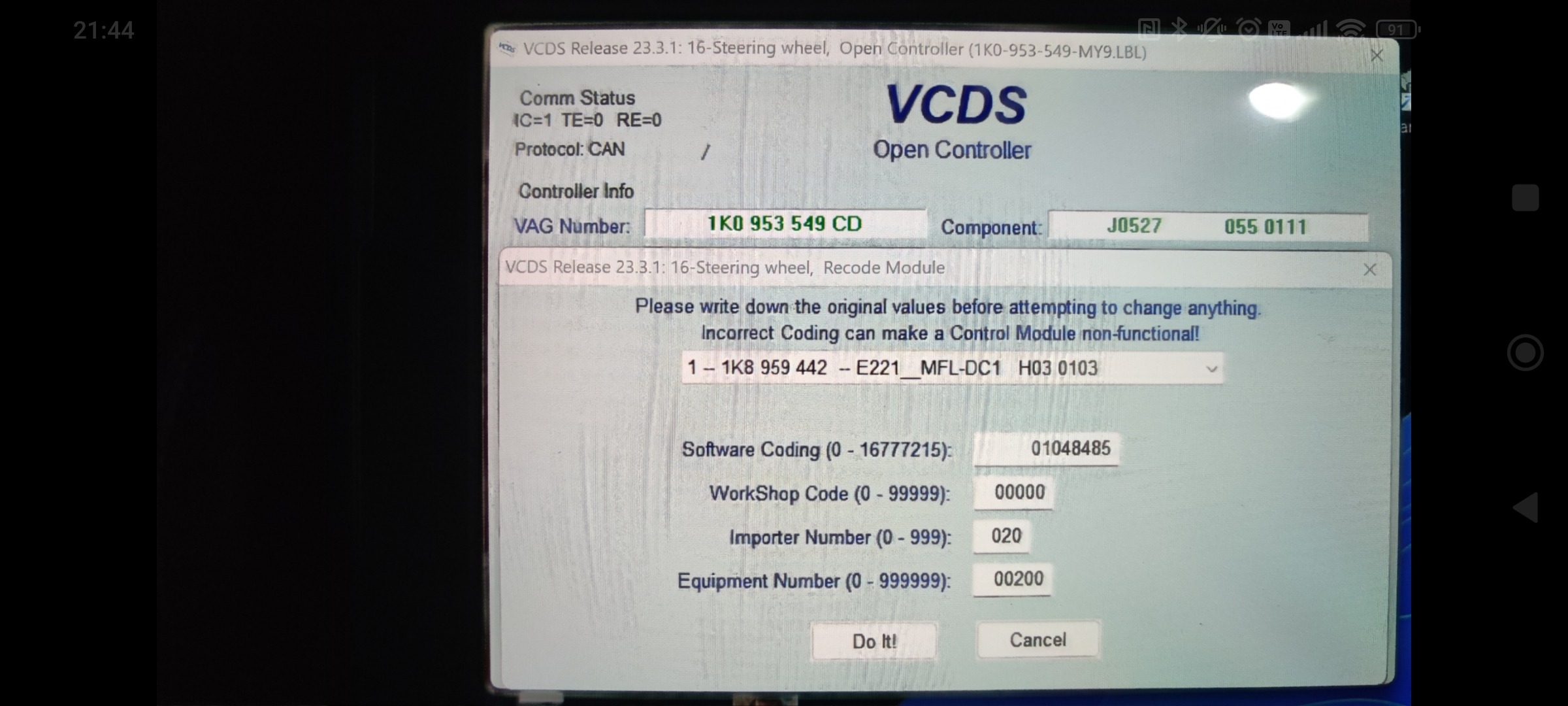

I don't have advanced coding for MFSW
- Screenshot_2023-10-15-21-44-58-770_com.google.android.apps.photos.jpg (1.04 MiB) Viewed 6054 times
- Screenshot_2023-10-15-20-38-41-741_com.google.android.apps.photos.jpg (881.68 KiB) Viewed 6071 times

I had BH module for SW but it was also for simple coding. Had to replace it with CD because of LIN2.0 support (I had golf V MFSW originally)

Button coding J453 (1K8 959 442).
On our 6R 'PQ'25 this is the coding for those buttons. (LIN ---> BCM) https://www.uk-polos.net/viewtopic.php?p=498666#p498666
Subsystem 7 - Part No SW: 1K8 959 442 HW: 1K8 959 442
Component: E221__MFL-DC1 H03 0103
Serial number: 27140003142720054516
Coding: A4FFFF
A5FFFF (with DSG)
I'm wondering if coding your multifunction steering wheel on another PQ vehicle with this coding and supporting the UDS protocol (or on a test bench) and then installing it on your Scirocco would make the horn work through your J527 with blue/white wire connected to T5/4.
Something similar must be done with the buttons of the latest platforms (touch or normal MQB buttons) so that they work on previous platforms.
(in addition to other modifications, -emulator for CCS + wire/BCM coding for the horn-)
I coded some of them on my Golf7.5 and others on my test bench and then installed them on my 6R, which due to the CCS emulator the buttons/coding are not visible in the Autoscan.
Example --> viewtopic.php?p=595902#p595902 everything works! (all buttons, horn, CCS MFSW). Previously
