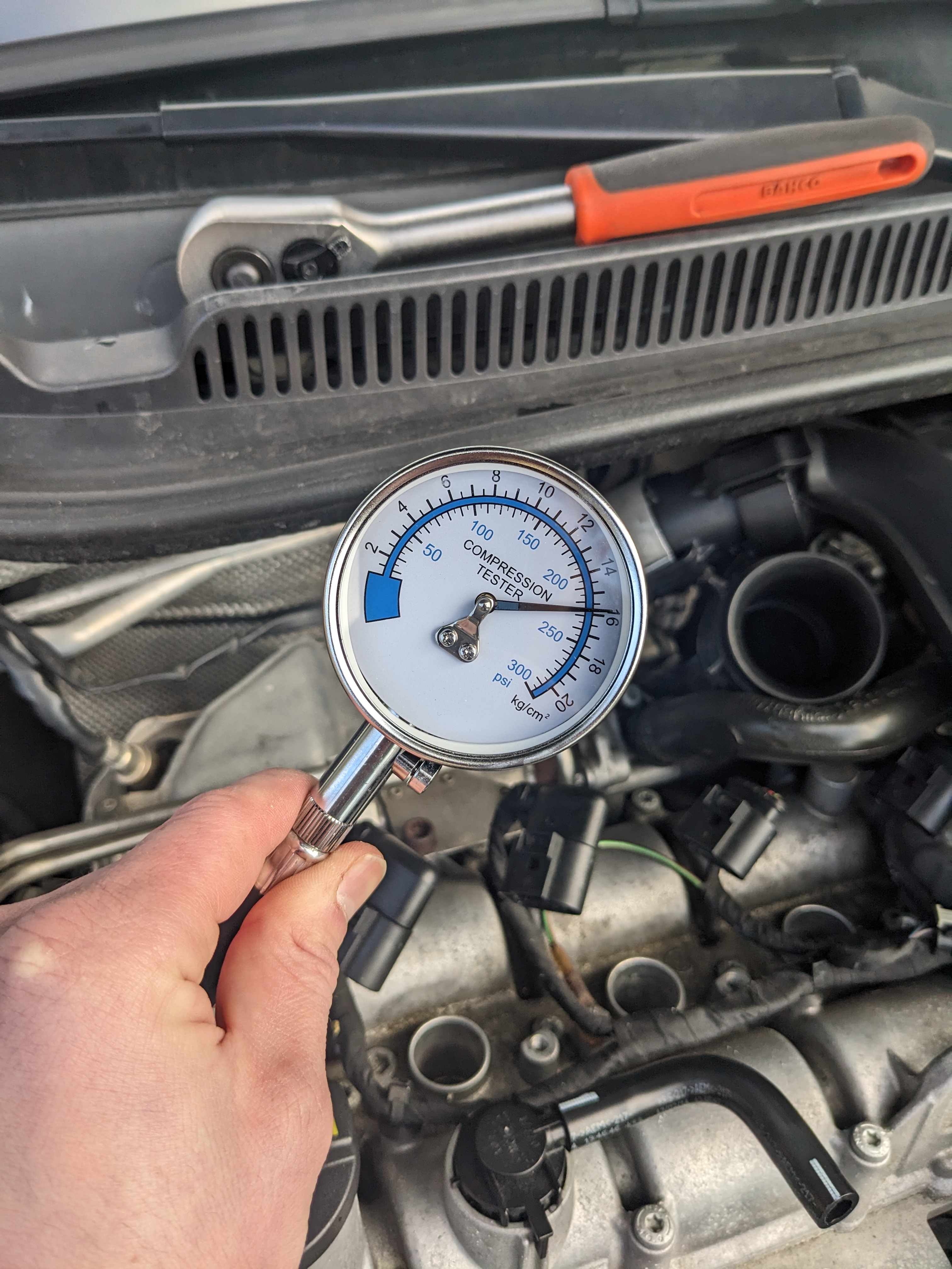

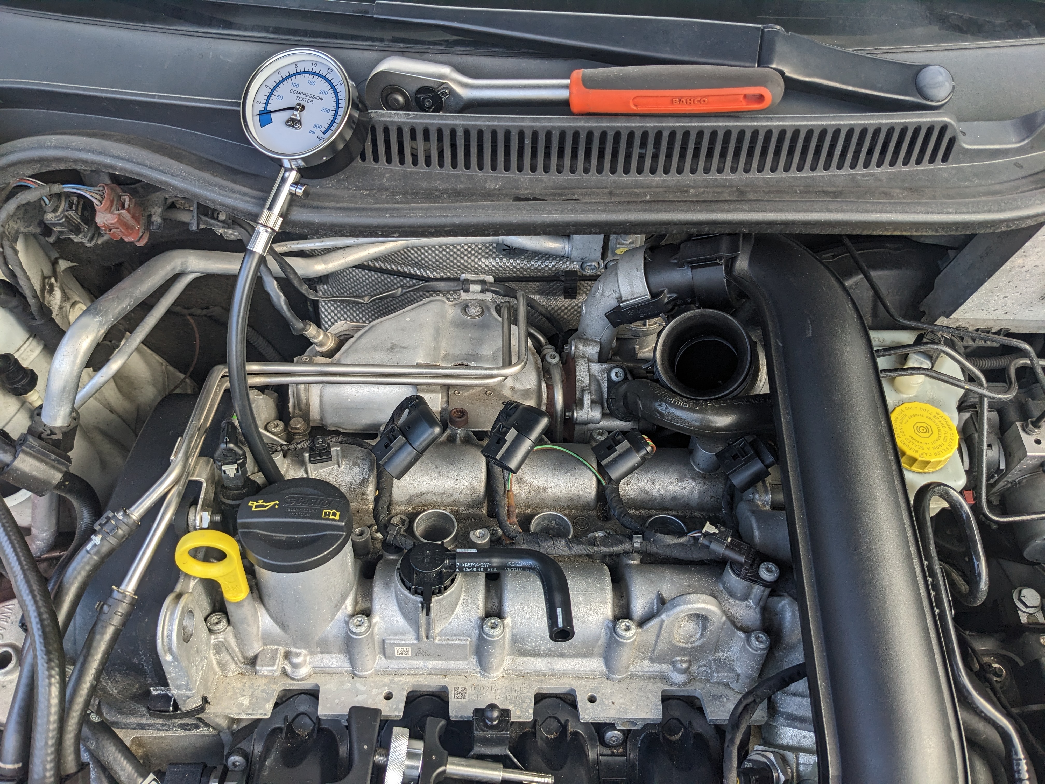

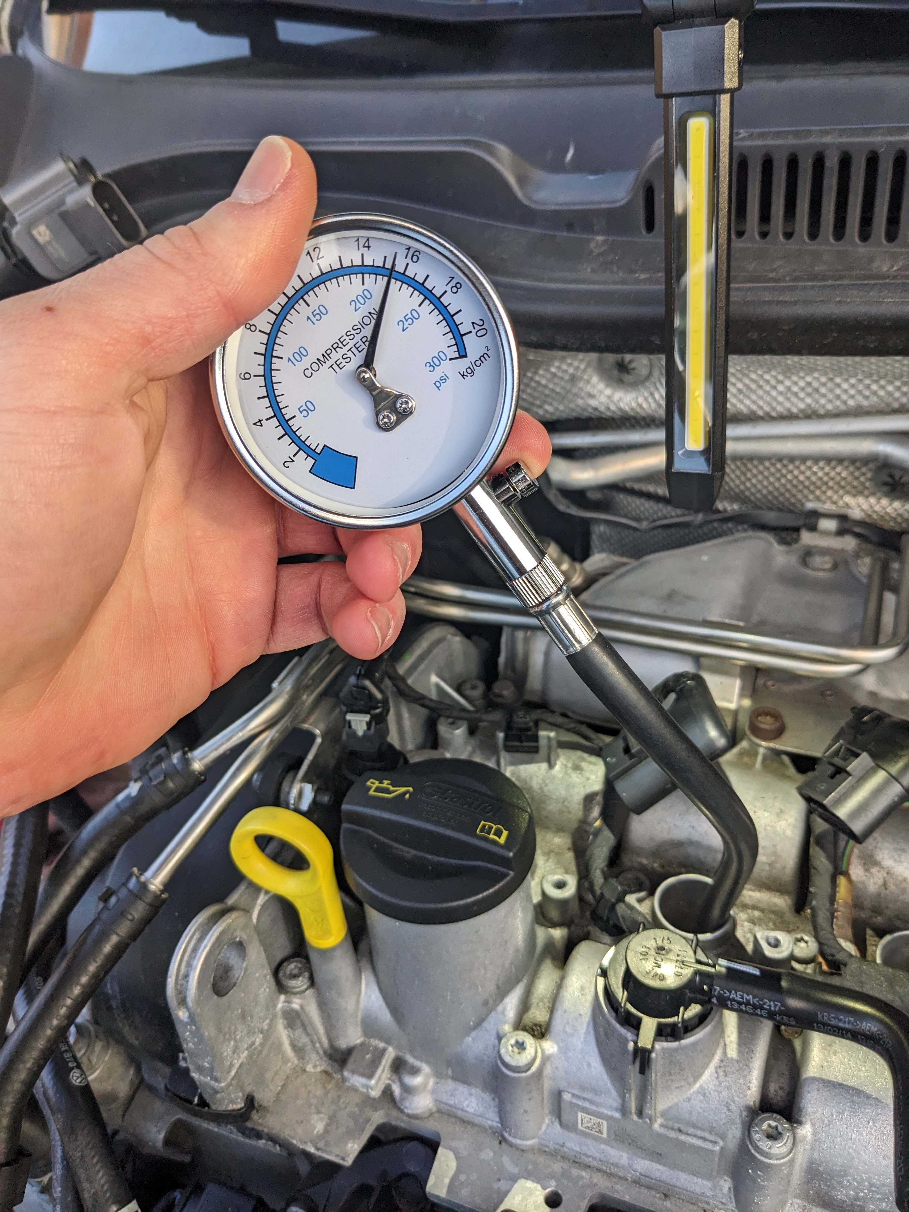

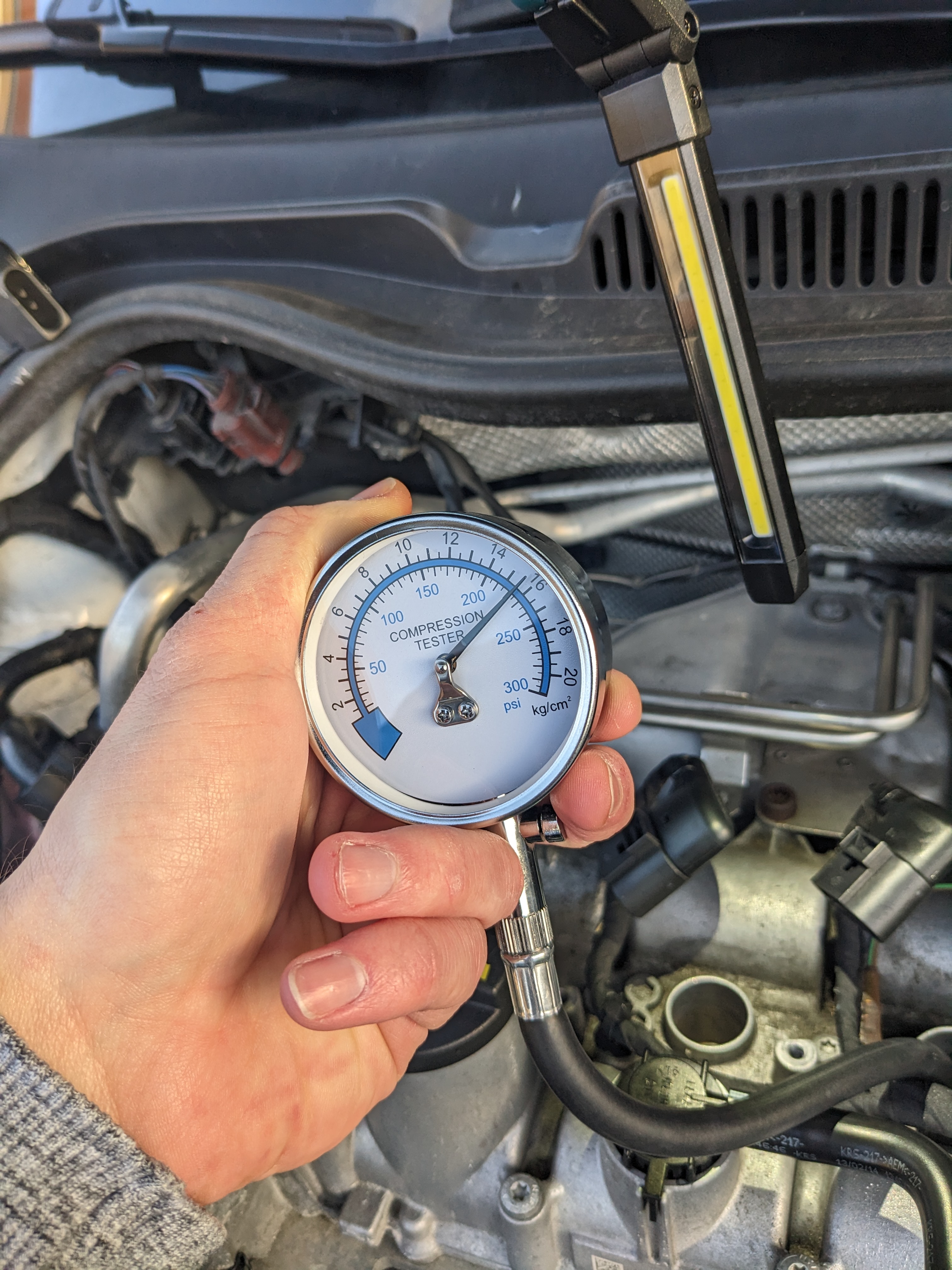

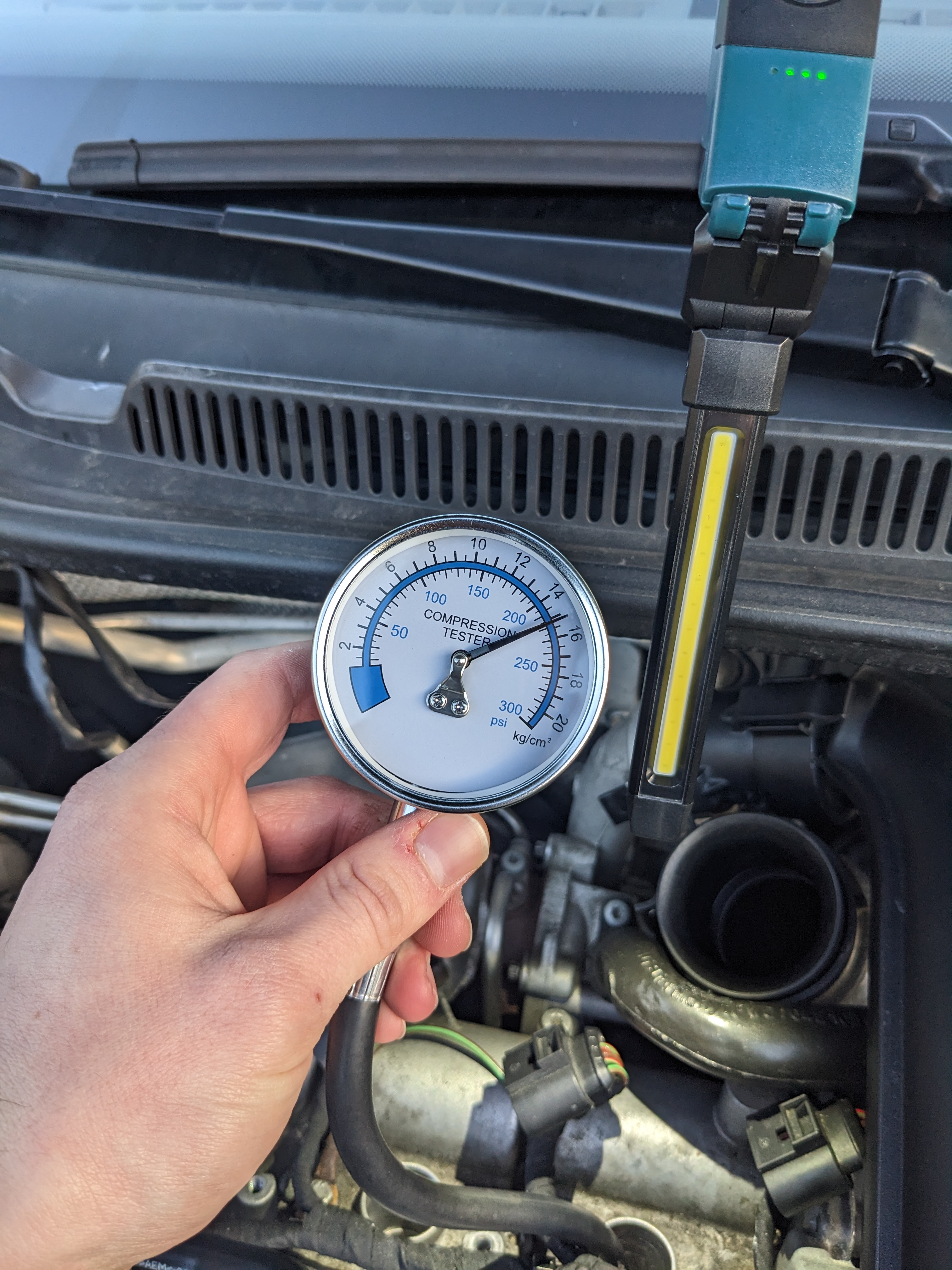

The doc requires the battery to be above 12V and the oil above 30°C. At that point I must have been around 80-85.
We dismantle everything: filter, coils, spark plugs and off we go:
Cylinder 1:
About 15.5 kg/cm2 or 15.2 Bar.
Cylinder 2:
Approximately 15.3 kg/cm² or 15 bar.
Cylinder 3:
15.5 kg/cm² like cylinder 1.
Cylinder 4:
15.2 kg/cm² or 14.906 bar
! WARNING!
The pressure gauge has not been calibrated by me, so the values may be wrong (optimistic or pessimistic: your choice :Red: )
I'm going to choose to be optimistic :lol!
Note that I did two tests per cylinder. Each time the results were identical.

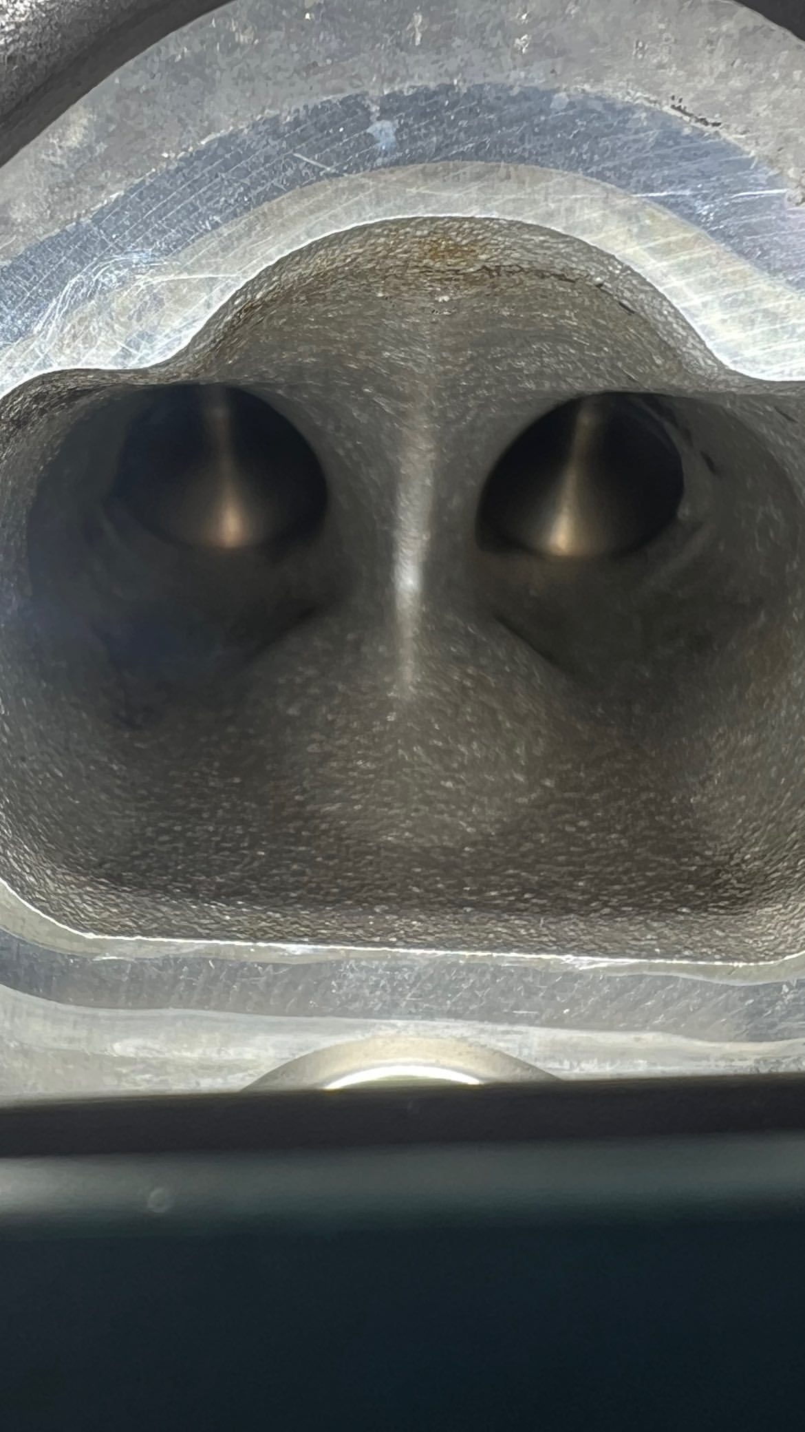

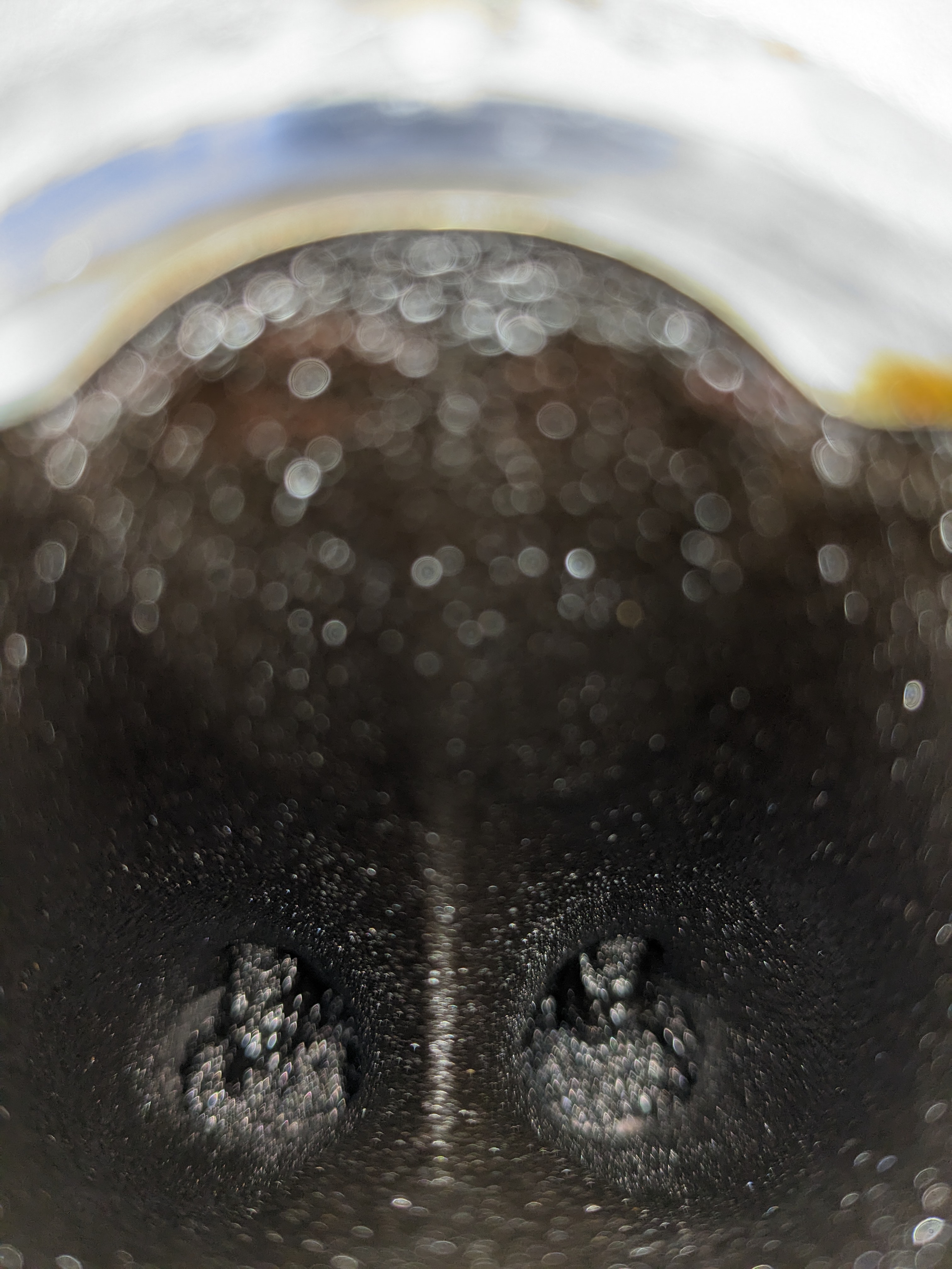

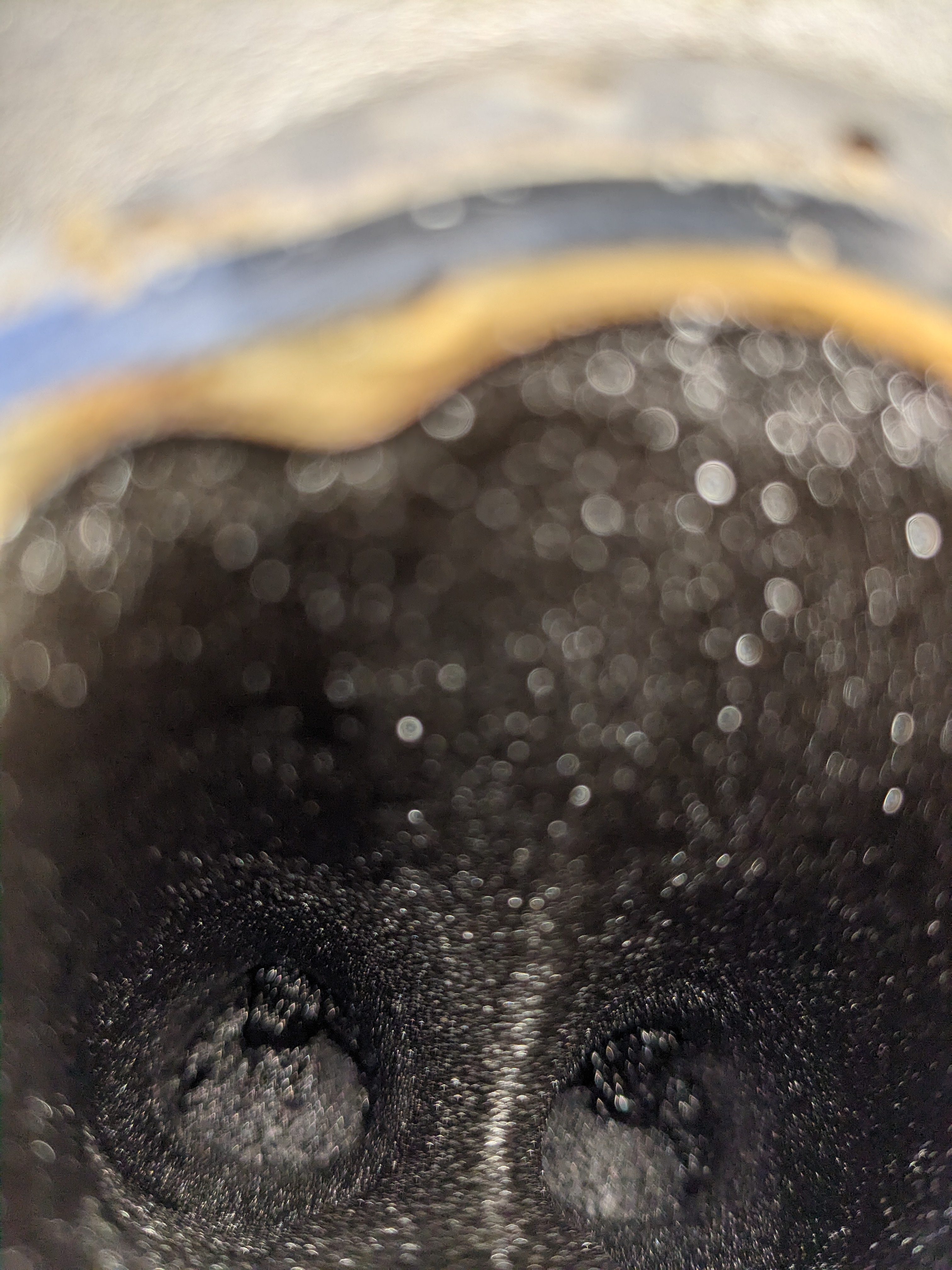

I think I found the issue:...
Cylinder 1 and 2.
3 and 4 are the same.
PXL_20240213_101953006 (1).jpg (2.43 MiB) Viewed 9145 times
I take an appointment to clean my valve with dry ice.
And I will add a catch can because it's a mess. Do you know why kind of/model I could buy ?
Posts: 6093
Re: Cold weather, engine runing rough
Not walnut shell blasting?
What is the current Kms this car/engine has run from new?
I don't know which catch tank works best.
Edit:- you will be able to check that the HP fuel rail fixing bolts are torqued up correctly as that was a possible issue with this engine from new, plus you should buy new inlet gaskets.
Edit:- ignore the Kms question, looks like roughly 150,000Kms by now, so probably a good time to carry out walnut shell blasting of the inlet areas, maybe no justification to bother about fitting a catch tank.
Le_Combattant
Posts: 514
Location: France
Post by Le_Combattant »
RUM4MO wrote: Tue Feb 13, 2024 2:35 pm Not walnut shell blasting?
No yet. Because it's my daily I have to found time during my off days.
Like so, they willz come to perform a dry ice cleaning.
And I have all ring, seal needed, intercooler also.
The car has now 149200 km.
