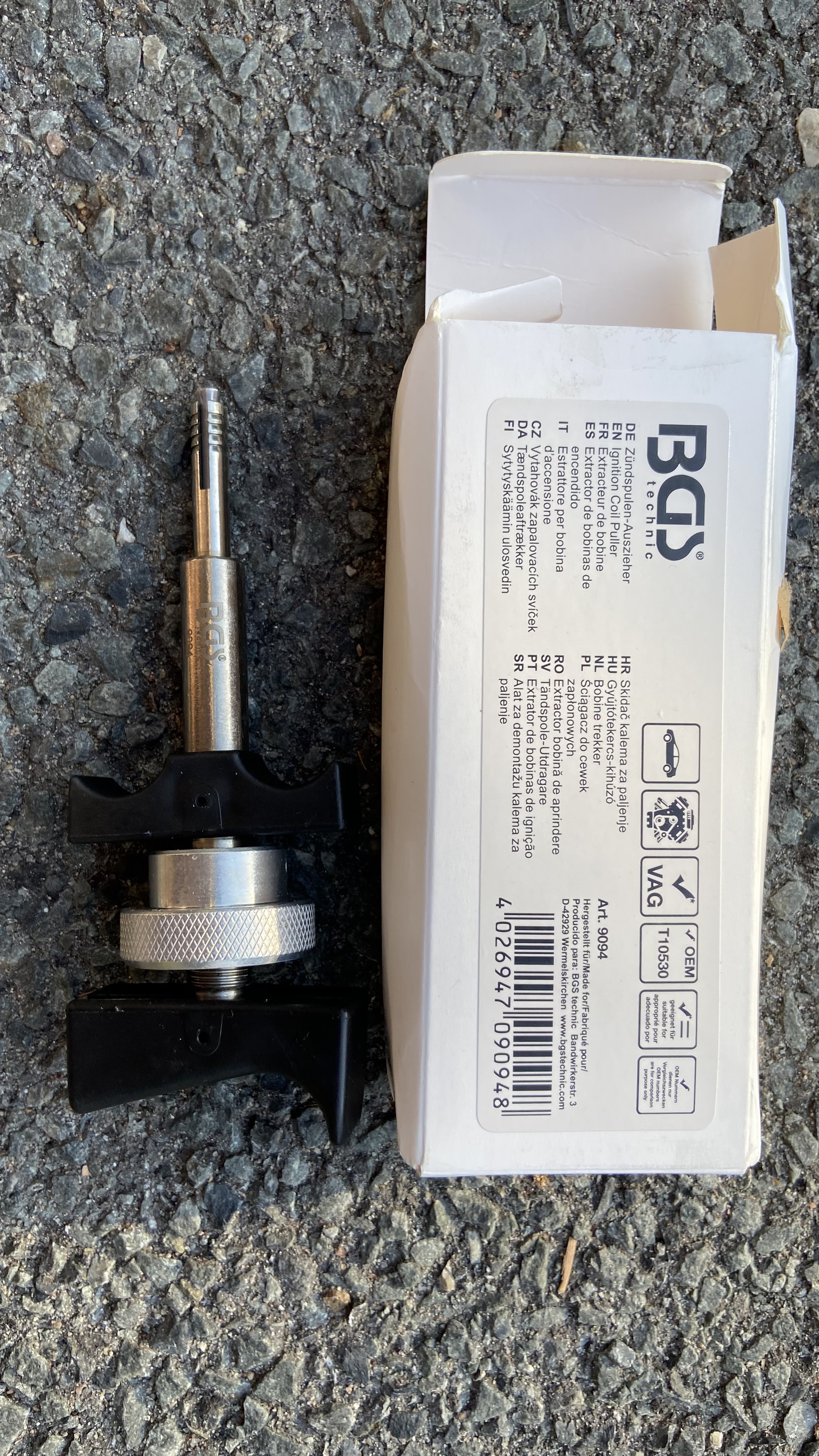

It arrived! I am very happy with this product from BGS:

Ooohhh.... shiney... I must have it!
- Posts: 6093
Re: Ignition coil puller comparison
It is indeed very good looking, maybe too good to use!
I was really really upset about the look and so finish on the one that I bought, a Laser Tools branded product that looked nothing like the item shown in a picture in their catalogue, the one that was sent out looked like someone knocked it up in a shed - which probably means that it was made in a crude workhouse in China a lot cheaper than their original source of this item.
Though it works well enough and will never end up showing any scratches that it gets when thrown back into its drawer in my tool storage system, so maybe I've now got over that initial upset, well almost got over it!
