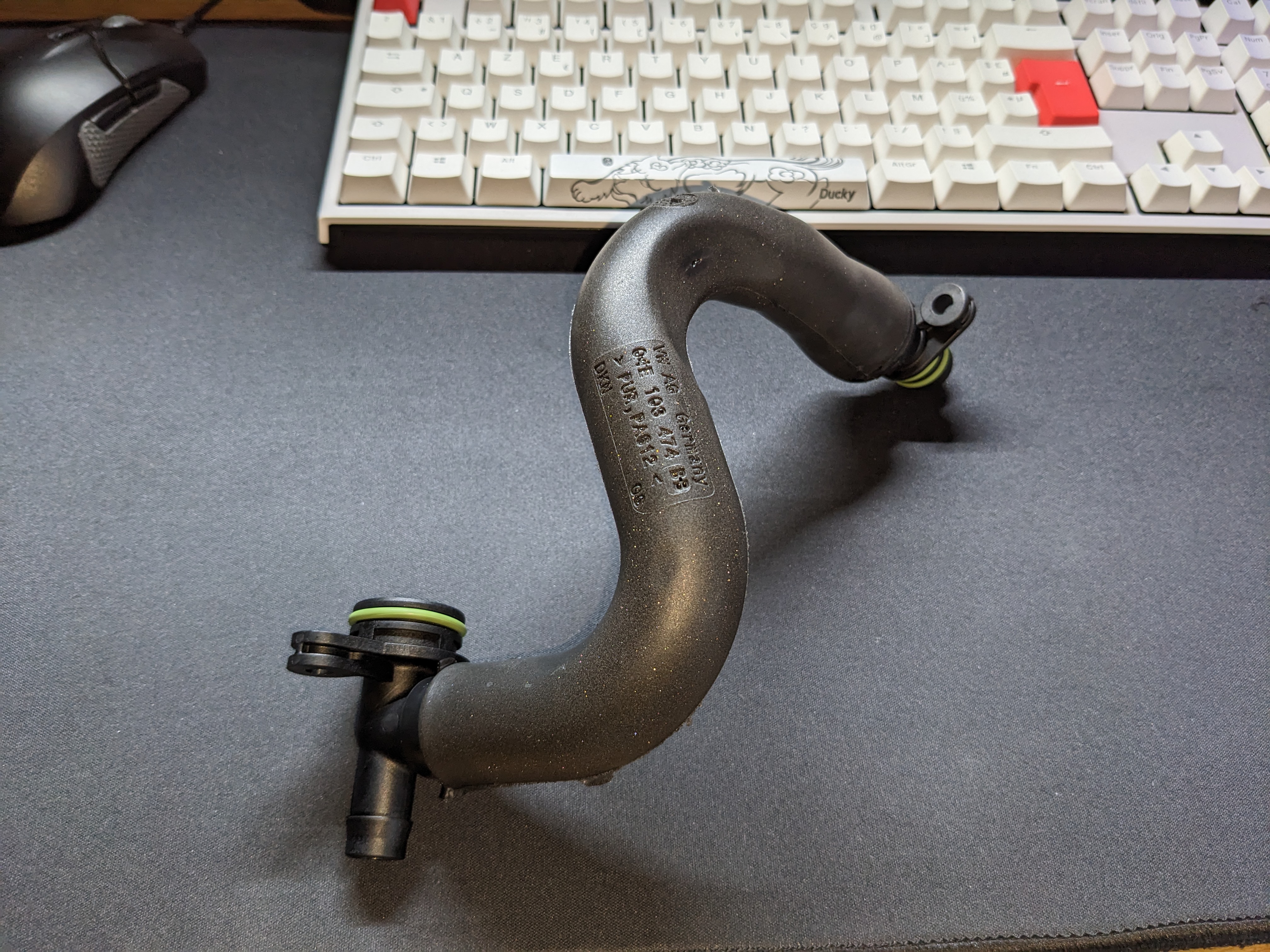

New foam hose received:
The non return valve on the turbo side (right connector) is very very, very sensitive.
I mean, I just blown a little bit with my mouth on the other side, it opened directly.

I suspected it would be. It opens based on the difference in vacuum between inlet manifold and turbo side.
The question is, which sides runs more vacuum most of the time?
I have a feeling it is the turbo side that has more vacuum than the inlet manifold until the throttle is fully closed. If that's the case then your theory of it pulling the crank cases mostly through the turbo is spot on. But also think those 2 valves are going to be flip-flopping all the time.
If you can get a vacuum signal off the turbo inlet, and then one off the intake, into a gauge with 2 ports then I suspect that gauge would lean towards the turbo side.

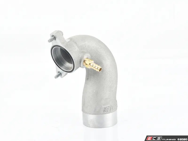

I have ECS intake arriving next week. No idea if it'll fit, but, hey, it was free (kinda).
It has port on the intake side:

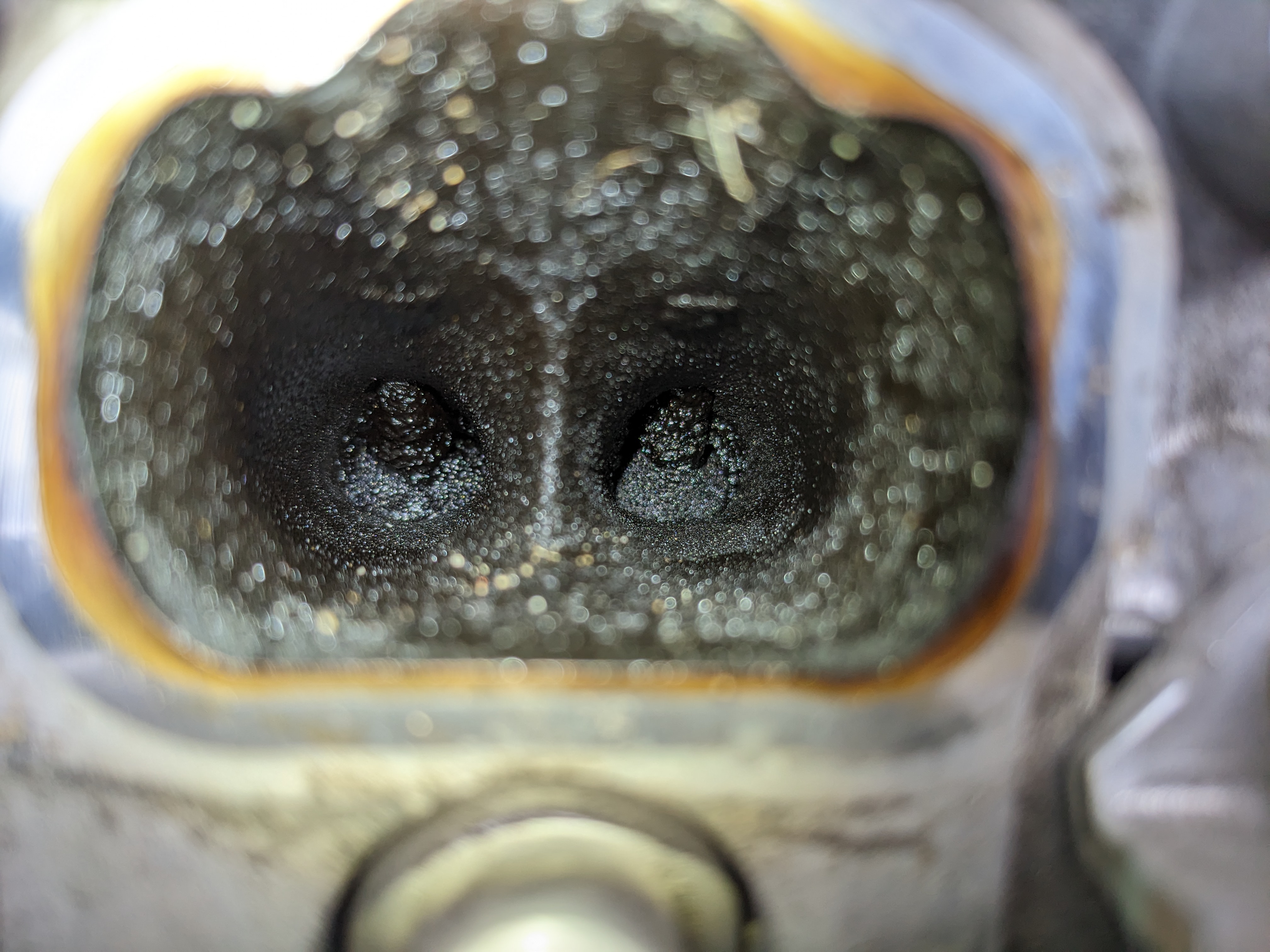

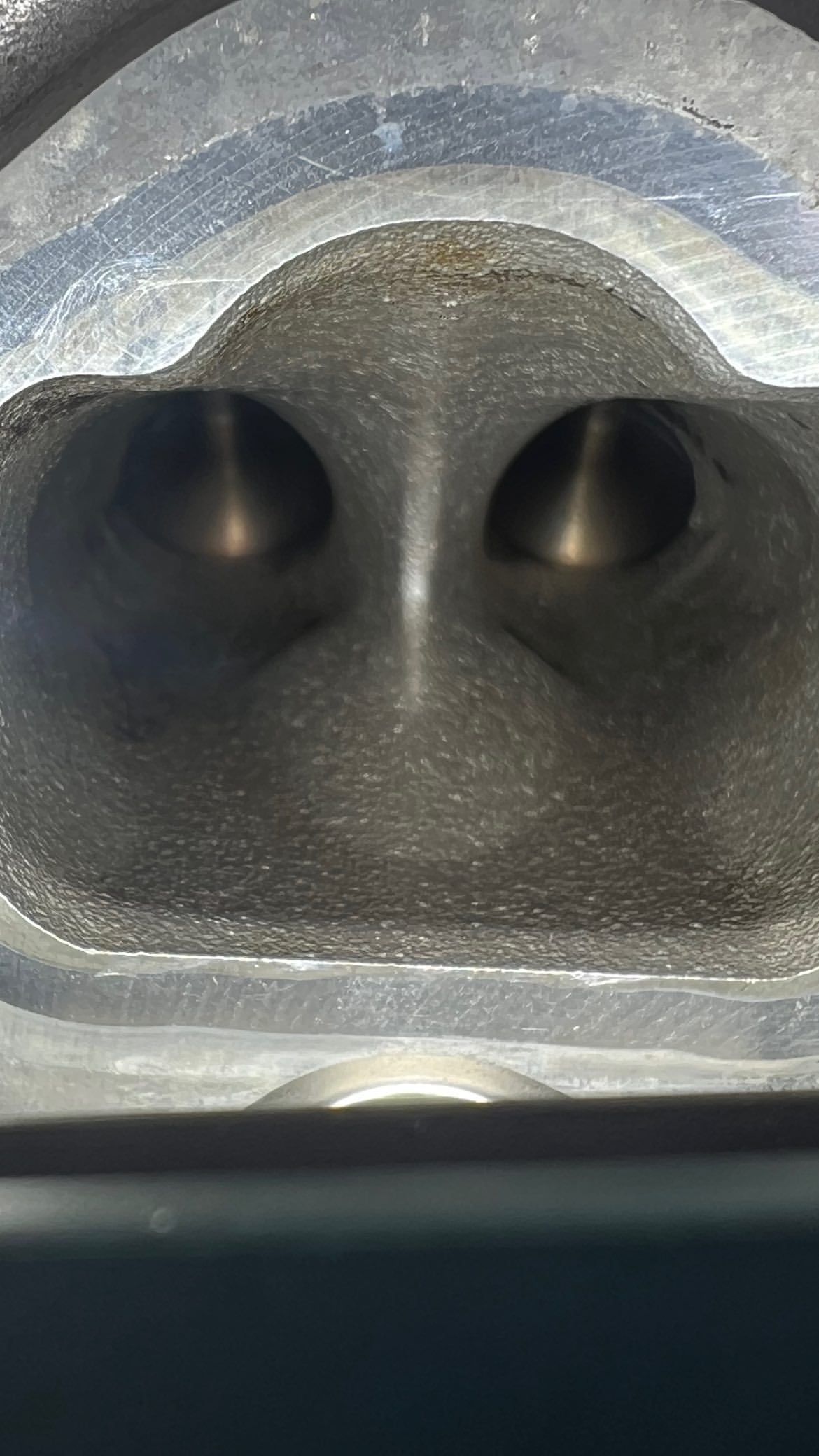

To be honest, I don't know. But each time I removed the pipe from turbo to intake manifold, this one is full of oil. So to me, turbo side is the issue.
Nice intake, you want so power upgrade to your engine ?
Before:
After:
The car feels soooooo much better. More torque, more power: more smooth.
With my VCDS I reset auto adaptative value of the injectors, recalibrated lambda sensors etc....
But yeah, I have the feeling to have a brand news car.
