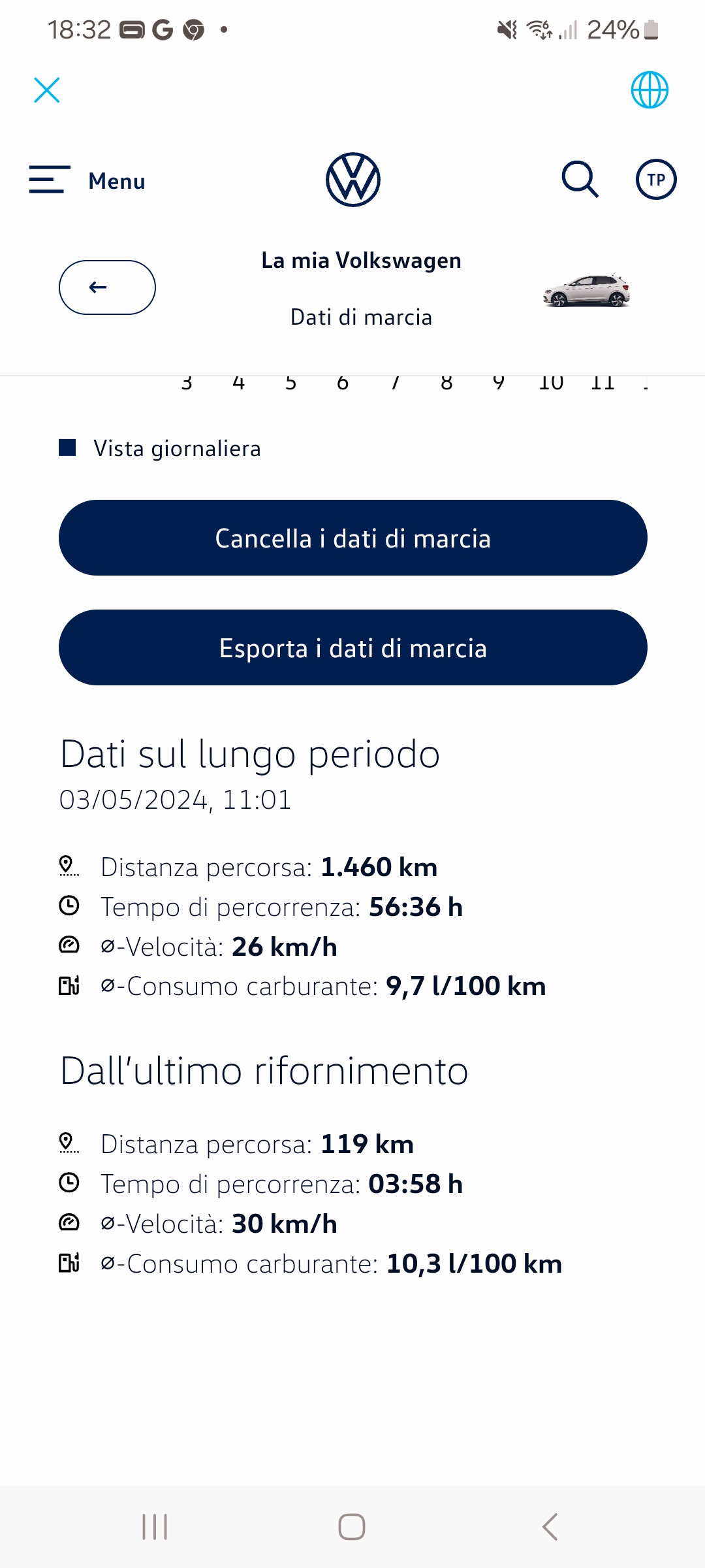

For me in traffic it's 16.8 miles per gallon.

That does sound quite poor - by ‘in traffic’ driving, do you mean when driving in urban areas such as towns and cities with lots of traffic and lots of stops? In my pre-facelift Polo GTI+, my car’s fuel consumption in town and city driving is usually around 33 miles per gallon and my overall long term average fuel consumption is around 43-44 miles per gallon.
Is your car’s GPF (gasoline particulate filter) going through a forced regeneration process? If it is, then the process uses additional fuel to help raise the temperature in the exhaust so accumulated particulate matter in the GPF can be neutralised, and that additional fuel usage may explain your low mpg figure. Do you drive mainly short journeys in towns and cities where the car’s engine may not be getting up to optimum operating temperature? If so, then you’re likely to experience more forced GPF regenerations than a driver whose driving mainly longer journeys outside of towns and cities with a fully warmed up engine.
Be aware that if a forced GPF regeneration is interrupted by turning off the engine before it’s finished, it’ll recommence the regeneration process at the next (and subsequent) ignition cycle(s) until the regeneration is able to complete. If this happens, then fuel consumption could be adversely impacted over several journeys.

Sorry but I have liters instead of gallons. This is the average for now. Let's say that the minimum I managed to do is 6.3 liters per 100 km but on the motorway
