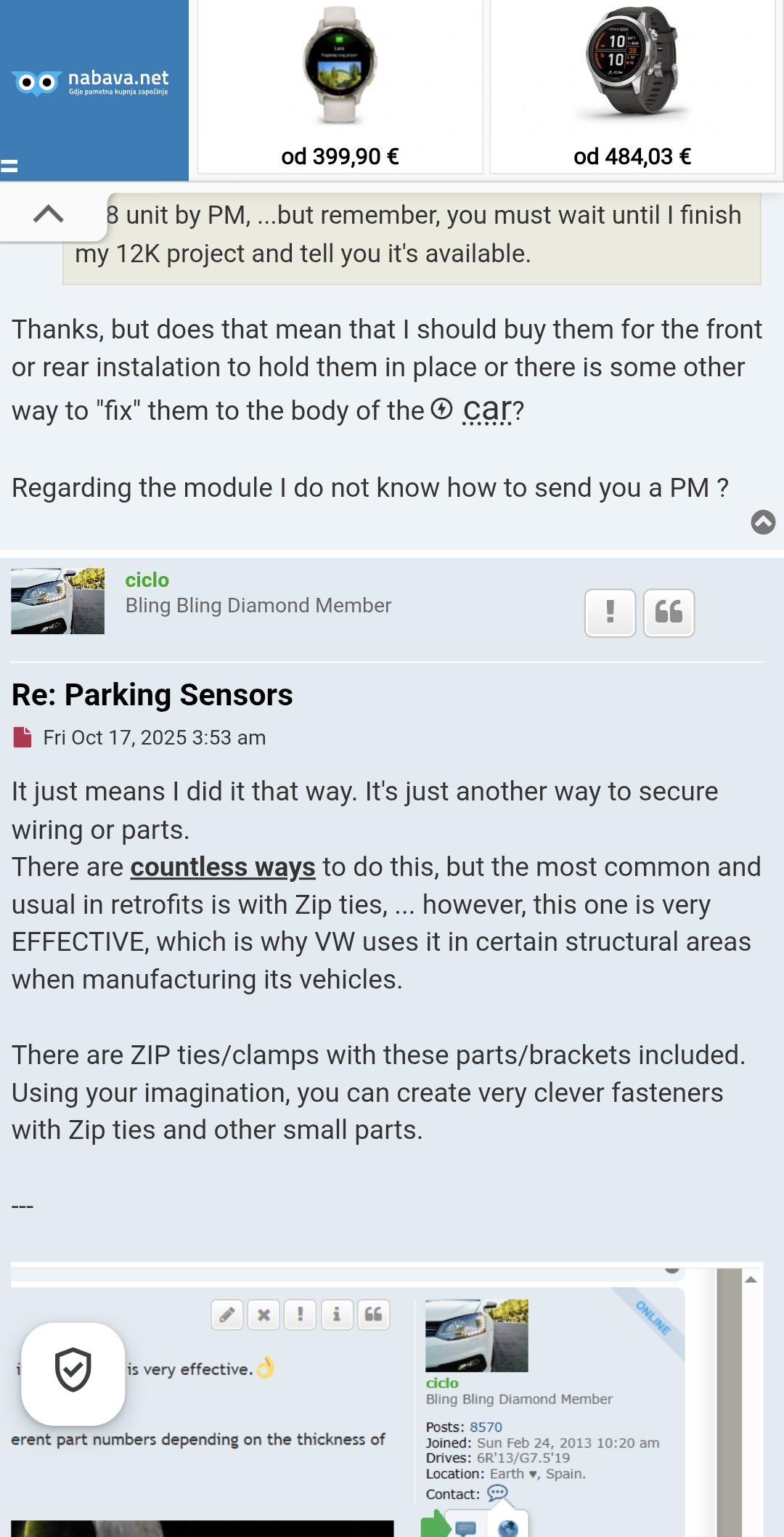

Great zip ties it is. Regardimg PM i do not see that option om the screen. Only reply here is possible.
There is no PM
There is no PM

I guess if you click on your avatar you'll see the option to send private messages.
