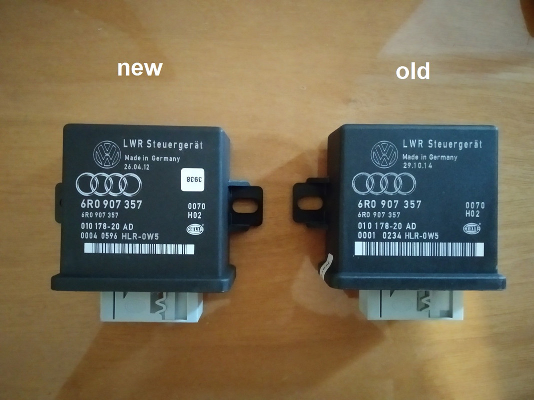

thanks to the help of ciclo and of other members of the forum I retrofitted bi-xenon headlights and AFS!
I have some big problems with the long coding; I copied a LC i found on forum tryng to adapt it to my car but with bad results. DRL and cornering lights do not work correctly (ie corner light does not work when I turn the steering wheel and DRL does not switch off when I use turning lights or handbrake). In addition to this autoscan shows a lot of errors. I am not confident with BCM coding so I post an autoscan looking for some help. :wink: Thanks in advance and have a good holidays :!:

Posts: 8867
Re: Upgrading my Polo 6R bifuel
Franciswat wrote: Tue Aug 06, 2019 11:10 pm I have some big problems with the long coding; I copied a LC i found on forum tryng to adapt it to my car ...
This is the worst thing that can be done.
I will try to make a new BCM coding for your new Bixenon headlights, etc...
As I did not manufacture any wiring installed in your 6R, any result is possible. :lol:

AFS unit
- My coding is correct for your 6R.
- The AFS unit has the correct reference number and software.
- According to the current coding (0208000001000000) it comes from a Transporter, which means that it is not parameterized for 6R, which in turn means that the second-hand unit installed is not correct. You will have to buy one from a 6R.

Perfect :wink: , all OK, except the faults we already know and their causes.
- Alarm horn and Headlight range control unit.

Hi ciclo, today I received a headlight range unit dismatled from a Polo 6R 1.390cc.
Comparing the 2 headlight range units they look almost the same.
I have replaced the old unit with the new one and cleaned the old recorded faults but I get several errors which I still don't know how to solve after several searches on the web. :cry:
