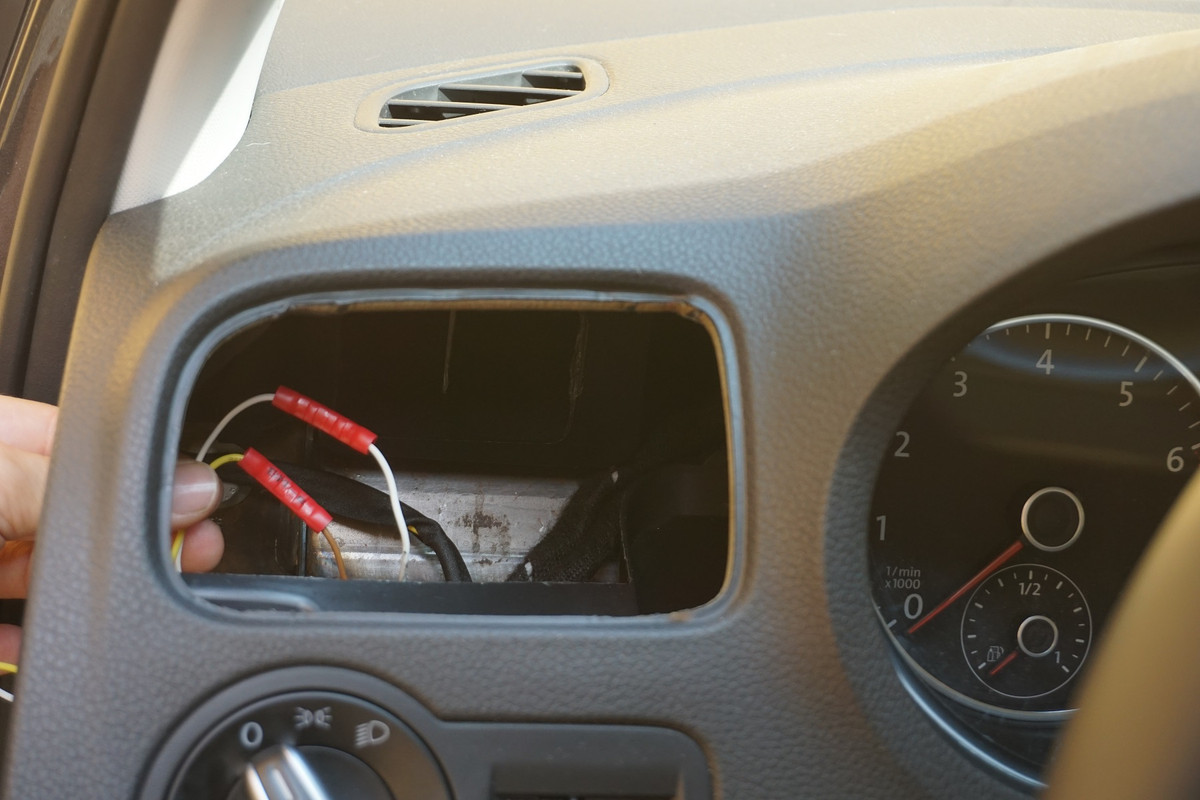

Are the soldering connections for the can lines done correctly and is the module connected to terminal 15?
Posts: 8994
Re: Upgrading my Polo 6R bifuel
Take a clear picture of the CAN lines connection points for your AFS. (close to and far)

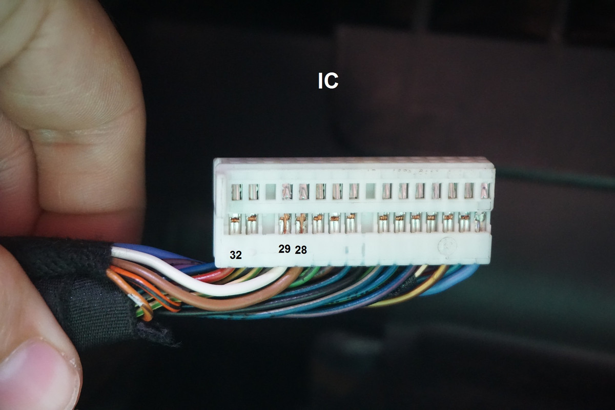

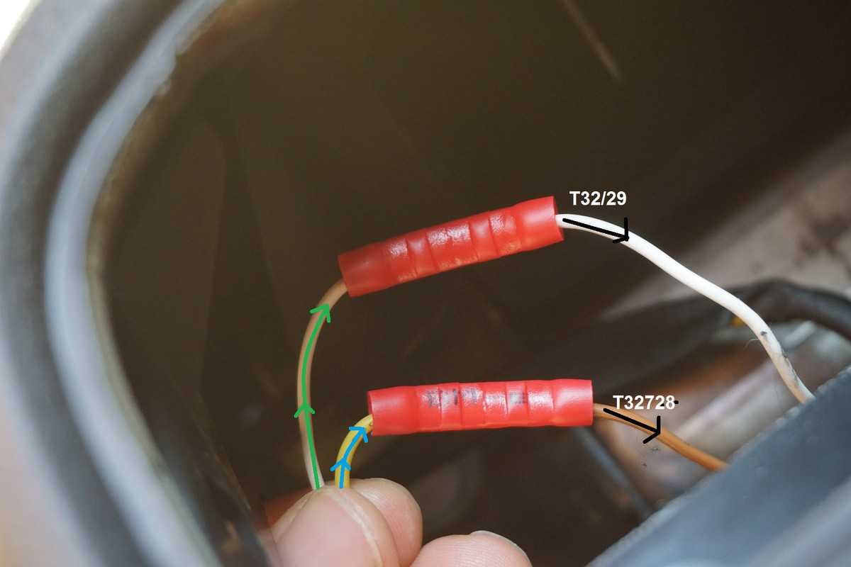

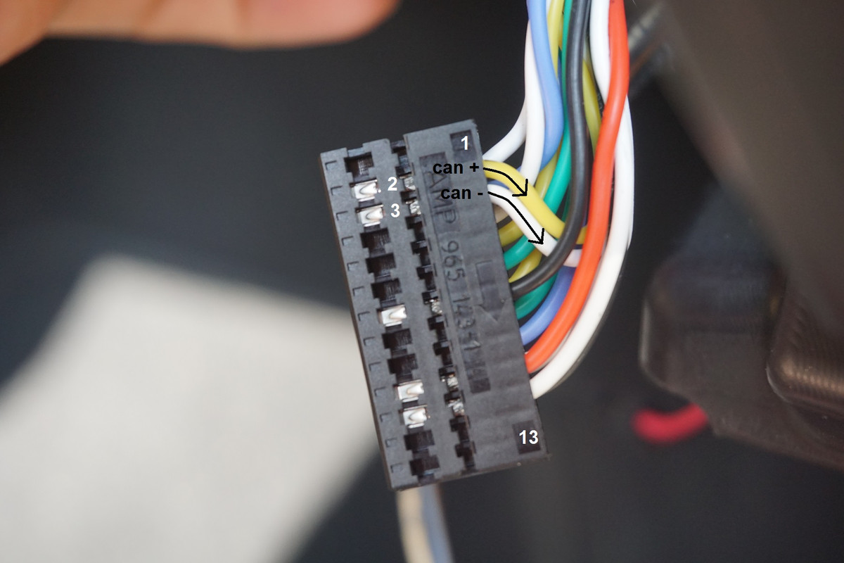

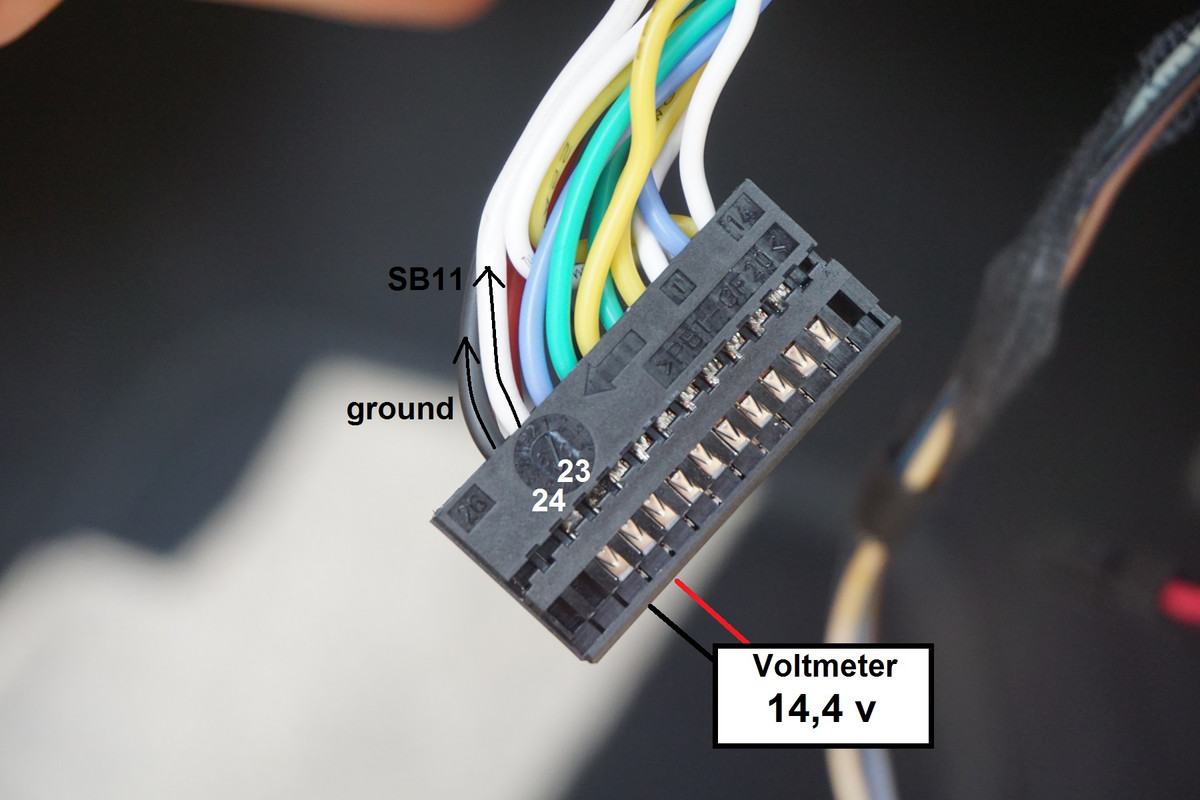

iichel I have checked both power and can connections and used a voltmeter to check if headlight range unit is powered and It looks so.
I also tryed to plug again the other range unit but can gateway error remains.
Here are some details pictures. Hope those can help.
PS flying wiring are only because I have just re-made the connections (prior made with a solder) using butt connectors.
This second joint is made because of wiring was too short.
Posts: 8994
Wrong!
The AFS unit must be connected to the powertrain CAN lines (old CAN lines for instrument cluster), not to the new CAN lines of the instrument cluster with BCM Max (54,57).
thanks for the pictures... 8)

It is convenient to twist the wires of the CAN lines to avoid possible electromagnetic interference.

Please apologize for my noobish question but at the beginning I connected the range unit to the wrong can according to the following wiring diagram.
Is that wiring diagram wrong or I am not able to get the point? Sorry for the question but I'd like to understand my error to avoid it in future retrofit.
Now that the autoscan problems are gone, one error left: the light bulb on IC when highbeam are activated (more than 1 second).
Do you think is that a coding problem? Because of I have read federicodrdpro had similar problem with his led headlight retrofit and problem was solved by a coding (I know conditions are not comparable but as far I can see both headlights works correctly).
Do you mean this way?
Thanks so much! :wink:
Posts: 8994
Franciswat wrote: Wed Aug 21, 2019 12:34 pm My deepest gratitude guys! No more errors in autoscan :!: :!: :!:
8)
When installing the new BCM Max 7E0, the communications for the IC must be improved to better manage any new function, this is achieved by creating new CAN lines (54 BCM / GW <---> 28 IC , 57<--->29).
These new CAN lines no longer belong to the power train communication NETWORK.
AFS unit must be connected to the powertrain communication NETWORK, that is, what you have done to make it work properly.
It does not matter that the old wires powertrain CAN lines reach specifically to the IC, the important thing is that they are powertrain CAN lines.
Franciswat wrote: Wed Aug 21, 2019 12:34 pm Do you mean this way?
Yes.
