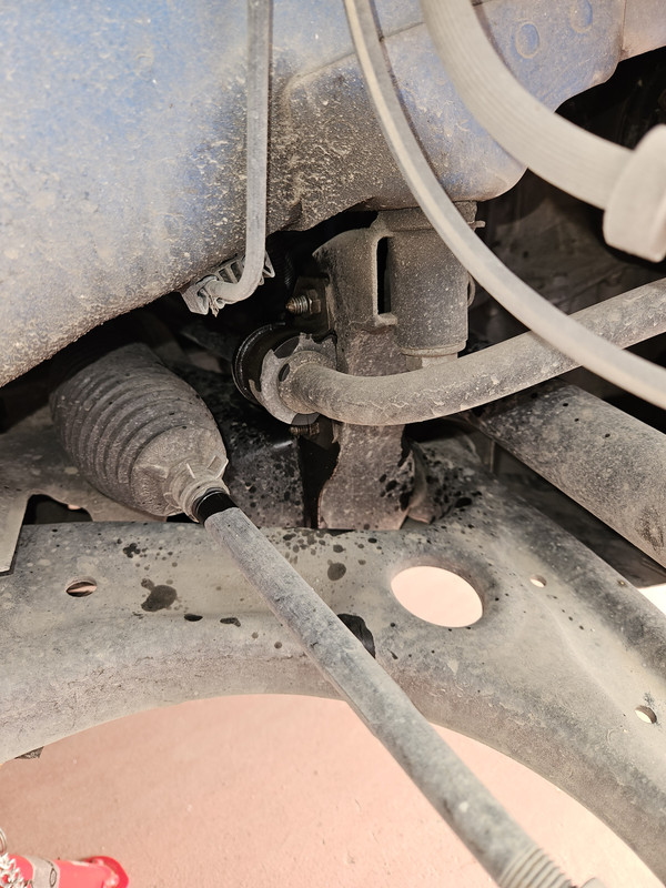

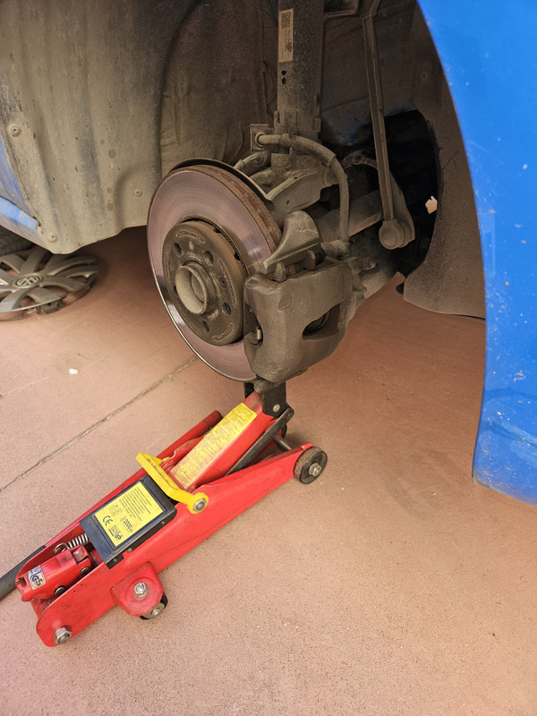

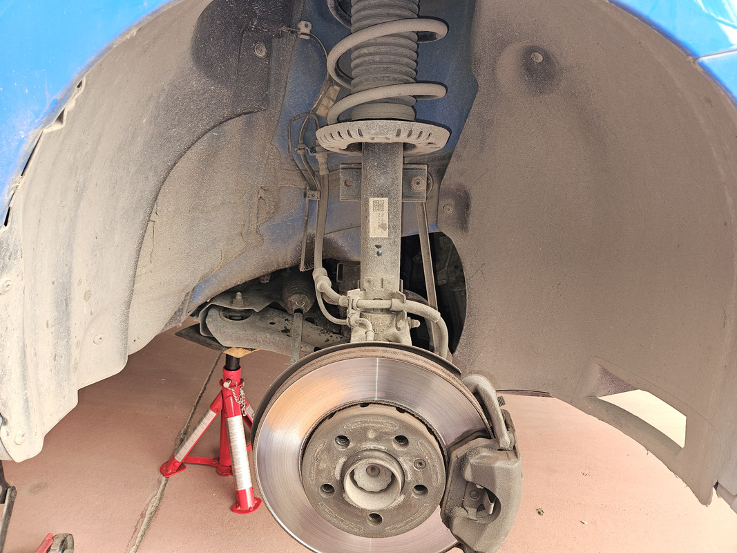

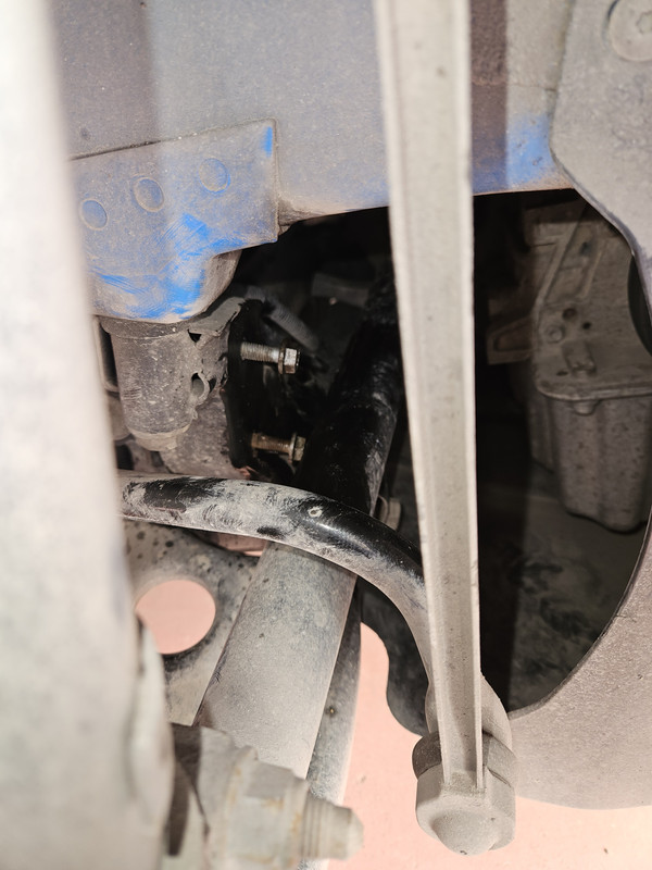

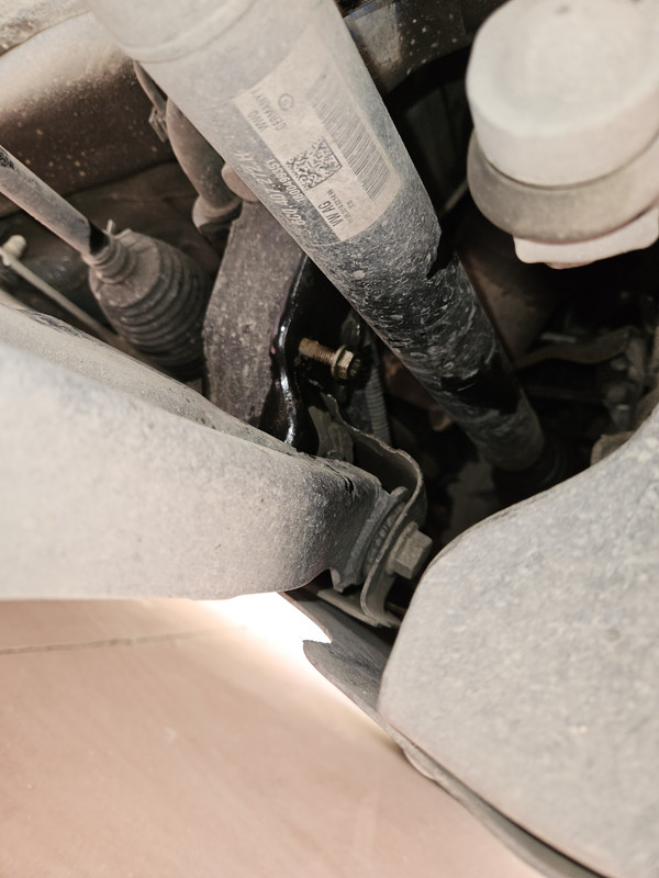

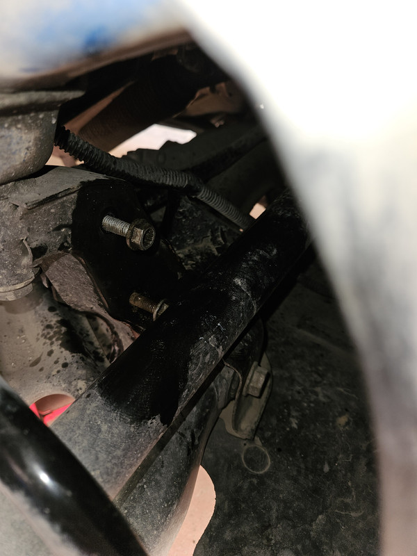

#Rubber bush front Anti-roll bar
in the winter months, especially the first few minutes the car is moving, creaks are heard from the front.

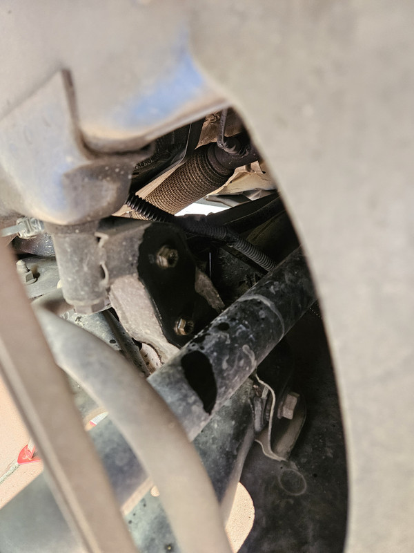

After checking all the connections for torn seals, damaged shock absorbers, I decided to start with the simple and cheap ones. To change the elastic connections of the anti-roll bar
Step 1, we lift the front left wheel, remove the wheel and have immediate access to the two screws of the connector.
We unscrew the screws and....
The lower bolt won't come out, it hits the driveshaft.
The solution is simple, lift the wheel a little with a jack so that the bolt can be released.
From here on things are simple. We remove the metal support together with the rubber joint, and separate the rubber joint.

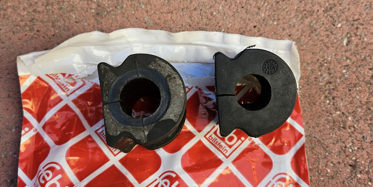

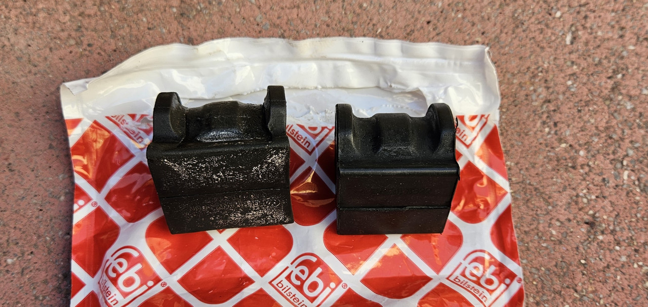

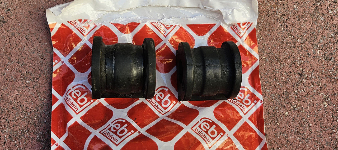

On the left is the old, on the right is the new.
It doesn't look quite as worn out, but the change has been made.

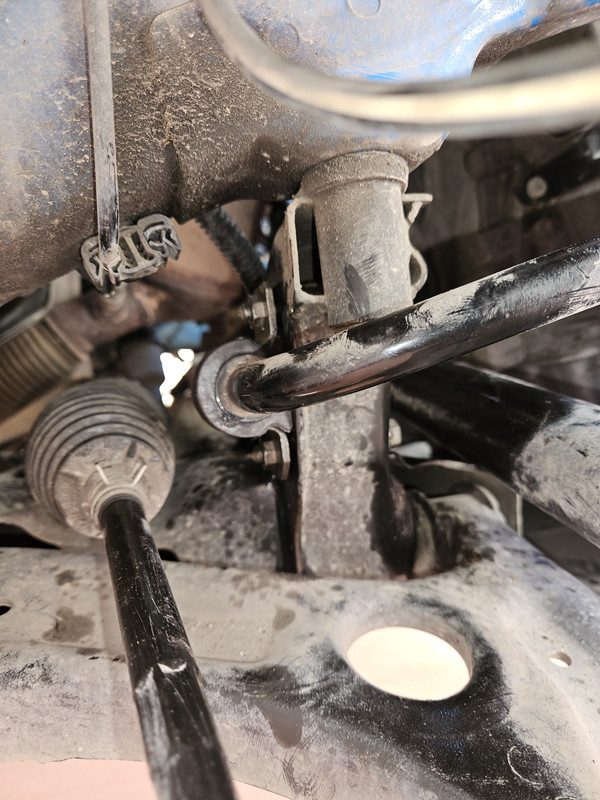

Place the new rubber bush inside the metal plate and tighten the 2 screws. We do not tighten the screws completely so that we can easily insert the other bush at the opposite side.
The left side is ready, we do the same on the opposite side. There the driveshaft is not in the way, so we didn't need to lift the wheel to free the bottom screw.
We tighten the screws normally according to the instructions and finish the right side.
We go to the left side, tighten the screws there too and we are ready. We install the wheels and that's it.

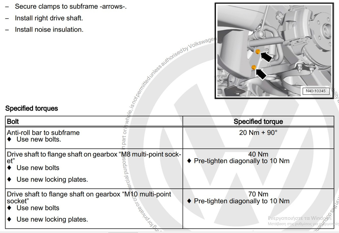

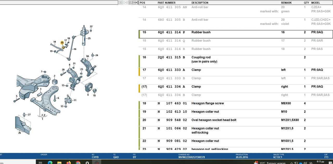

- Posts: 6685
Re: Giannis20vt's Polo 6c 1.0MPI
These are stretching bolts, so technically you should have replaced them
giannis20vt
- Posts: 425
- Location: Greece
You are right, the code is N10746301 is the number 18 from the my first picture.iichel wrote: Sun Apr 13, 2025 6:13 pm These are stretching bolts, so technically you should have replaced them![]()

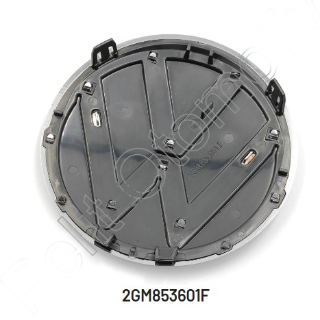

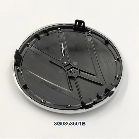

Hello there,
is it possible to change the VW badge to my car with the new one from VW Golf 8 (or Polo2024) ?
i "borrow" a photo from another member
- Posts: 8836
Yes, but that image isn't the right one.
Look here at what the result would look like.
viewtopic.php?p=608762#p608762
It doesn't matter if it's RVC High or Low, or just the emblem with the opening mechanism.
If you're not particularly skilled in general, it seems best to buy the complete swing/flip emblem assembly with the opening mechanism.
Changing just the emblem by removing the axle is not an easy task for most people. Remember I warned you.

giannis20vt
- Posts: 425
- Location: Greece
Yes, that's the picture I saw and thought I could make the change.
Thanks for the warning Fernado.
Are there any links for the badge? I looked on Aliexpress but I don't know exactly what to buy.

- Posts: 8836
On 'Ali', I only know links to OEM RVC High/Low 'with the current rear VW emblem'.
For the 6C front grille emblem, there isn't a good solution to get the look of the current VW emblem. What's available are cheap plastic pieces that stick over the factory emblem, a very poor and disposable solution.
With good crafting skills, 'and money', they can be improved to truly look like OEM, maybe I'll do it in the distant future.
- Forget 99.9% of the YouTube videos showing these DIY emblem change... it's all rubbish.
