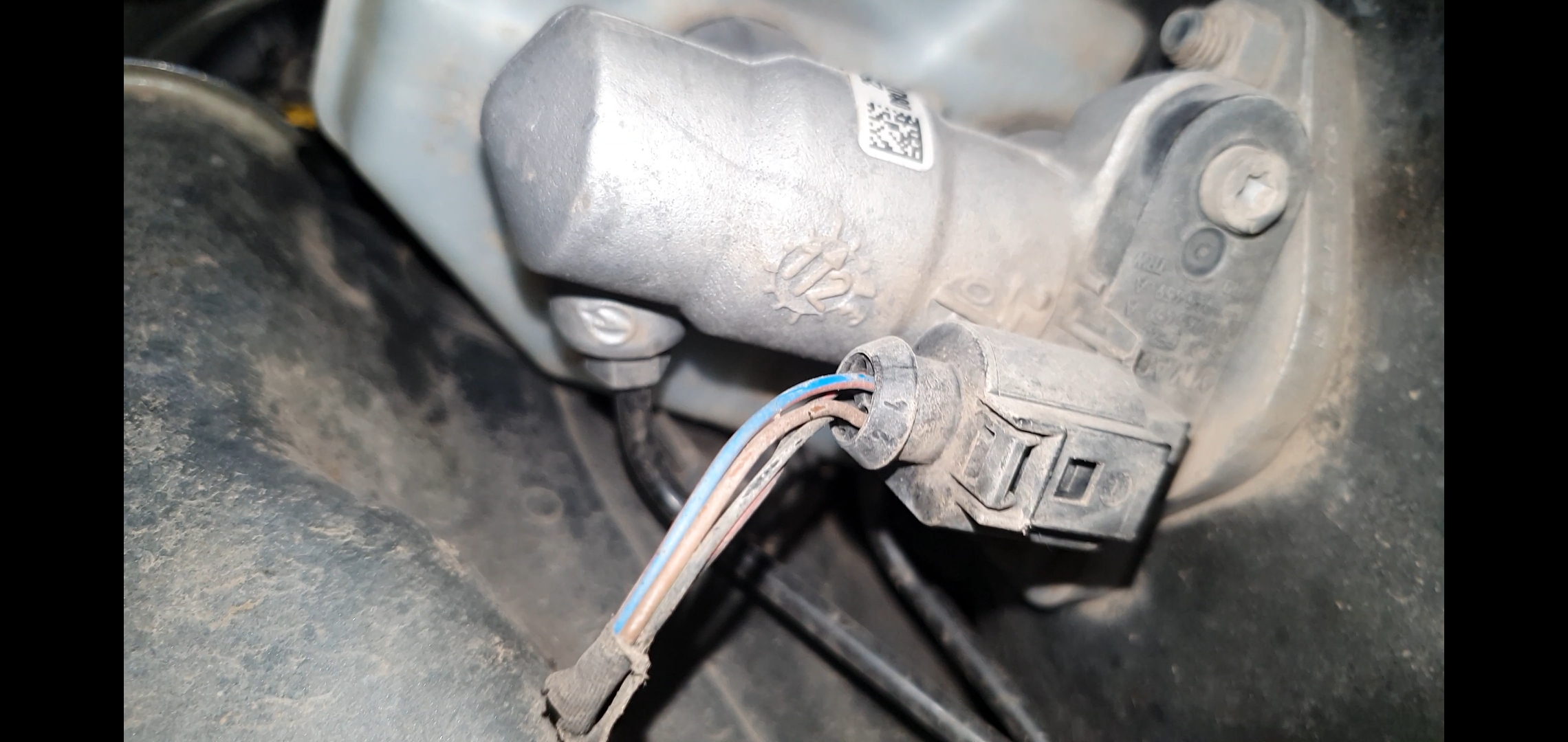

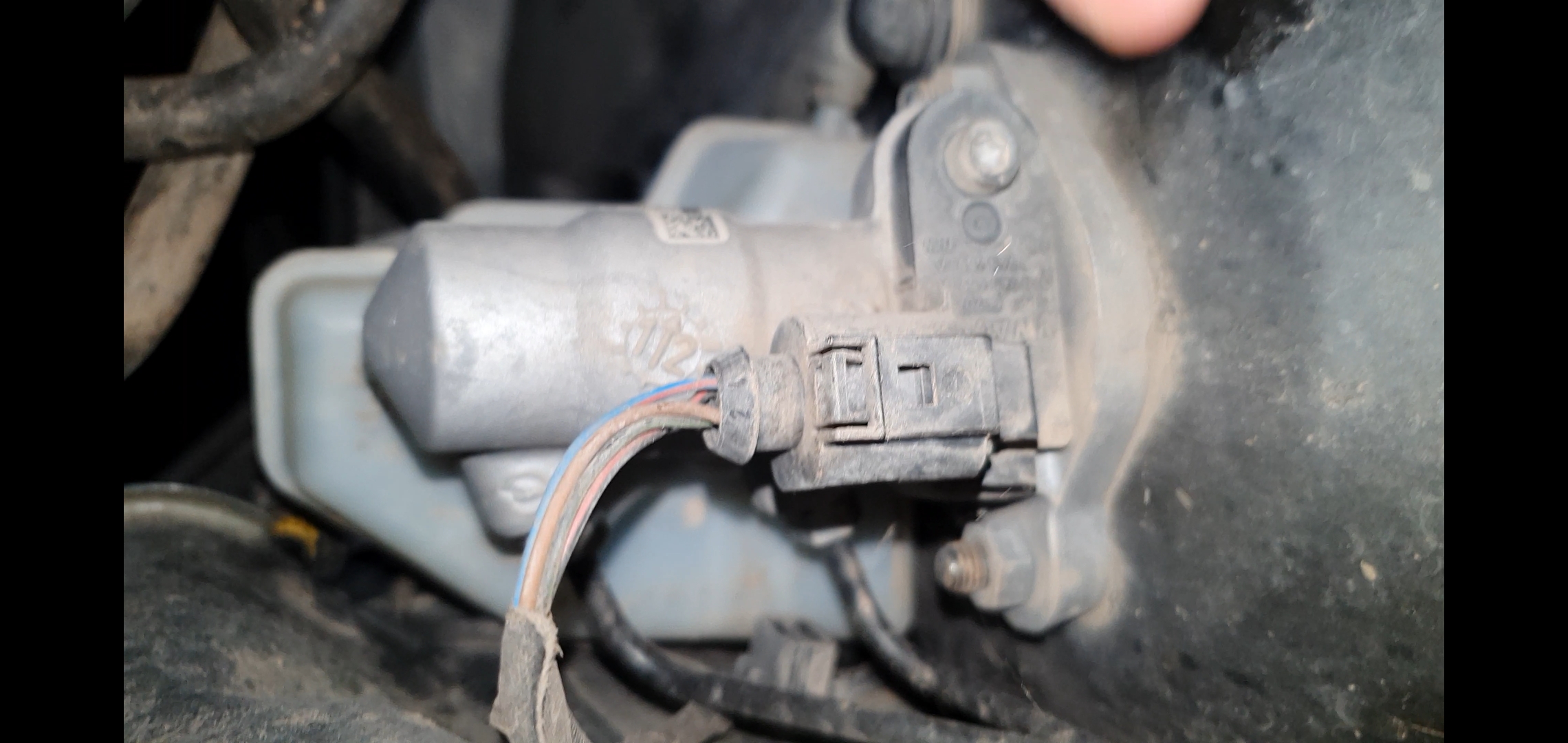

There is everything up side down. Impossible to see the screen from top. Any what I could do, was intuitively put screw driver into the screw, but did have room to use power to screw it out.
I gave it up, because I was afraid I break the screw and then I do more problems.

- Posts: 8976
Ok, thanks for the images, you did the right thing, it is better not to make the situation worse.
For LHD vehicles it is somewhat easier to access the screw.

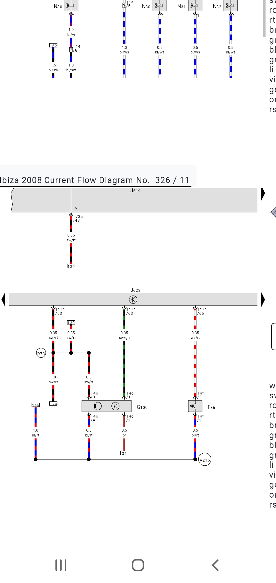

I wonder why the sensor sends 2 signals to engine unit? Does it have impact on brake light?ciclo wrote: Sun Jan 09, 2022 7:19 pm In case you can draw any conclusions ...

Following electrical diagram, it shows that sensor sends signal straight to BCM to T73a 43, which should give impuls to pin T73b 16 , to make brake light working.

- Posts: 8976
It is not related to the brake light.
The engine electronics must know both the brake activation and the brake pedal position... it's just that the same wire/signal is used for both the BCM and the ECU.
