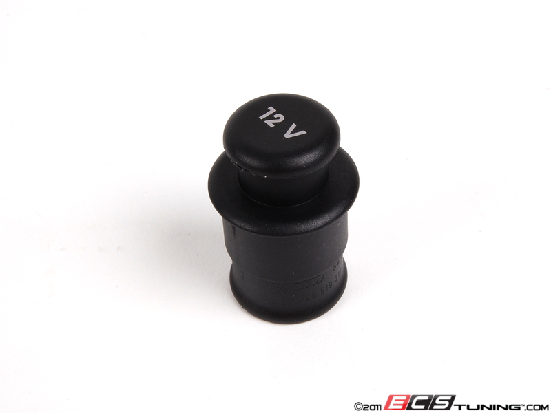

Just a tip: 12V 'dummy' instead of cigarette lighter --> 7L6919311

iichel wrote:Just a tip: 12V 'dummy' instead of cigarette lighter --> 7L6919311
There is a lid on the 12V socket iichel. So I don't think that will be a problem. :wink:
Posts: 6685
Re: ciclo's Polo. R-line 1.2 TSI 90hp 119gr.
Yes that's true but my car came with a cigarette lighter and I don't like it. And I don't really want to take out the entire centre console to change the cigarette lighter. :p
