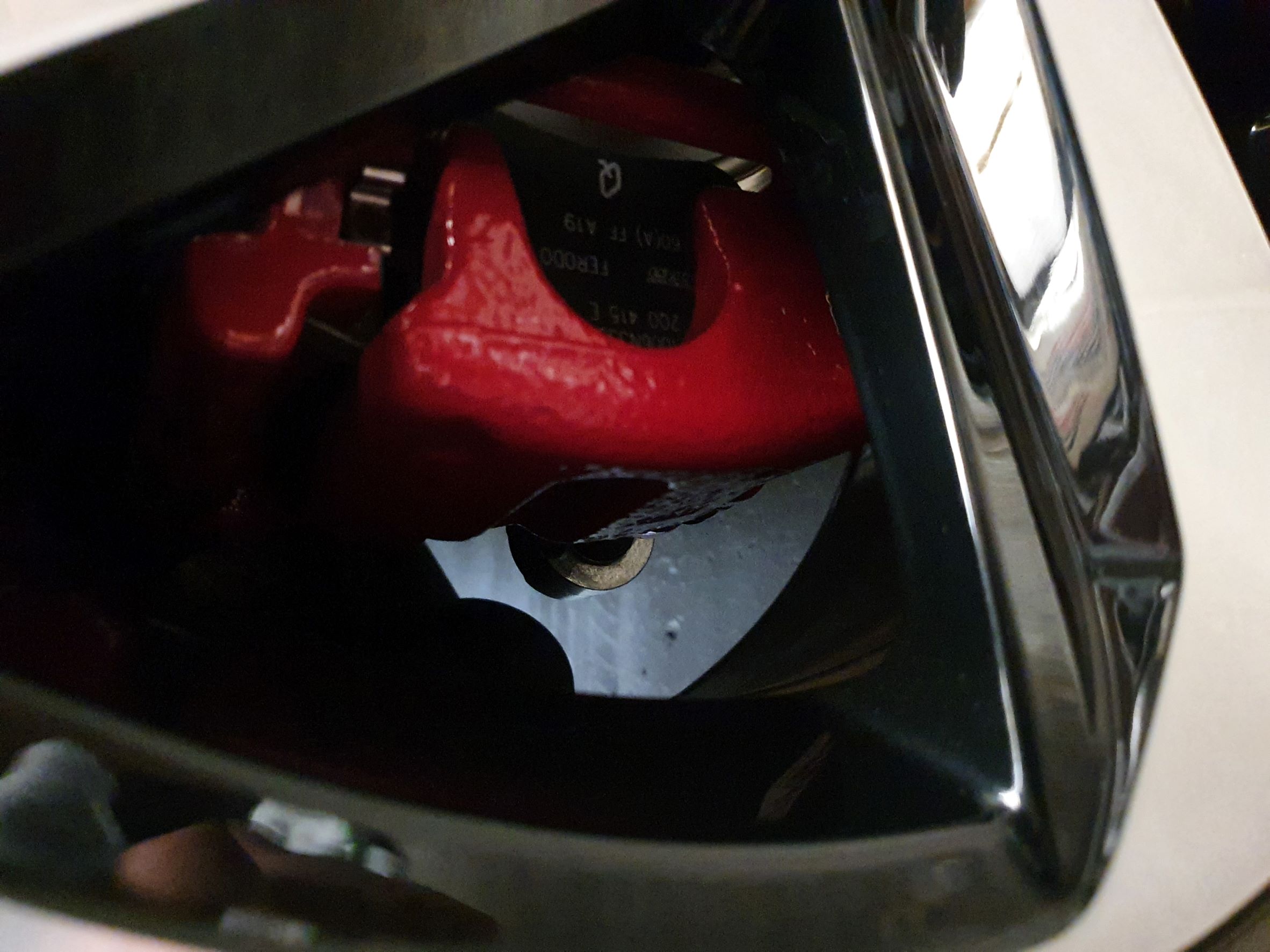

Re: Help! Rear wheel humming noise. Polo GTi
Mine was repaired at the beginning of August and since then I've never heard the noise when reversing.
But I was the one who unfortunately had to press at the beginning of May, which I think was when I read the solution here.
My dealer didn't even know VW's solution for carrying out the intervention.

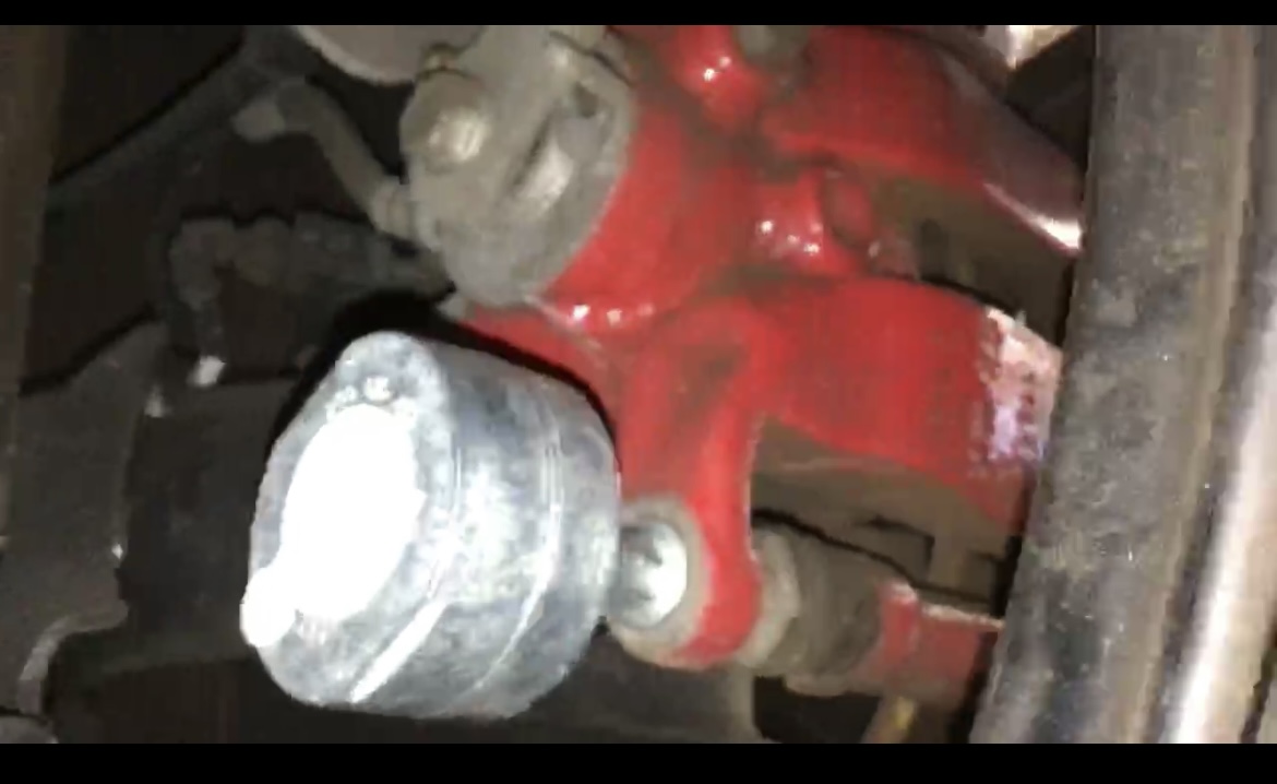

So after two and a half years of ownership, the problem has (hopefully) been resolved. Car went in for the fix this morning.
Reverse parked when I got home and had no noise, fingers crossed that stays the same now and that's the end of the issue. All in all took about an hour for them to do, also got sent a standard health check video when I was sitting in the waiting room and everything else was fine which was good.
Had a browse around the show room, the ID.3 / ID.4 were there and have to say they look a lot nicer in person. Surprised how big they are.
Every car had a notice on the window about the semi-conductor shortage and long build times. Know the pain of waiting for a new build so I do feel sorry for those who are waiting!
There was a Golf GTI Clubsport 45 in the car park, looked stunning. £46,000 starting price though.
