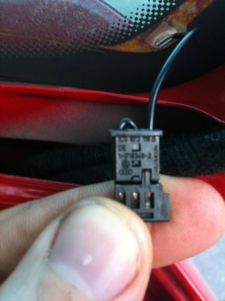

I think about use silver glue to repair heated glass and something like this:
to retrofit second aerial in my rear window.
I want to use glue instead of soldering to glass.

If you have the Diversity antenna system in your car there is all ready an FM amplifier behind the trim in the rear window. Simply change this to the one with both FM and DAB and drag a cabel to your head unit. That's it.....
