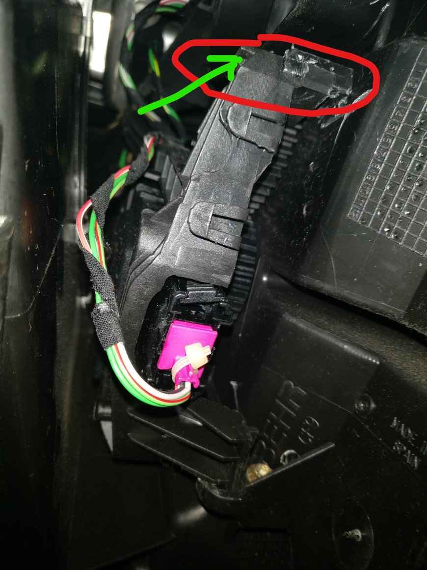

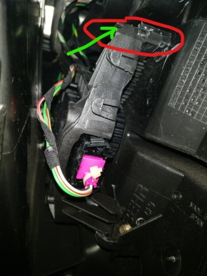

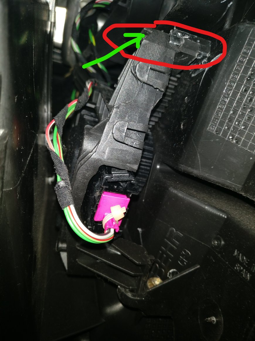

Doing this job now and stuck at:
12. Remove the motor and bracket.
How to unclip/remove the motor? The black tab shown in the photo is very tight and when I lift it cannot dislodge the motor. There is some lateral movement around this area but cannot figure out what I need to do to release it.
Assembly shown with fixing area in red and tab in green.
