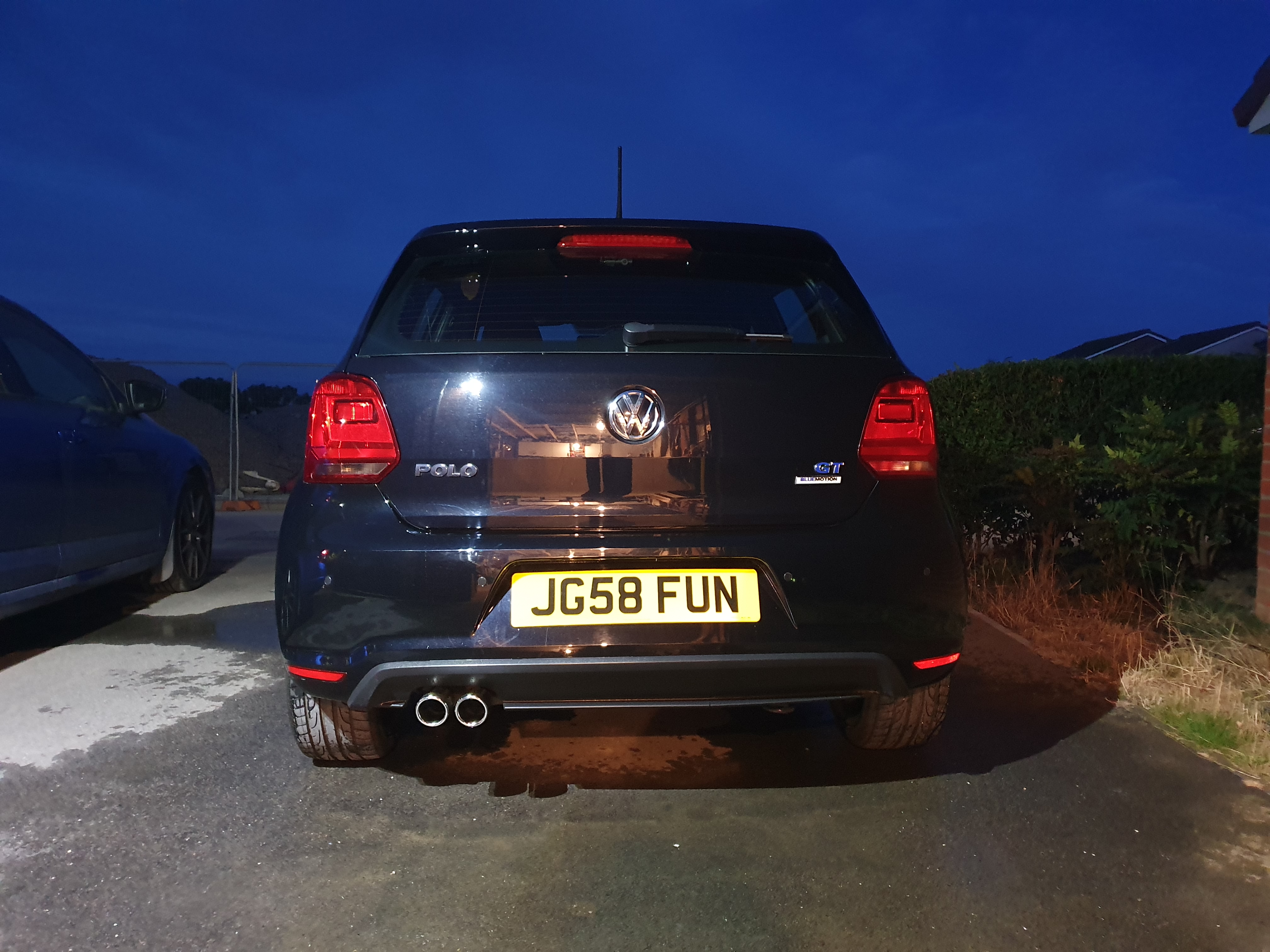

I've just fitted my Yeti tailpipe finishers (From Caffyns eBay shop) to my BlueGT and didn't snip any retainer clips off. All I did was pinch all four clips at the loose end with pliers to flatten them a little. The finishers then went on firmly and easily with the help of a wooden mallet.
Keithgoulding
Posts: 9
Joined: Mon Nov 26, 2018 8:43 pm
Drives: 2014 GT Wolfsberg
Location: Ayrshire
Re: Chrome Exhaust tips for blue GT
Post by Keithgoulding »
Have ordered a pair of tips for my GT. Arriving tomorrow 😊😊😊
