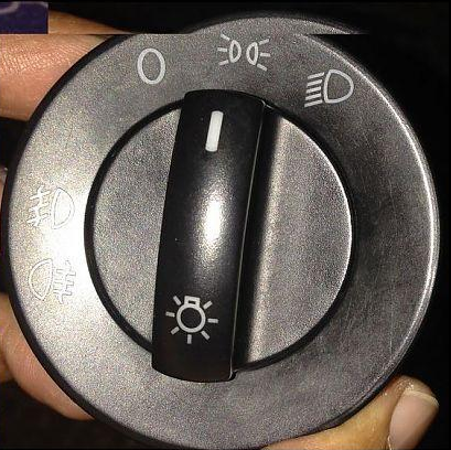

Hi ciclo. I followed the instructions in this thread, and have installed the dimmer switch unit in my GT TSI. I have also isolated the license plate lights from the circuit.
I am facing a peculiar problem after installation. When the headlight switch is in the pilot lights mode, the backlights in the instrument cluster, HU, and AC display turn off completely after I rotate the dimmer scroller to about 50%, and remain off for the rest of the range up to the minimum brightness position. This problem disappears in the headlight mode. The other lights (e.g. cigarette lighter, DSG gear selection, window switches) work perfectly in all modes.
I am using an AliExpress headlight switch (with inbuilt light sensor), and thought that may be the reason. But when I tried with the stock headlight switch, I faced the same problem. Can you help me? It seems to me that the dimmer switch is not supplying enough current in the pilot lights mode.

TheLizardKing
Posts: 28
Joined: Mon Mar 11, 2019 11:28 am
Drives: VW GT TSI 1.2
Location: India
Re: INSTALLING DIMMER SWITCH IN POLO-6R
Post by TheLizardKing »
ciclo wrote: Wed Aug 28, 2019 9:45 am What should I understand by headlights switch in Pilot lights mode?
Sorry for the confusion. I mean the above position of the headlight switch.
Posts: 8867
Ok, I'll check the Dimmer operation in the side lights position.
I'm curious since you've asked the question.
Posts: 8867
Well, in my 6R (PQ25 BCM Max) the Dimmer works for all interior lights (IC, A/C, HU Nav, switches) exactly the same in all three light switch positions (AUTO, Side lights, Dipped lights).
Dimmer IN, T6/3 = 58 signal
Dimmer OUT, T6/5 = 58d signal.
With BCM Max, signal 58 is supplied by the BCM, T73b/1 or T73b/4. (with BCM control, and modifiable)
With BCM High, signal 58 is supplied by the light switch. (without BCM control)
VW manufactures a wide variety of light switch models for the PQ25 platform around the world, according to the equipment and laws of each country (check ETKA).
Knowing the differences or how all these light switches are manufactured internally would be a gigantic and useless task.
The only ones that really matters are the ones that have the AUTO function. :lol:
TheLizardKing, if you want, with your original light switch installed, make two voltage measurements in T17/16 (= T6/3) contact terminal, one in Side lights position and the other in Dipped lights position.
