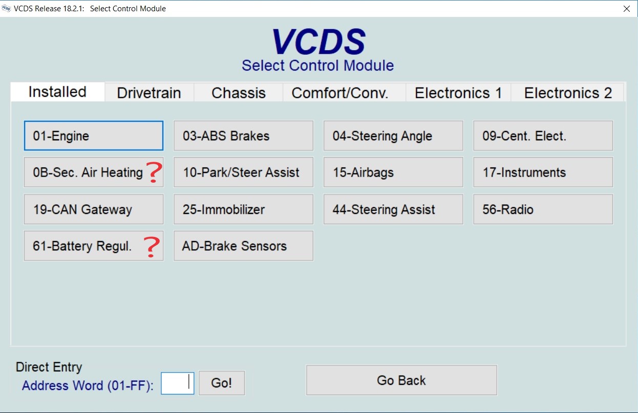

Hello, thx a lot, I dont want to bother you no more, so next steps after your harness instalation. Many thanks ... Daniel
Re: BCM Max PQ25, adaptation. Automatic lights. Skoda Citigo/VW Up!
Hello ciclo, pls I saw that you mentioned Citigo/Up!/Mii Emergency Brake Button in your Polo thread ...
I already retrofited Emergency Brake and nondirect TMPS ( via ABS ) but dont know where it must be activated.
Buttons via VCDS are working, harness is OK - exactly as in original ...
Emergency brake is on in cluster adaptations but unit throw error that external module is incorectly coded ... BUt I dont know where ... IN BCM? In ABS? VCDS has limited labels for this ...
My scan, can you pls help me ...
Nice day to Spain!
Daniel

I can not help you, I do not have the necessary knowledge. I am sorry.
Please inform us about the BCM adaptation, automatic lights, etc ... (if it is your wish). Thank you.
BCM adaptation is a priority step to any other electrical installation.
We all have to contribute something to the forum, asking and asking is a bad habit...
Please, I hope you understand what I mean. Thanks.

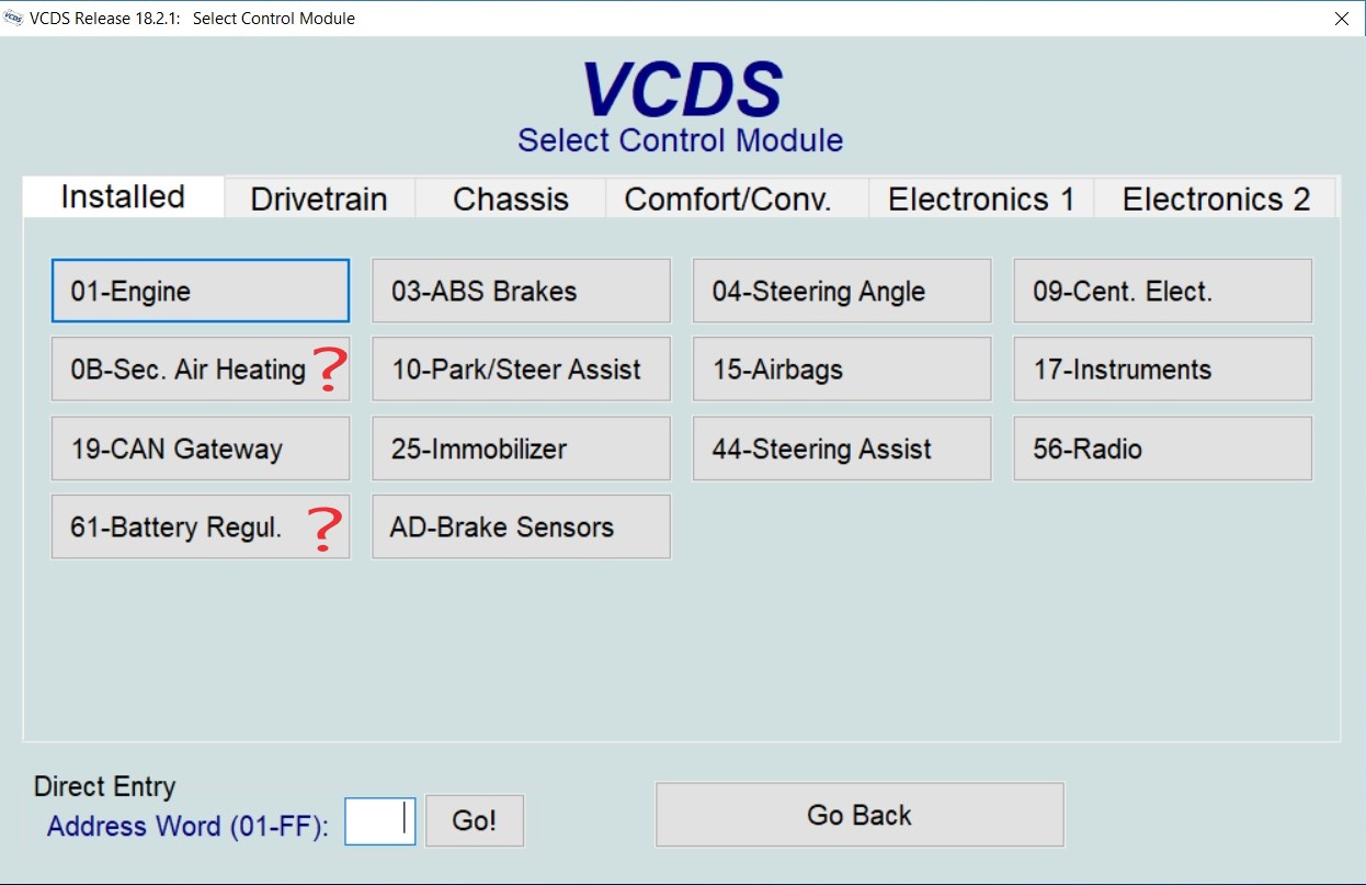

Ciclo, finally did it, fogs, DLR cables, new battery, new headlights, new BCM ... many thanks, working great. You are pro!
5 questions ...
1.
Pls see log - there is lic. plate error - have LED, so can be the bulb check uncoded? I find some :
check Bit 7 of Byte 17 and uncheck k Bit 6 of Byte 23 ... or any way?
Or resistor must be used? Bulb is working of course ...
2.
Module 61 battery regulator - its shows error in VCDS - see log. Only in module list, in detailed scan not ...My Citigo dont have bat. regulator - any way to disable it in BCM ( its part of BCM? )? Or coded to clear error permanently?
3.
Strange module 0B - Sec. Air Heating - showsa only in VCDS module screen, in scan not ... What its ???
4.
Gateway i recoded to 002000 - as was my old BCM Gateway ... Its OK?
5.
Its possible to install Auto Hadlight Assistent? Auto high beam? BCM support it ( right?), so need new stalks, camera ... how to check that instruments are compactible?
Many thanks for your great work master, nice day to Spain!
Daniel
5 questions ...
1.
2.
3.
4.
5.
Daniel
