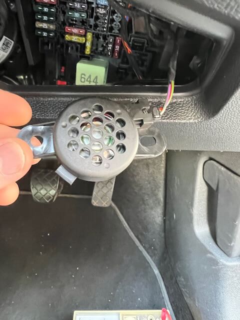

by breeza
What is this thing that I found just hanging freely in the fuse box compartment? Looks like some kind of speaker.
