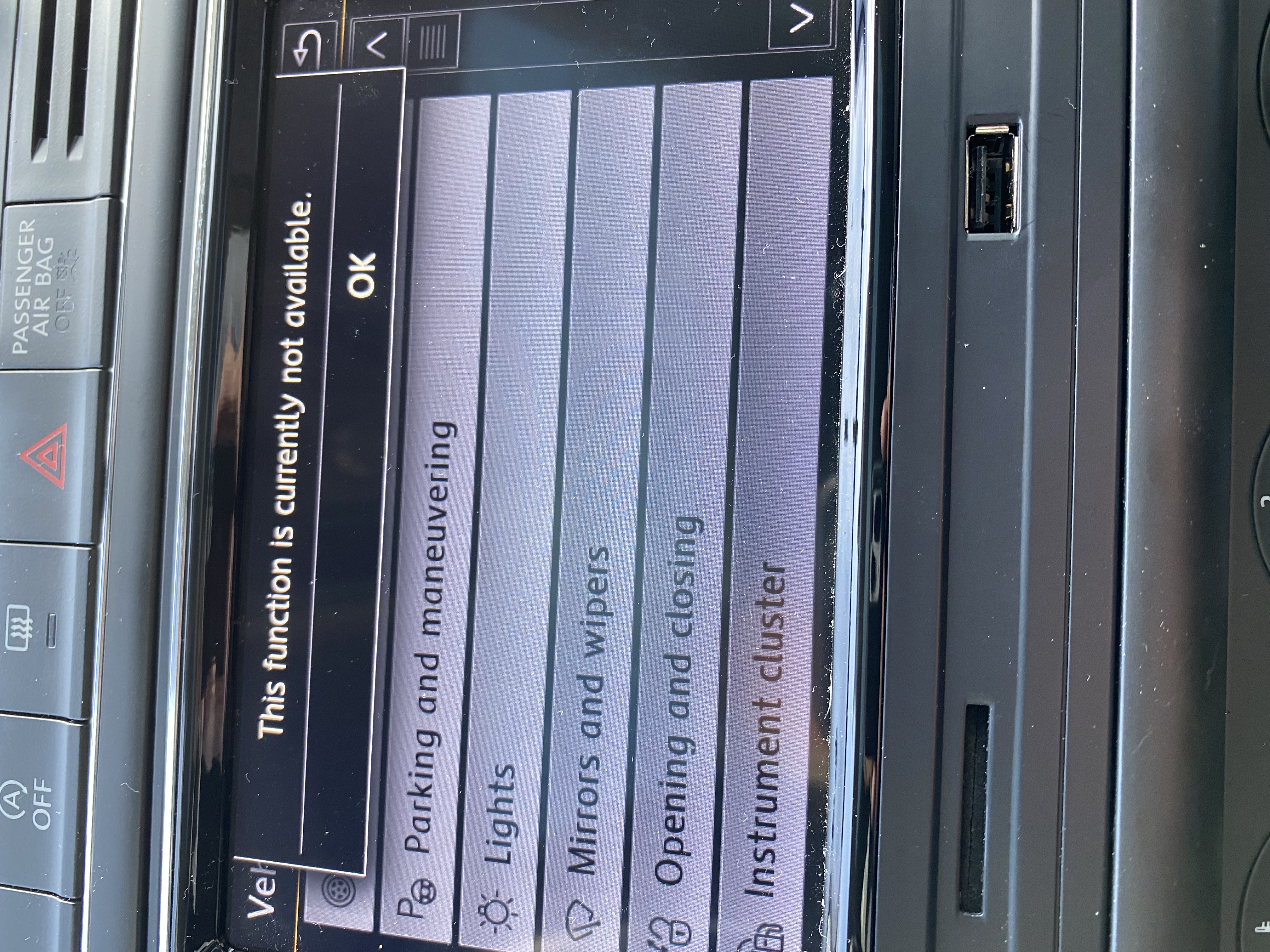

And how did you install the software to show up on the mib unit display?

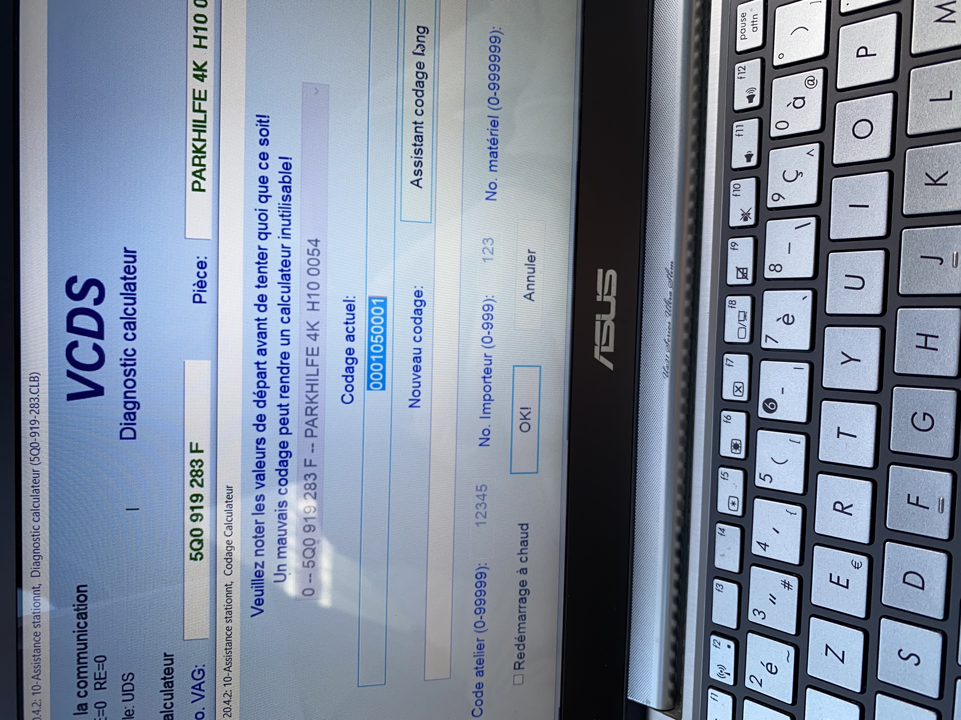

Hi to all,
I order to carsystem a 4K rear pdc radar kit (https://www.carsystems.eu/new-vw-polo-6 ... d1248.html)
I install but without success yet, :( i have some interrogation, expect you can help me. :wink:

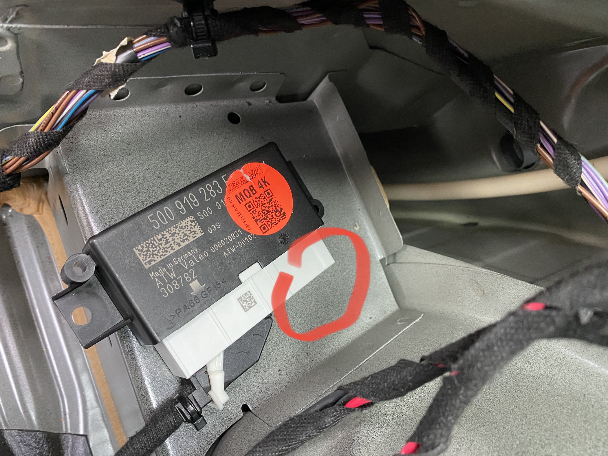

I didn’t receive any instruction for installation and coding, i ask carsystem, receive them by email but seeems to not fit with my car (Polo 6c tsi 2015 90cv)
First question is it normal that the module got only one wire on it ? The second is empty, i ask carsystem but no answer.. i didn’t find old module in the place (on back left)
For coding, they give me this
Address 19 (CANbus unit) -> Installation list -> 10 pdc [SELECT]
Address 10 coding according to the equipment of the car
PDC coding
5F Coding
Adaptation Channels
(11)-Car_Function_Adaptations_Gen2-menu_display_pdc change to Activated
(13)-Car_Function_Adaptations_Gen2-menu_display_pdc_over_threshold_high change to Activated
(19)-Car_Function_List_BAP_Gen2-parking_assist_0x0A change to Activated
(20)-Car_Function_List_BAP_Gen2-parking_assist_0x0A_msg_bus change to Terminal 15. (Not present in my choice)
(5)-Car_Function_List_CAN_Gen2-PDC_audio_lowering change to Available
(6)-Car_Function_List_CAN_Gen2-PDC_audio_lowering_msg_bus change to Suspension data bus (Not present in my choice)

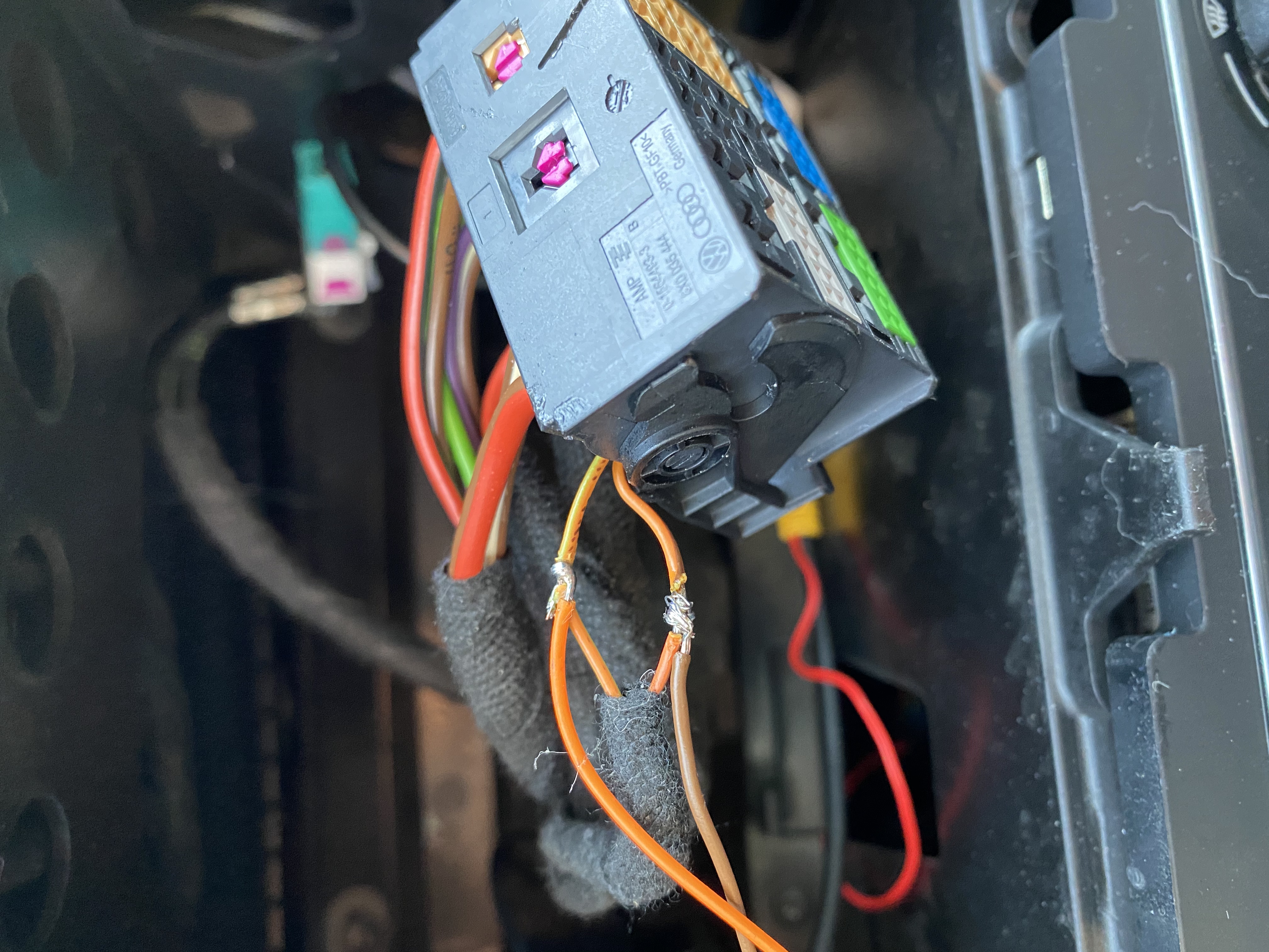

For can high and low i use the wiring of quadlock, is it good ?

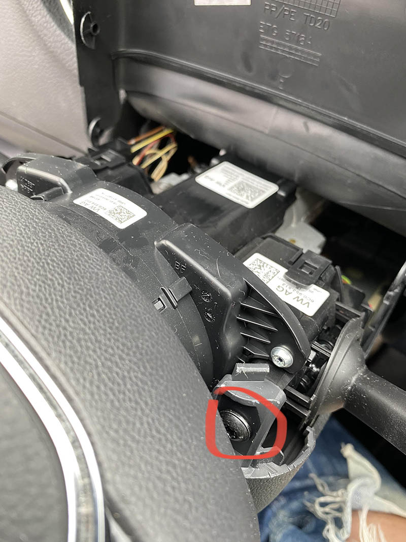

You must connect the PDC module to the powertrain CAN instead. I found it easier to tap the CAN lines from the power steering module, located near the steering column.

heftyshooly wrote: Tue Oct 26, 2021 9:27 pm You must connect the PDC module to the powertrain CAN instead. I found it easier to tap the CAN lines from the power steering module, located near the steering column.
Hi, are you sure it can't work from quadlock ? The PDC is correctly detected. Because i must remove steering wheel to access can lines it seems, i've got 2 screw behind :(
About the PDC, is it normal that i've got only one connector plugued ?
Yes.

Ok thanks, i'm trying to use can high/low from steering wheel so. And for my park module with a connector empty, normal ?
