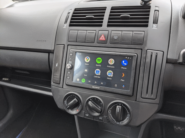

All working now, but I had some issues. The Connects2 CTSVW002.2 made a hissing noise on install then never produced a switched live (although saw other forum users had issues with it too so should've expected it). I've got a CTHUP-VW01 coming this week so hopefully that'll actually provide CAN BUS functionality. In the meantime I'm running a 'dumb' Quadlock to ISO harness of which I spliced the switched live into the permanent live.
However, for Android Auto I need to ground the parking brake sensor. Would it be okay to splice this into the ground of the adapter harness, rather than to a mounting point somewhere? I'm trying to work out whether there's any reason this would be a bad idea? I measured a ~3.1V difference between the parking brake and black ground cable (vs 12.5V between live and ground), but the parking break's only looking for a signal so shouldn't be providing any extra current which would overload the cable, right?

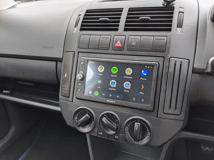

My Connects2 CTHUP-VW01 arrived and seems to be working well on my '07 9N3 (after reconnecting it once to get it to register). The handbrake wire on it works well with Android Auto too.
It has a couple of weird quirks in that connecting to Android Auto seems to cause dark mode to be auto-engaged, and unplugging the key doesn't auto-disable the switched live but requires manual powering off of the HU.
Great to have it all working now though. Very happy with the XAV-AX100 too (will edit with a pic tomorrow!)

Managed to sort out the auto-dark mode issue (kind of). Turns out the illumination wire is always on 12V even when the ignition's off. I'm presuming this is an issue with the Connects2 CAN BUS adapter, so I've just disconnected those wires for now but will get in touch with their support.SnoopyD wrote: Sun Jul 05, 2020 11:43 pm Great, good to know it's a viable option.
The HU still doesn't auto-turn off when the key's unplugged either. However, if I power it off manually via the HU then the switched live does recognise this and drops to 0V.

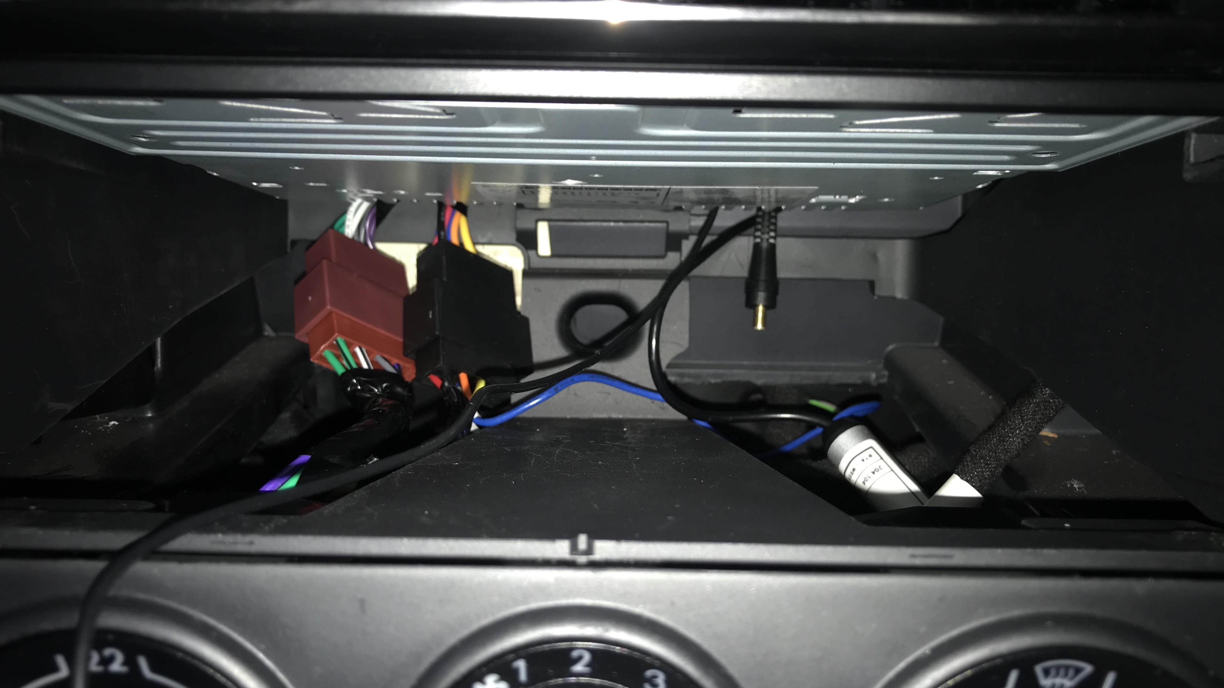

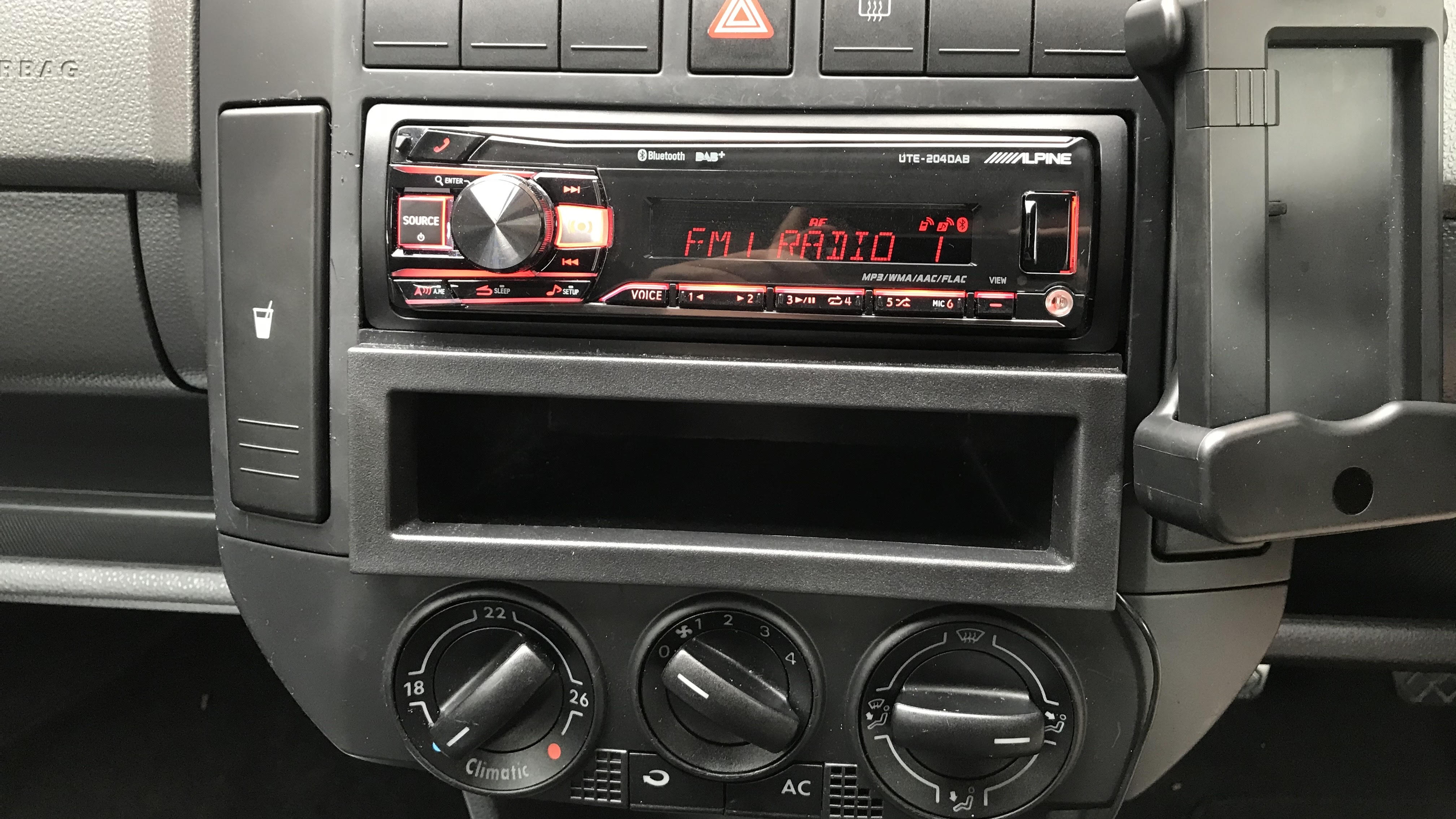

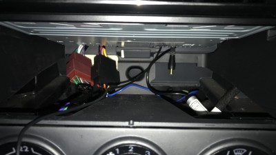

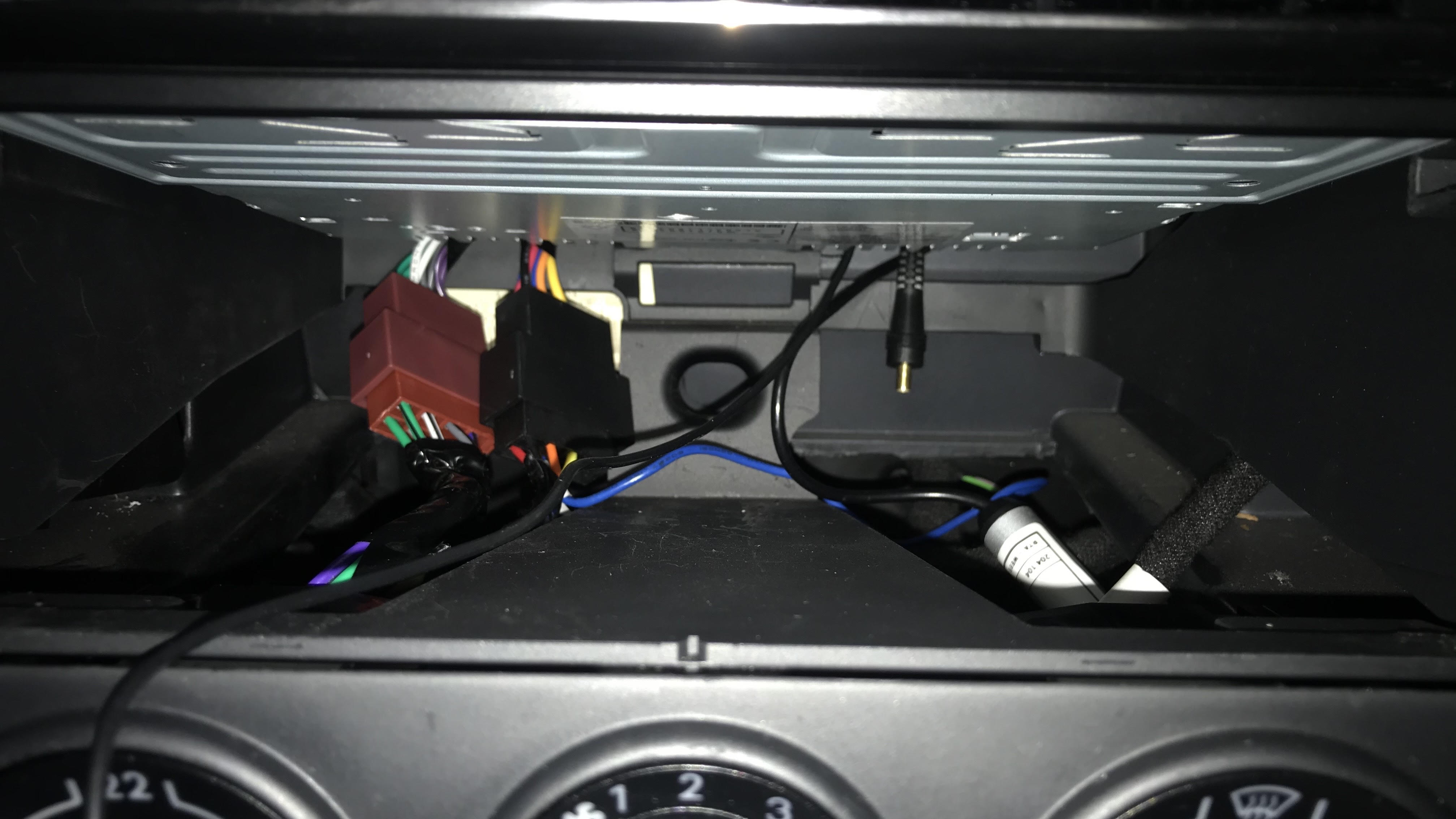

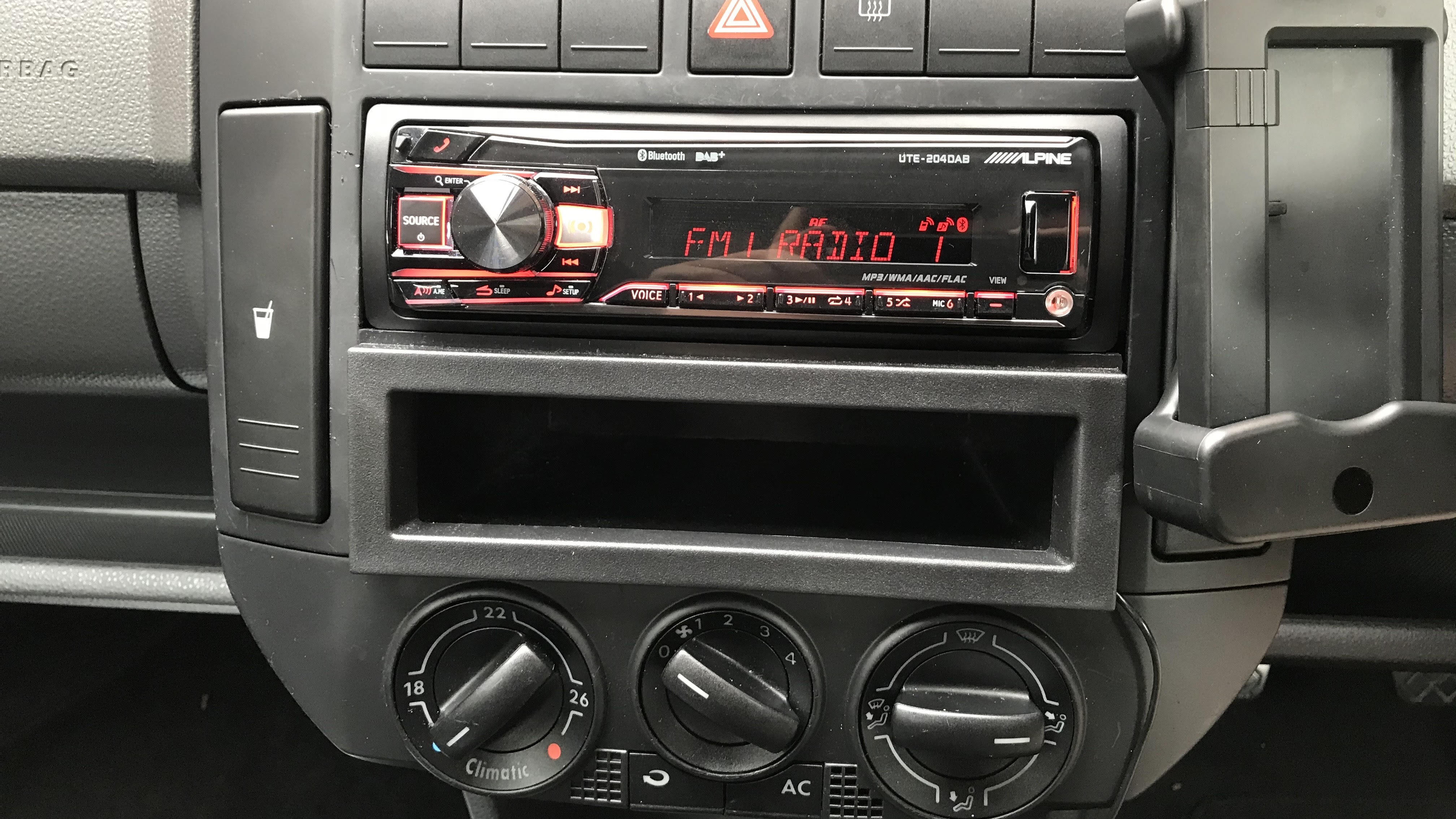

Just wanted to confirm that this adapter is essentially plug and play with an ISO to DIN adapter on single DIN radios.PugBrothers wrote: Mon Oct 28, 2019 9:56 am Also found this:
VW CAN-Bus Multimedia Interface for the Integration of Car Radios and Sat Navs for VW Golf - Passat - Touran - Jetta - Polo - Tiguan - Touareg - Sharan - Scirocco - T5 - Transporter https://www.amazon.co.uk/dp/B01N7W5TEE/ ... TDbE0ZT2CH
This sort of looks like it does everything and eliminates any need of soldering stuff / opening the fuse box and adding in any new bits - am I right in thinking if I just plug this in and hook it up the head unit will work?
Link to the ISO-DIN adapter I used: https://www.amazon.co.uk/gp/product/B00 ... UTF8&psc=1
Everything tucks in behind the climate controls quite nicely and with there being no cable operated temperature dial the quadlock connector and CAN bus box (if that's its name) fit down there. Arial also fits down the right side but routes easier if kept to the left side of the blower position selector cable.
