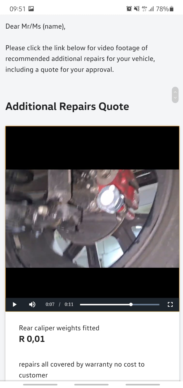

green justin
Posts: 143
Drives: 2019 Polo GTI
Location: South Africa
Re: Rear brake noise on reverse
Post by green justin »
Picture attached.
Trying to get the video.

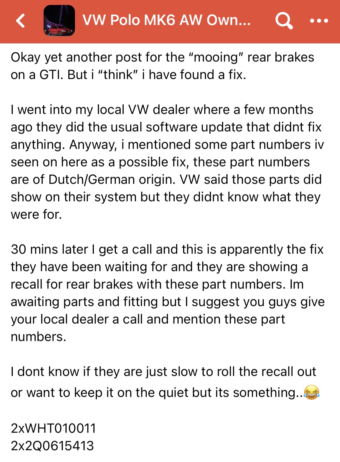

This was posted on the Polo owners Facebook page today. Just a heads up for anyone having the issue.
My car is booked in for a service next month so I’ll mention it to VW and hopefully this problem can finally be sorted...
Posts: 3848
The post on Facebook makes reference to a recall. Recalls tend to be for defects affecting a car’s safety, and all vehicles that are potentially affected get the fix as a matter of priority. The ‘mooing’ brakes don’t affect braking efficiency and so aren’t a safety issue so I doubt there’ll be a recall.
It’s more likely that this will be be dealt with as a service campaign action, so when cars are next at the dealership for other work (e.g. routine servicing) the fix is applied. It could be that the fix isn’t automatically applied to all GTI / GTI+‘s either, but only on those cars where the customer raises - or has raised - the mooing brakes issue with the dealer and / or has already had previous unsuccessful attempts to eliminate the mooing noise (e.g. software update).

Just spoken to the service department at my local VW dealership.
VW have issued a fix for the issue so mine will (hopefully) be getting sorted the same day it goes in for a service. :)
