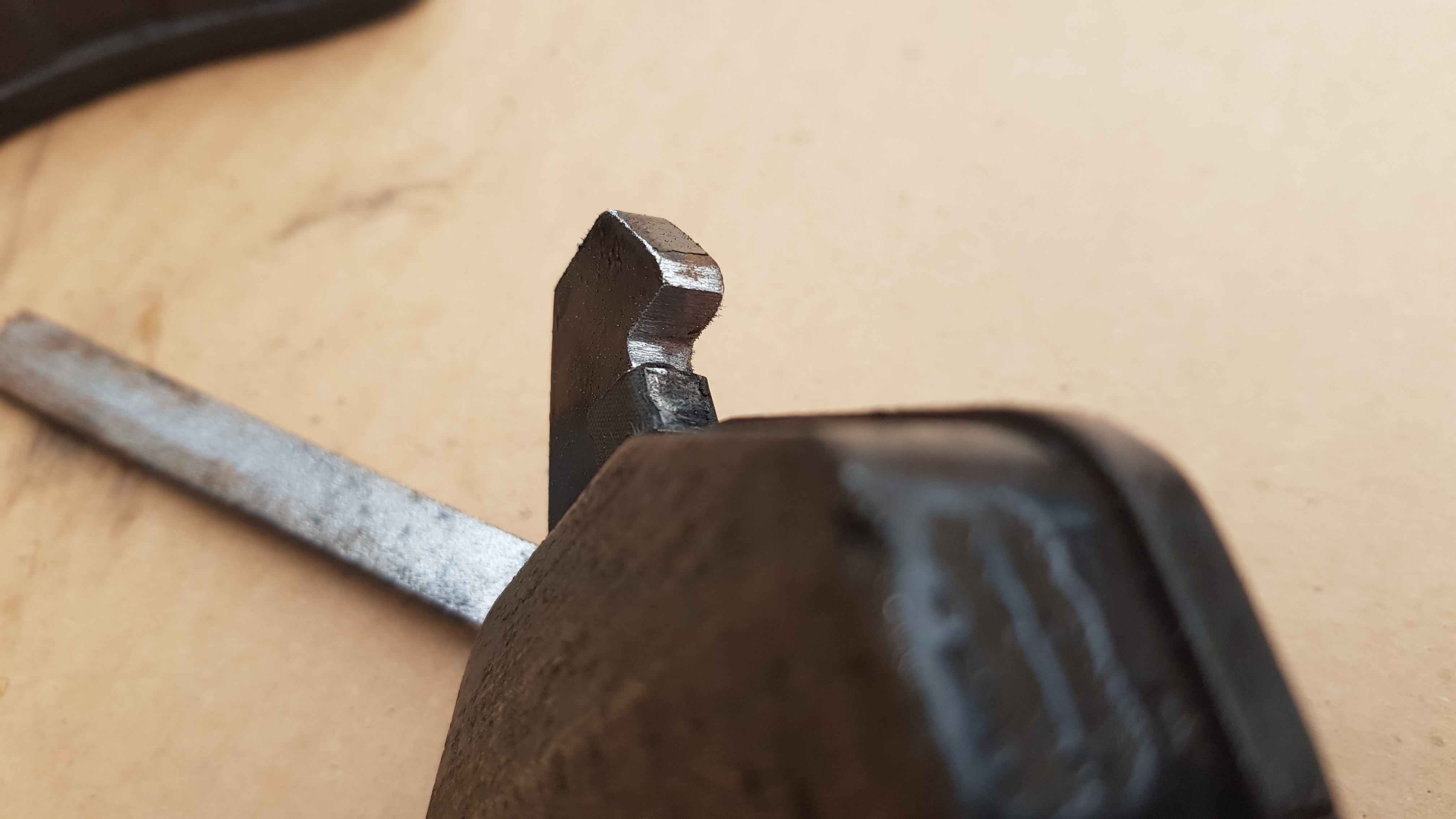

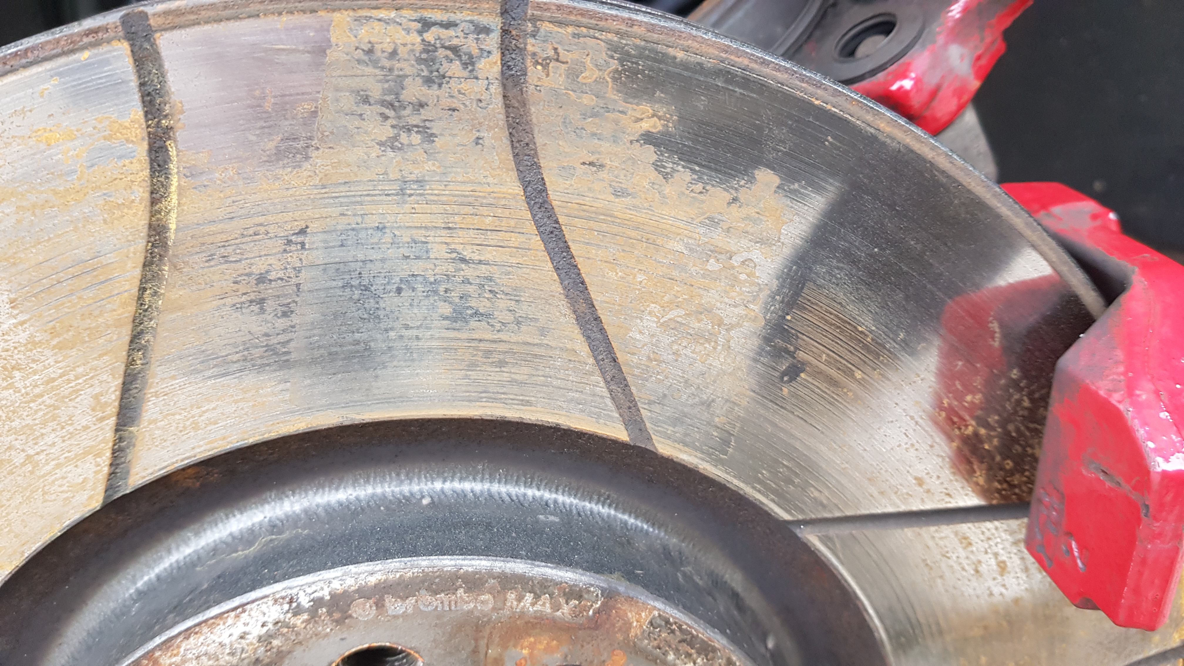

The rain stoped, so managed to get out and checked the pads added some wiggle room. Spinning the wheel did not hear anything strange but did take a pic of the saucers side. Was about to check the back but the rain came. So will do a good road test, and hard breaking 9 to 10 times tomorrow, if I did it today I'll prob get stopped, thinking im drunk, if seen.
The car has been sitting there 2-3 days in the rain why the Mark's on disc.

Yes I filled the pad down a bit, was the inner lips top an bottom, I did try to show in the pictures. So the pads now have wiggle room. And nice slide movement.

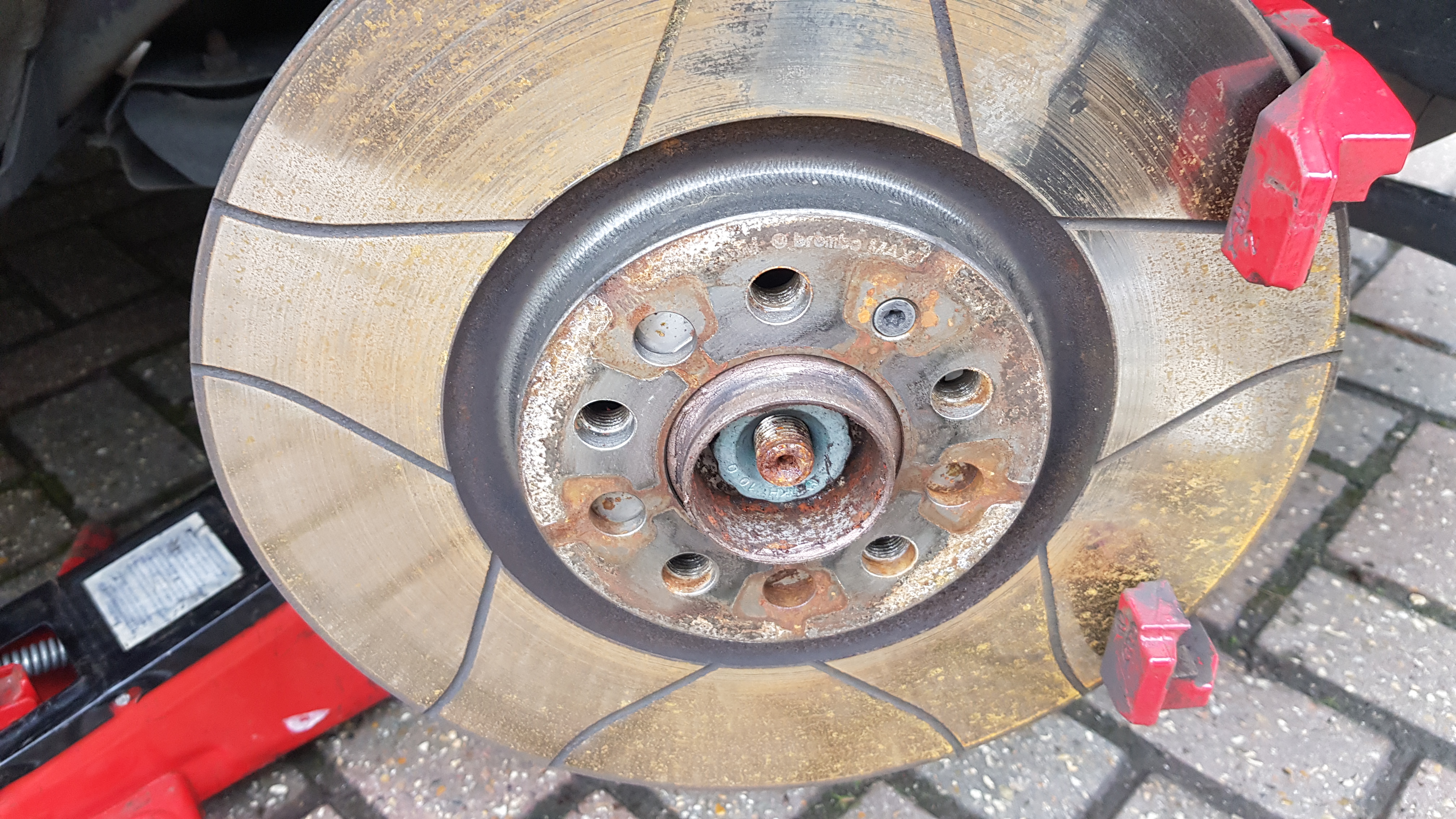

So the shaking is still there, I blanked off the rear breaks with a pipe clamp, still there, so I've taken the discs off and checked the hub to make sure it was clean, and flush, which it did look, also wire brushed etc, put back and hope it fixed, else will go tps get new front discs. The pads look like new still, so hoping there be ok to use on the new oem discs or should I replace the pads?

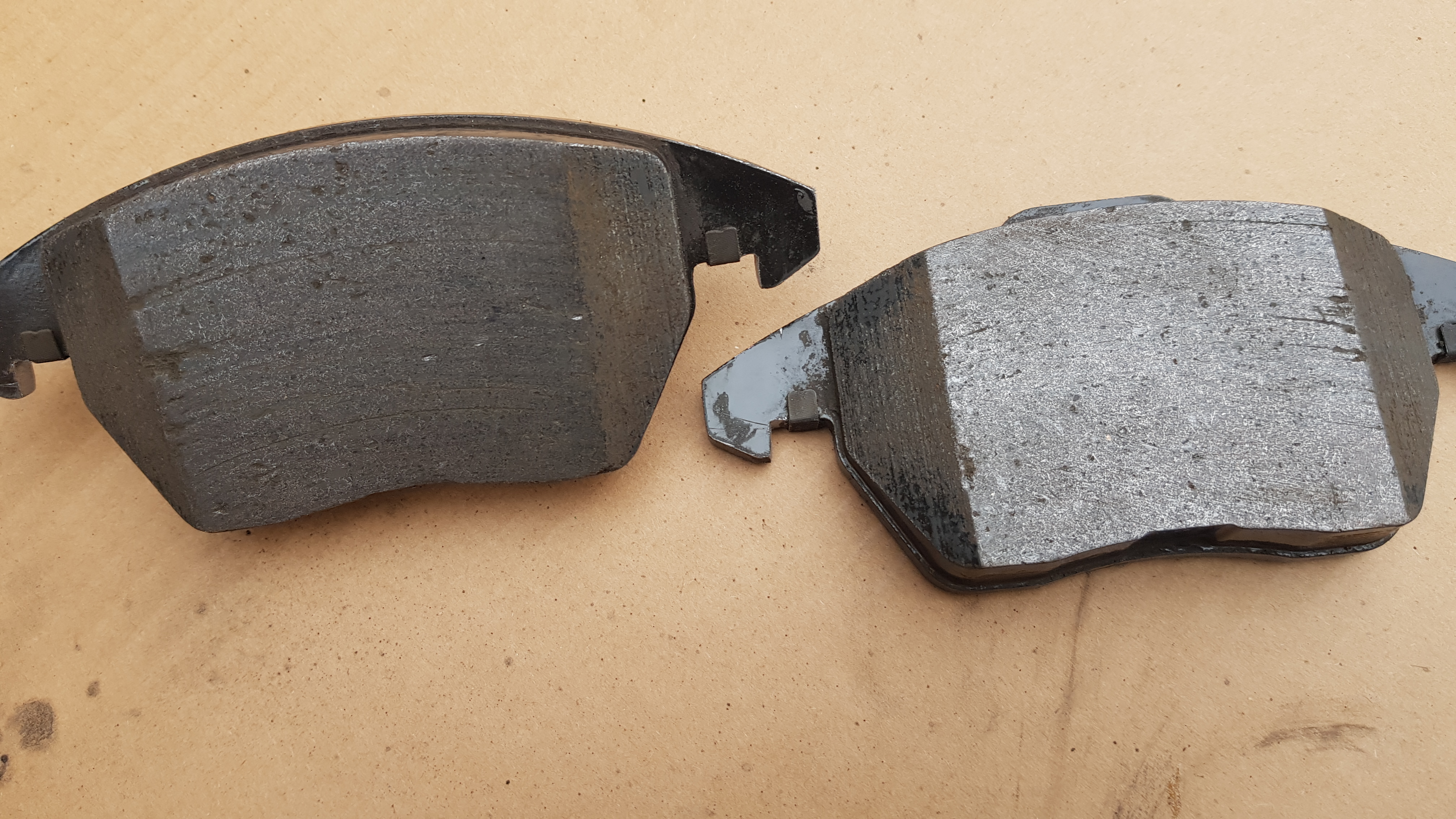

Will I be ok using the pads I have, was vw oem pads, not eco. with new discs, or should I replace? As may of over heated with the disc and pads sticking.

Its my partners car, and she drives it soft, never hard breaks unless she has to. I only use the car here and there, last 2-3 month, I drove it once, the other day, Just cant see why the discs went so bad from sticking over sized pads in the caliper.
Maybe the vw oem pad compound was a bad mix, with the brembo sport disc.

I doubt the brake pads would cause a vibration, you would head some noise for sure - meaning the pads dont sit flat against the rotor. But your wear on dics looks completely normal

So just get oem discs use same pads, just file down the edges a bit. If the judder is still there after that, I will take it to VW, as its still under extended warranty. Guessing will be the hub.

After taking the discs off cleaning the hub and disc hub back, it seems to of stoped the judder, so she has said, still early to tell. surprising tho as the hub etc looked clean, yet only takes a small bit of rust or grit, could of fallen as I tock apart. Fingers crossed, will know Sunday for sure, I will be doing 100-150 miles in her, and the car. Lol
