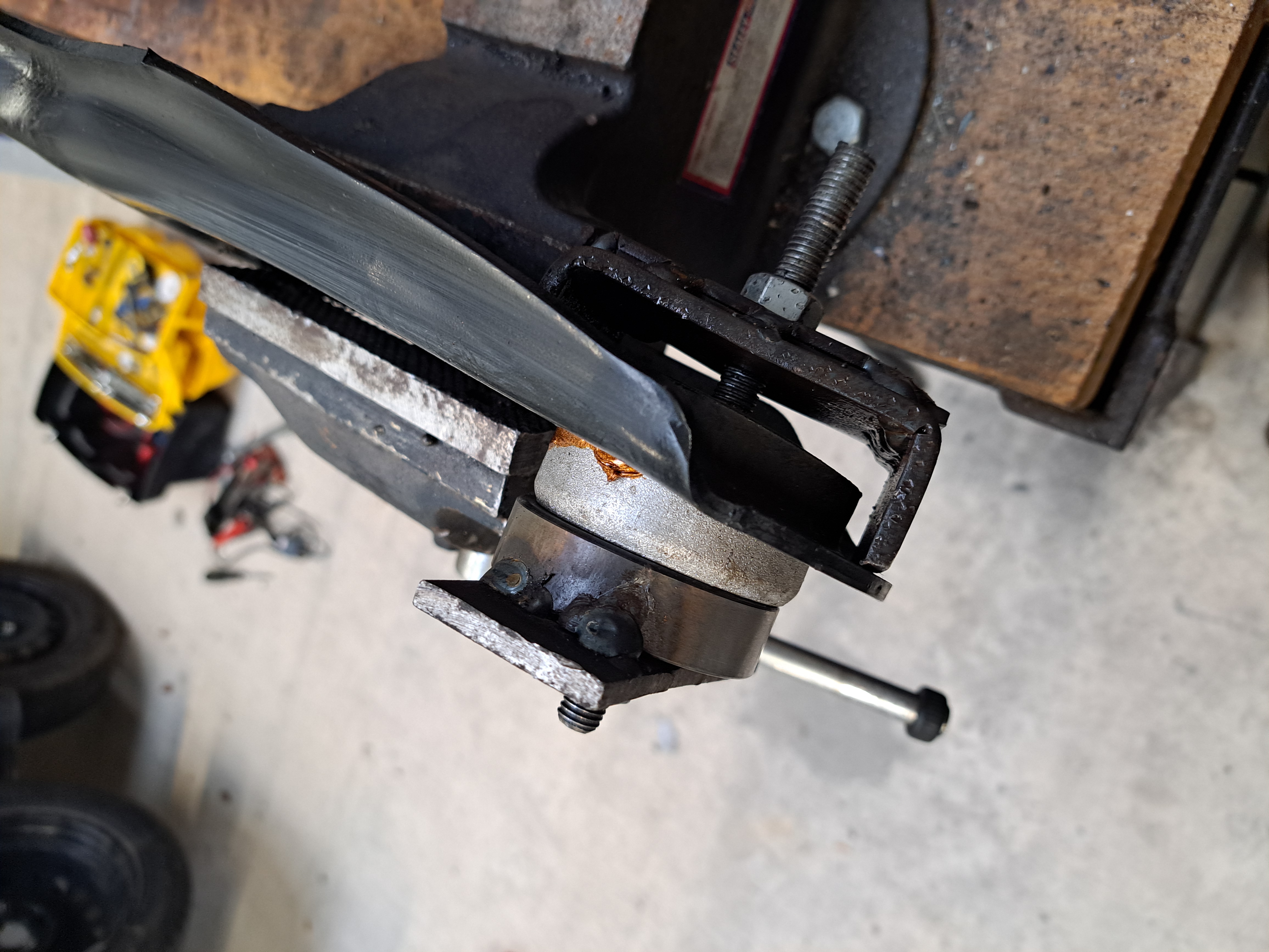

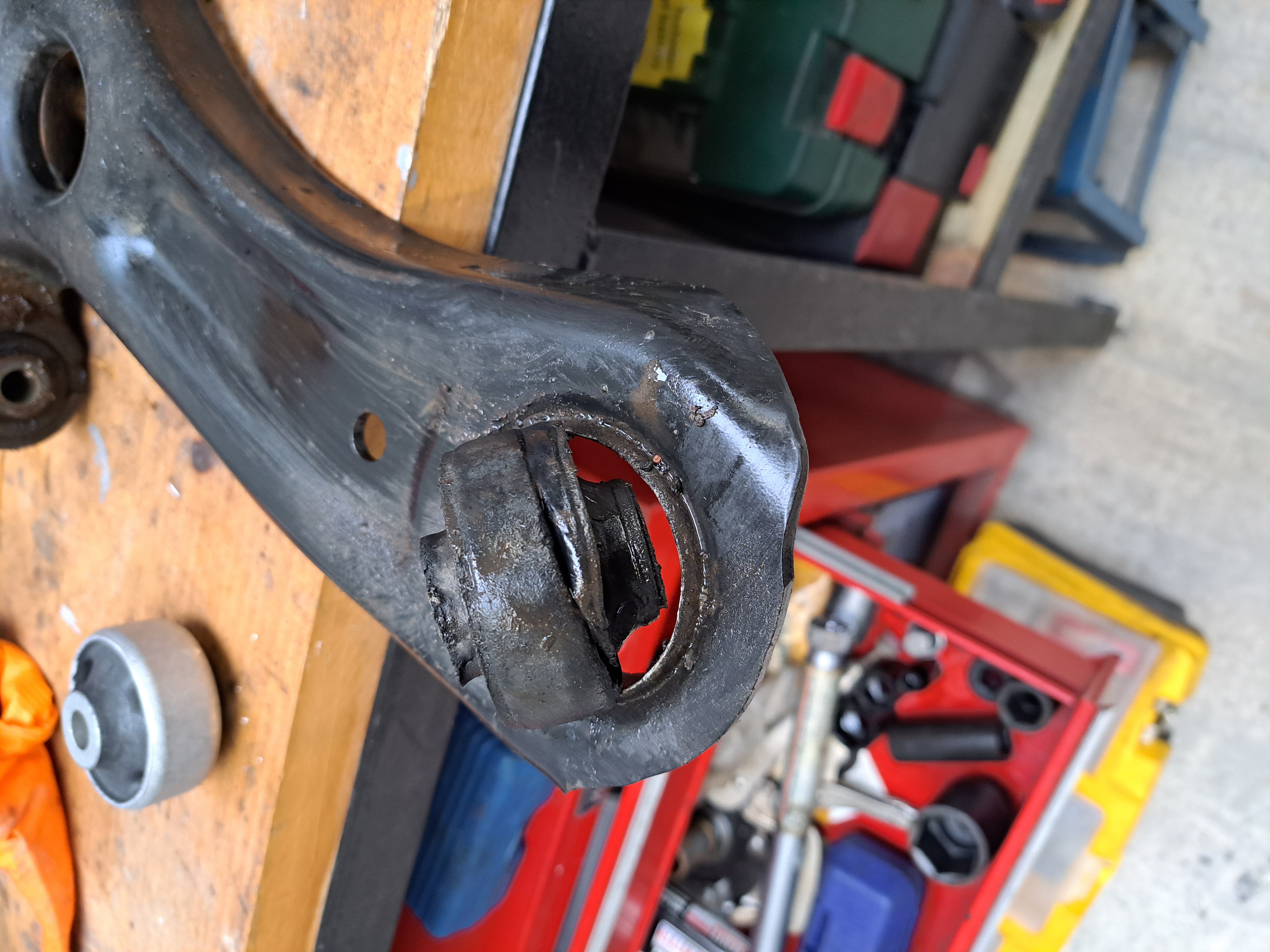

Did these bushes today. Used the solid Audi TT type.
Old ones were in bad state, especially drivers side on which the rubber was almost totally detached from the metal ring. With the arm out of the car I was able to remove the rubber by hand!. :shock:

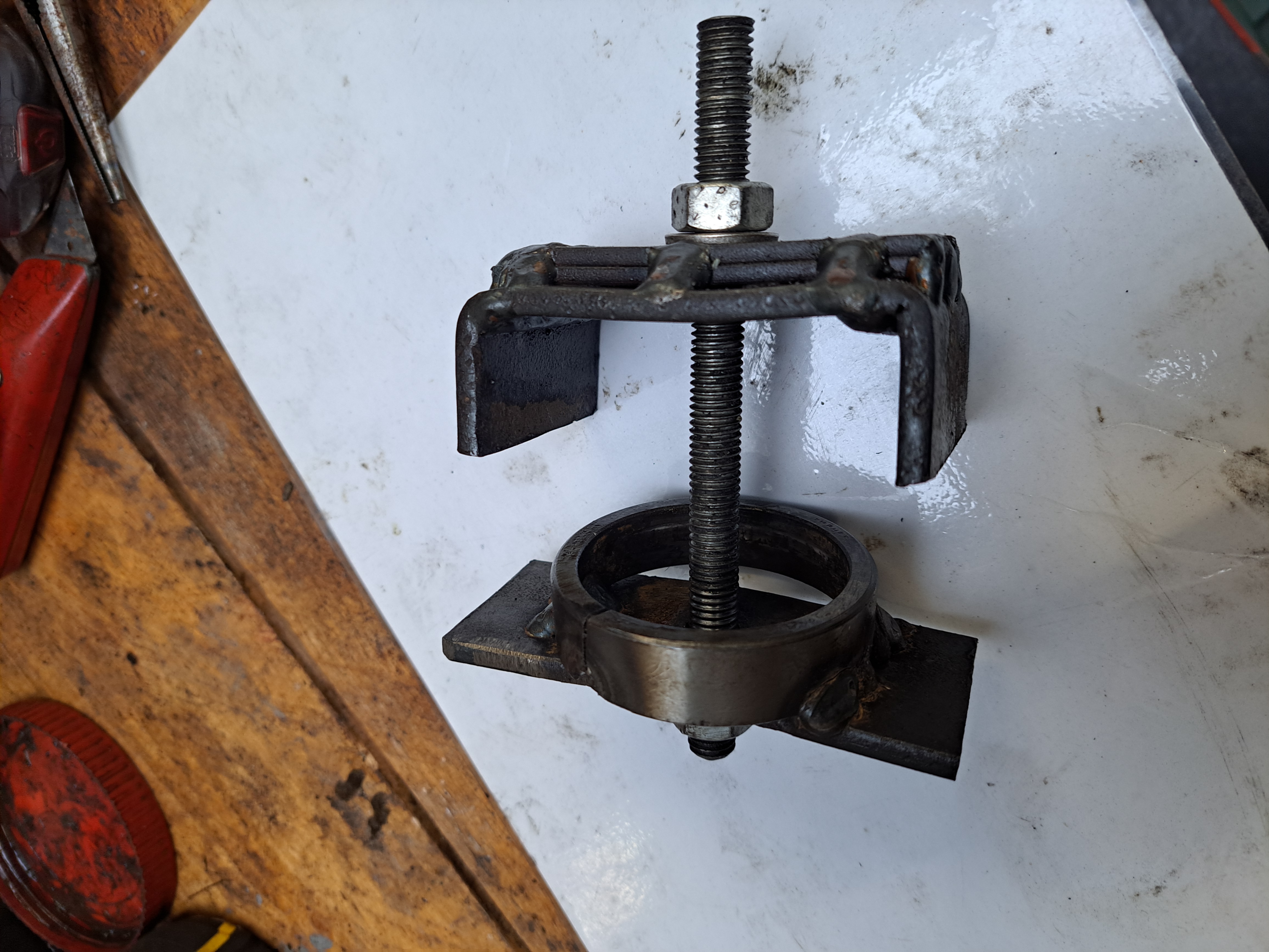

Didn't have a bush removal or fitting tool but made one with flat steel, threaded rod and an old bearing outer race with help of the mig welder. Hopefully that will have cured the suspension clunk from the drivers side.

Thanks. Images added.
Didn't actually drive it after I finished but its gonna be a big improvement given the state of the old ones.
Re: Control-arm bushing
Posted: Sun Jan 22, 2023 7:15 pm
by amer6R
Love the tool, thumbs up

Once you aqquire the tool, or make it next time its faster and easier to do.

Good DIYer tool though, good to see somewhere to use up the Copper Grease! I must have the original VW Group assembly grease that was provided to assist in pressing aluminium sheathed/skinned bushes into aluminium consoles - so that should work okay for helping to press these Audi Mk TT bushes into the steel lower arms - if and when the time comes on my wife's 2015 Polo 1.2TSI.
