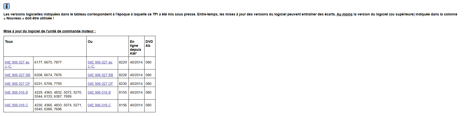

Then I went to ETKA with my VIN:
Guess what I found:

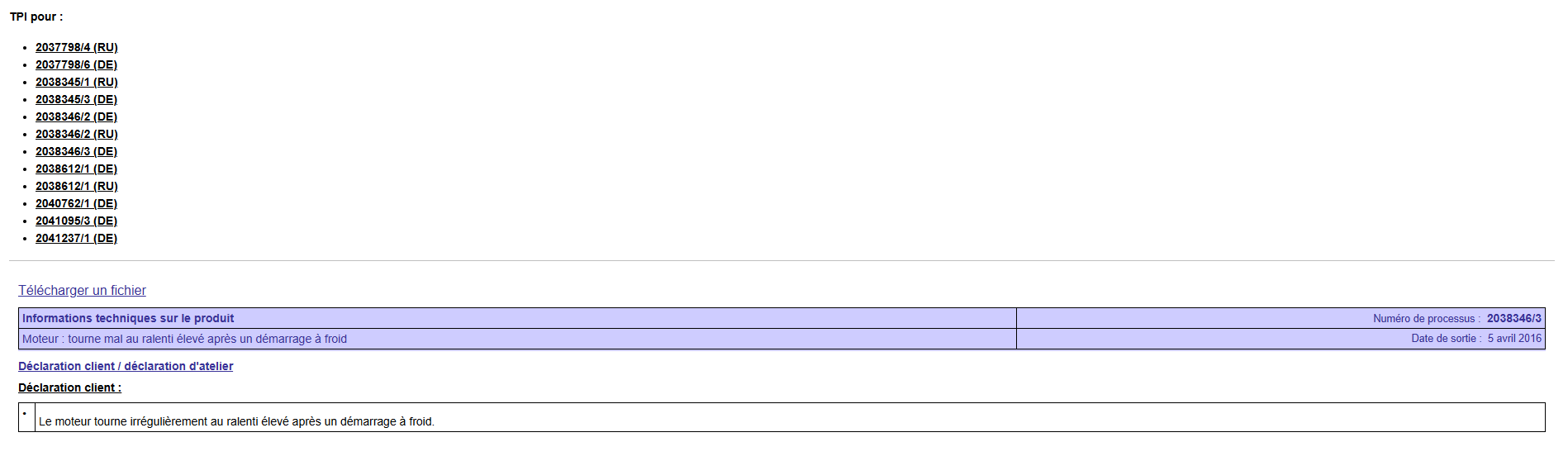

First: Many update for my ECU are existing and mine is old as fu** When a list of TPI (or Service Bulletin): And yup "Le moteur tourne irrégulièrement au ralenti élevé après un démarrage à froid" means "the engine runs irregularly at high idle after a cold start."
So I think I found my issue.
And yeah, my ECU is concerned by the update as we can see on the table:

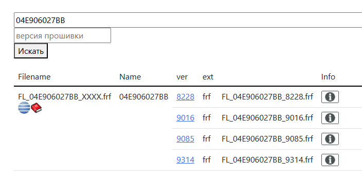

- Posts: 8959
Re: Cold weather, engine runing rough
I have the files in case you need them for any reason. Free, of course.

- Posts: 8959
You only need ODIS or VCP. ... or other similar tools.
There is no black magic to flash these units with the 'original' files, so no special skills are required, just knowing how to click with the mouse or touch the screen...
easy, no fear.
I think the advantage of having these files is that for example now in winter you can test each of the available files and thus know which one best suits your engine for those conditions, your specific conditions.
The logical thing would be to start loading the latest update (_9314).

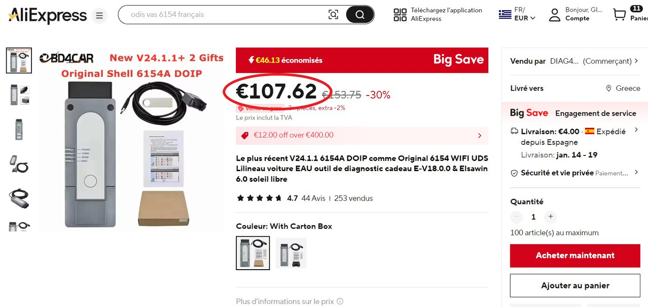

giannis20vt
- Posts: 425
- Location: Greece
Hello,
i am at the same point, in fact i just bought this item. It's the same item
I saw that there is a price difference between your screenshot and mine
The price at my case is 107euros, but at your photo is less, 97euros. Why is this happening ?
- Posts: 8959
China has long been technologically ahead of many other places... I'll stop talking here so no one gets offended.Le_Combattant wrote: Thu Jan 09, 2025 7:13 am
I'm might be a boomer since the begening I never trust so much Aliexpress.
But China seems very in advance in terme of copying.
Maybe I should give them a try ?
Do you think they are true device with no brand on them ?
China has long been selling all kinds of quality.
In China they are now able to surpass the best quality of any product.
There are copies that are better than the originals. 'MUCH better'.
What is authentic? This now depends on how you interpret it.
If an electric Audi (80.000 - 100.000) has the best batteries in the world, MADE in China, is this Audi a s**t copy?
Urban legends continue because everyone wants to buy cheap or free, and China does not oppose this bad habit...
Copying in China is like a religious or spiritual act for them.
Shipping cost... you have to improve the habit of comparing appropriately.giannis20vt wrote: Thu Jan 09, 2025 7:35 am
