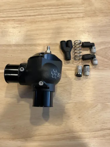

Regarding the intake, I randomly purchased a blow-off/recirculation valve last year for a very good price.
It's a Synapse Engineering diverter valve. I think it's a pull type valve. The response on it is seriously rapid.
The interesting thing with it is it runs partially open under vacuum. This sort of shortens the intake which in theory could improve throttle response a little.

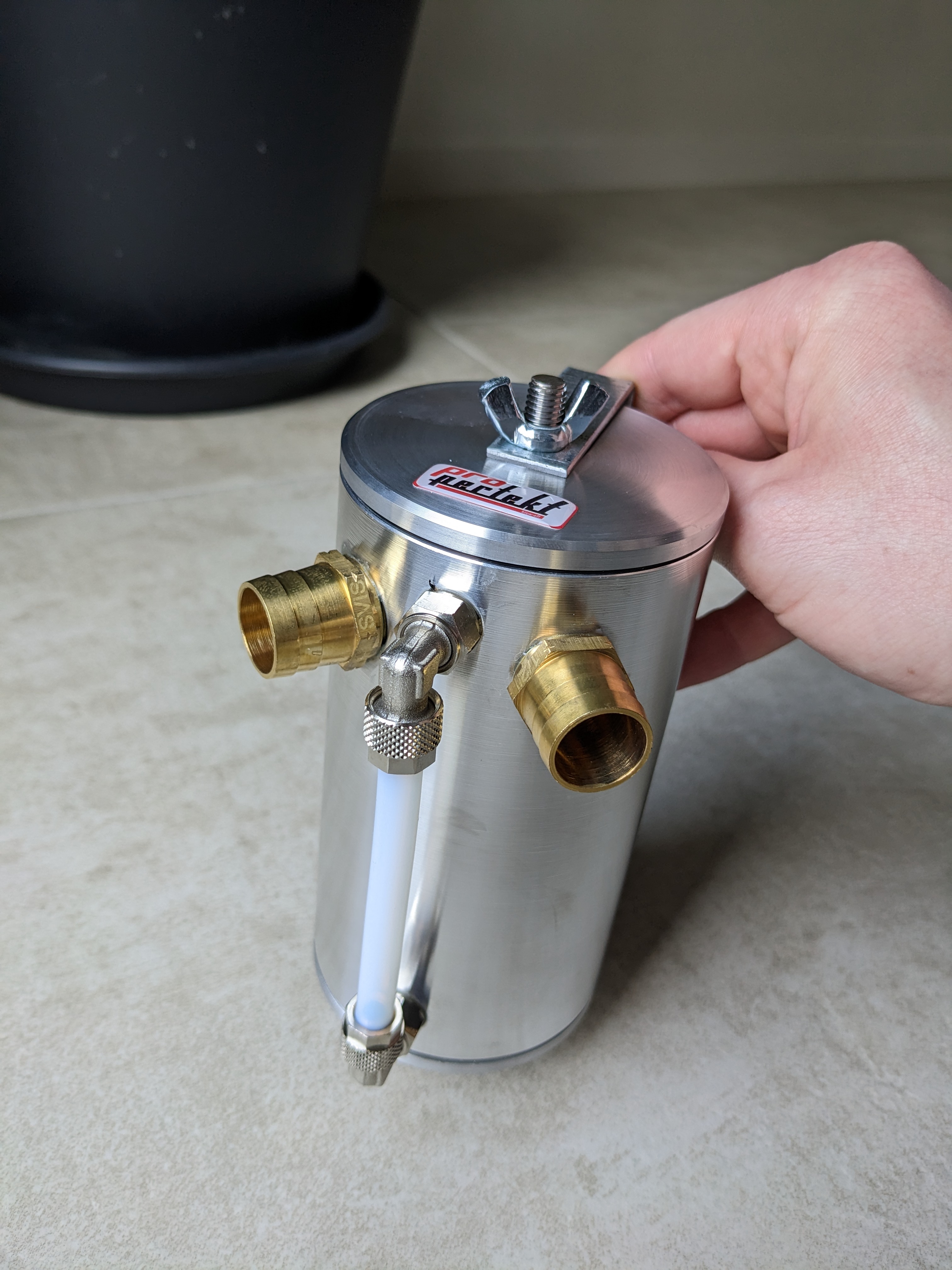

This is the catch can I bought.
Not the chiness product from Amazon or whatever: It's a Polish Product.
PXL_20240307_095610590 (1).jpg (2.04 MiB) Viewed 5577 times
Inlet/Outlet: 20mm

wow... that is nice. Shiney! :)
What's the internal baffling like?

2226 wrote: Fri Mar 08, 2024 6:47 pm wow... that is nice. Shiney! :)
Here is the official website with all nice pictures ;)
https://blow-off.pl/oct-seprarator-odmy ... perfekt-eu

That looks good and a good price too.

Yeah, but because it's "hand made" I had to perform some adjustement :roll:

I have to rework/adjust the catch can support because it's pretty heavy (800 grammes).

It looks like a solid chunk of metal.

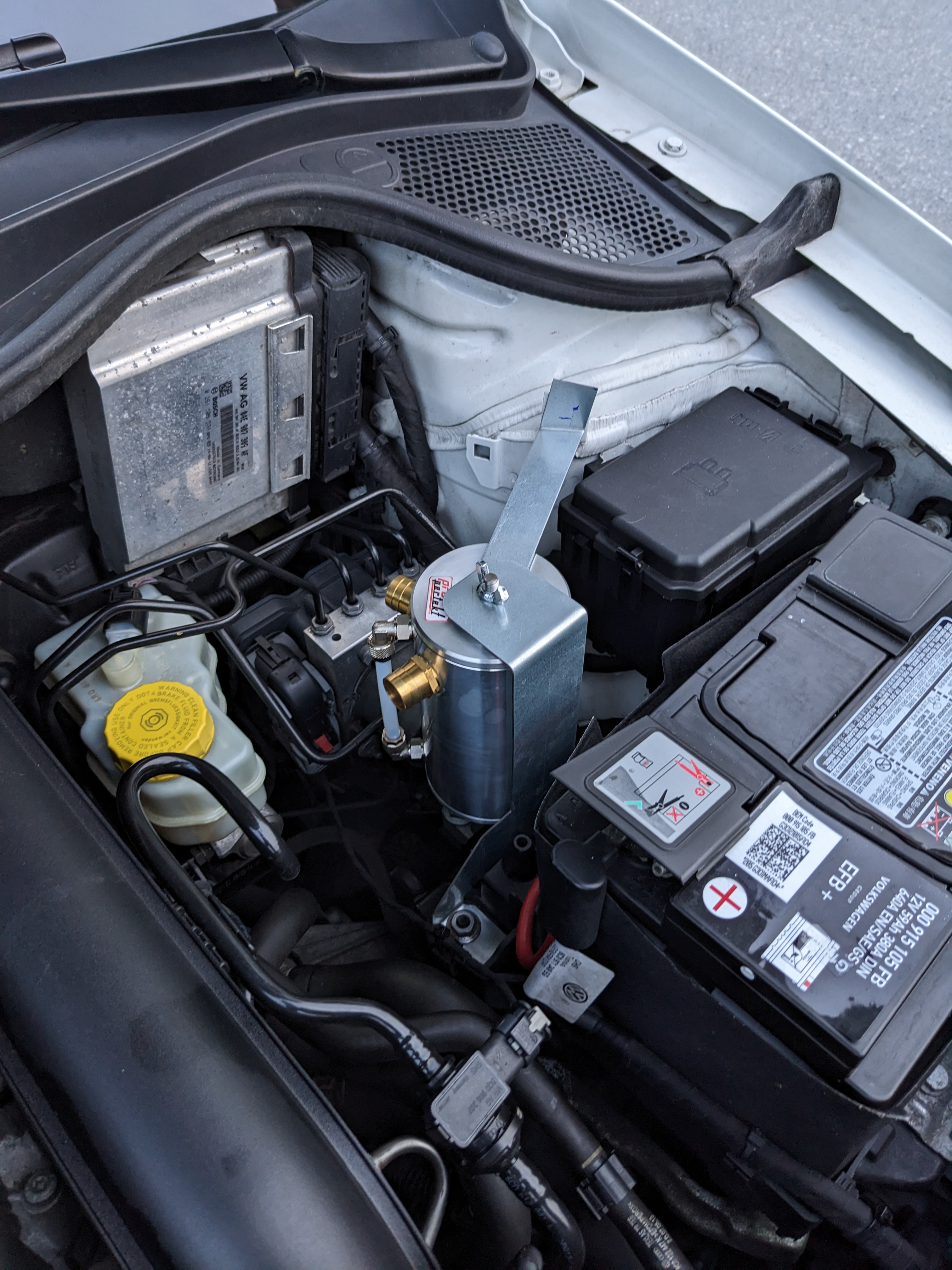

Have you figured a spot to mount it? Looks fairly long.

2226 wrote: Sat Mar 09, 2024 6:09 pm It looks like a solid chunk of metal.

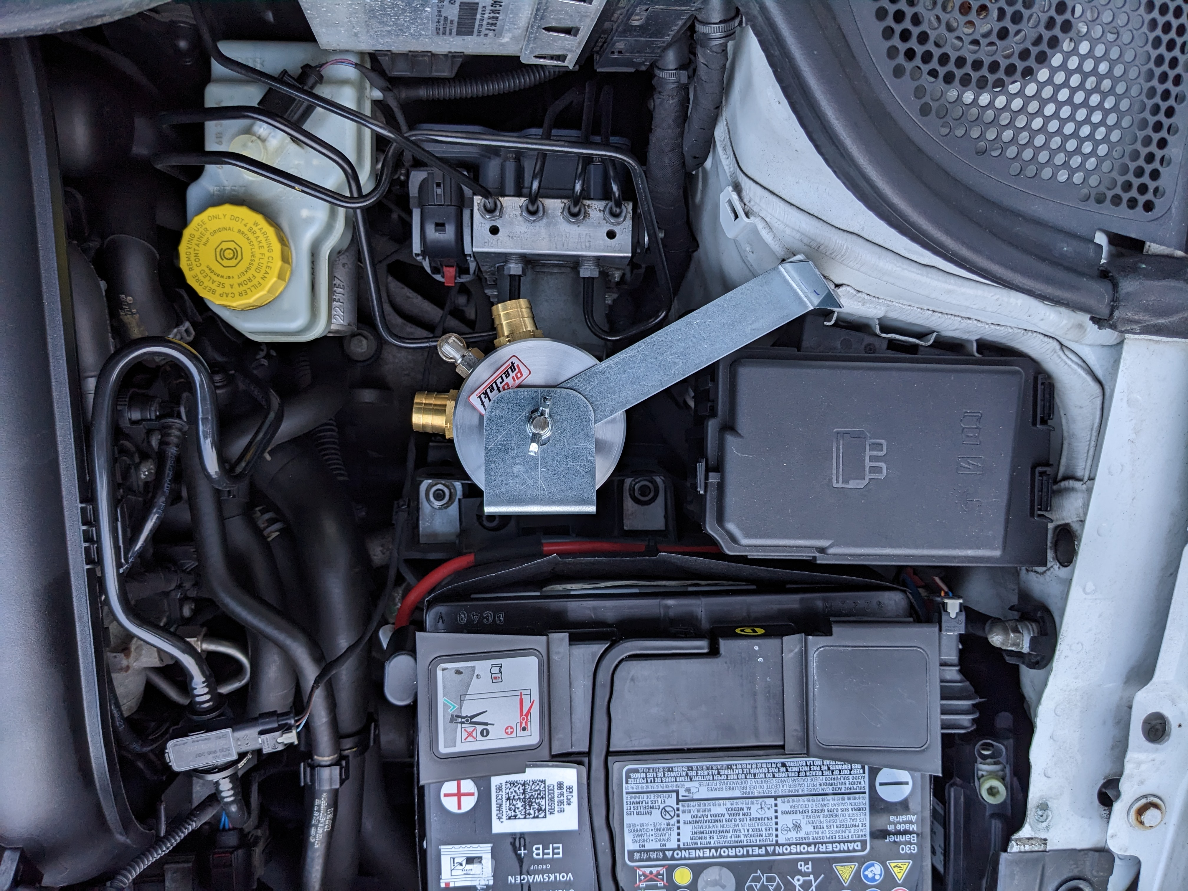

Over geaborx, I will use the two nut using to bolt the battery support to gearbox mount. Pictures tomorrow.

Photos !
2226
Posts: 561
Re: EA211 Oil Catch can
Post by 2226 »
Looking good.
Perfect open mounting tab location.

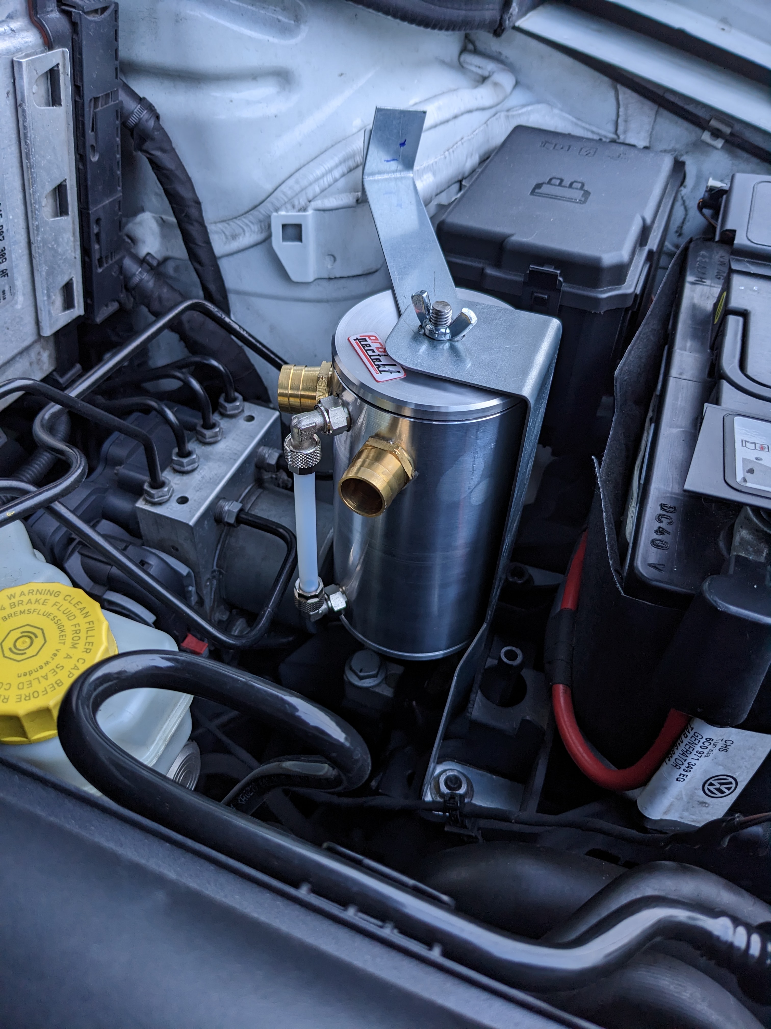

Le_Combattant
Posts: 514
Location: France
Post by Le_Combattant »
Thanks, but I have to found how to fit correctly hose. And it's quite hard.
Silicon, impossible: they are not designed for oil/fuel vapours.
Nitril hose, yes, but they are thick and it's hard to fit them in a small space. And I don't want to creat to much stress on parts.
