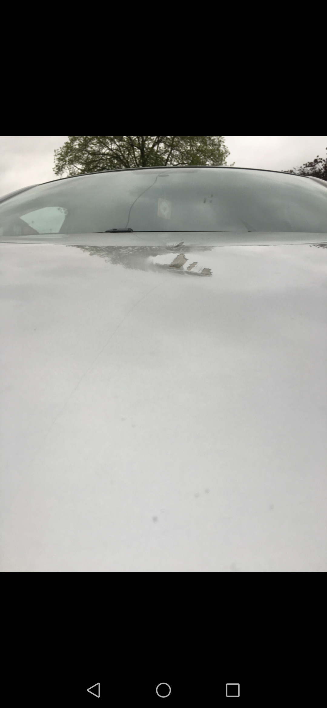

Hi, hoping someone can help me.
Does anyone have a part number for a bonnet?
I believe it is 6R it's a 2016 match edition 1.2 TSI DSG.
I'm not even sure on that but the vin starts with WVWZZZ6R
I was driving and what looked like a brick flicked up from the middle of the road and ruined the bonnet, bounced off and hit the windscreen :shock: didn't go through but took a chunk out of both.

A 2016 Polo will be a 6c, although the part no. will start 6r as the 6c is the facelift version of the original 6r Polo, and both the 6r and 6c use the same metal body panels.
A quick Google search turned up the part no. for the bonnet as 6R0823031A. Might also be worth trying breakers yards near to you as they may have undamaged used bonnets from cars that suffered rear end damage; you might also be able to locate one off a Pure White Polo, which would save on getting it painted.

That's brilliant thank you :)
