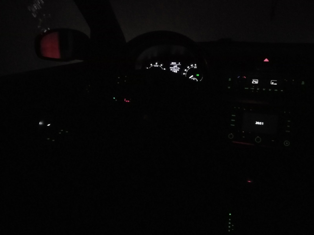

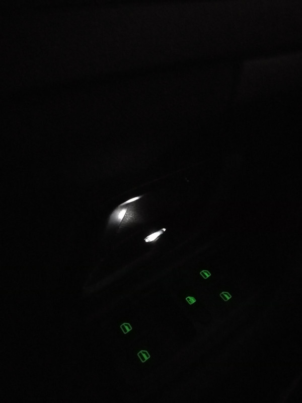

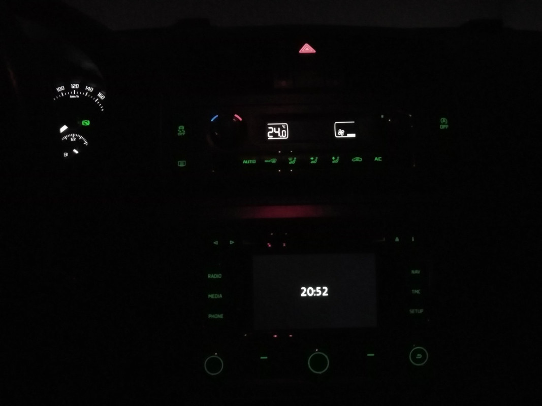

Re: Auto lights retrofit
Hello Fernando , tell me please can i use the same foot lights as ambient lights ?
Is there any difference in wiring ? You have all ready make for me wire for ambient lights .
Best regards
Vasilis
Best regards
Vasilis
VASILEIOS1972
- Posts: 182
- Joined: Tue Feb 12, 2019 2:53 pm
- Drives: Polo 6R 1.2 tsi , Skoda Fabia 5J Vrs 1.4
- Location: Greece
- Posts: 8907
Re: Skoda Fabia VRS 2012. Auto lights retrofit OEM
Thank you for sharing the images of your new ambient lights, however you have the same problem as me, your camera does not capture your new ambient lights with sufficient clarity.
My white ambient lights are perfect (IMHO), with perfect lighting for driving (no-strident). I guess the same thing will happen to you.
