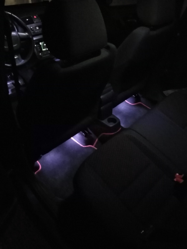

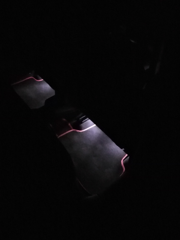

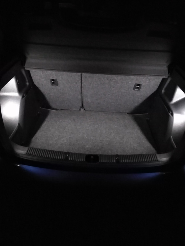

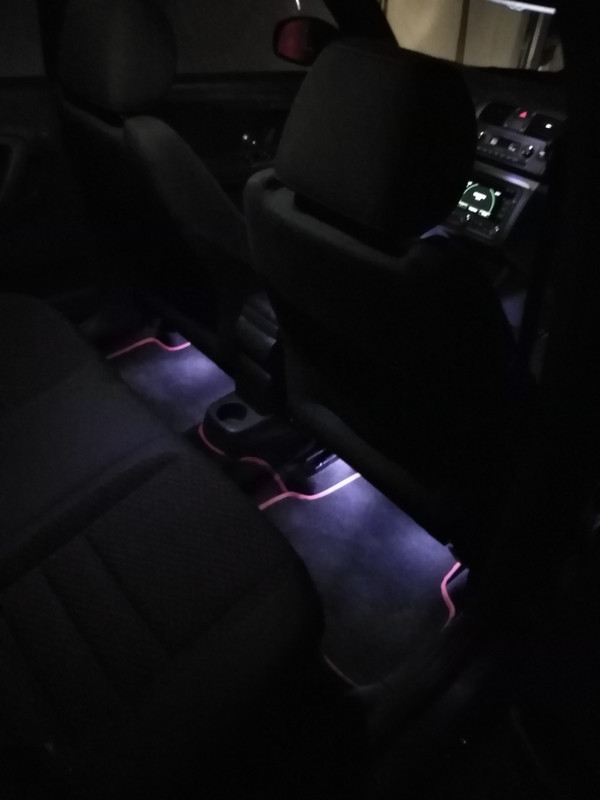

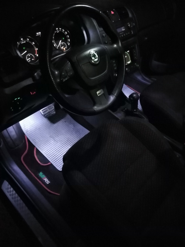

Posted: Fri May 01, 2020 6:51 am
by VASILEIOS1972
Hello everybody and especially my friend Fernando , foot lights retrofit completed yesterday. I have install second trunk light and the thinks became better .
Photos above
best regards
Vasilis
