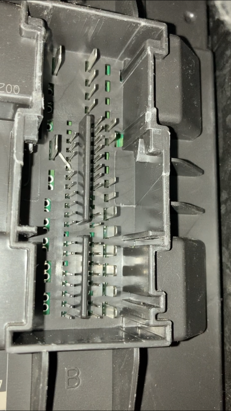

Today I have installed on my 2010 1.6CRTDI polo a CCS kit. Used VCDS to code in aaaaand not working. Triple checked every connection from lever to BCM and the codes in ECU and BCM as well.
The buttons on the lever works fine I have checked it with a digital multimeter.
Checked the buttons with VCDS in measuring blocks on address 09. Every button work properly exept CANCEL. The value of 4-2 is not changing regarding its position. And I think this prevent me to turn on the CCS.
What can I do? Anybody faced with same issue?
Thanks,
Adam.

hepike wrote: Sat Apr 10, 2021 12:02 am Hi,
Thanks,
Adam.
The main switch shows when it's on or off? It might be a problem on switch ON/CNL/OFF
Posted: Sat Apr 10, 2021 8:32 am
by hepike
Matmaz wrote: Sat Apr 10, 2021 1:27 am
Thanks,
Adam.
Yes, the car register on/off state correctly. Both ecu and bcm. And also the switch works properly: on cancel line normali there is 12V after i turn on the lever. Then if i push the switch to cancel state the voltage deop to 0V on cancel line. If I release the rocker 12V comes back. Checked its wire through the bcm and looks fine, passed the continuity test.

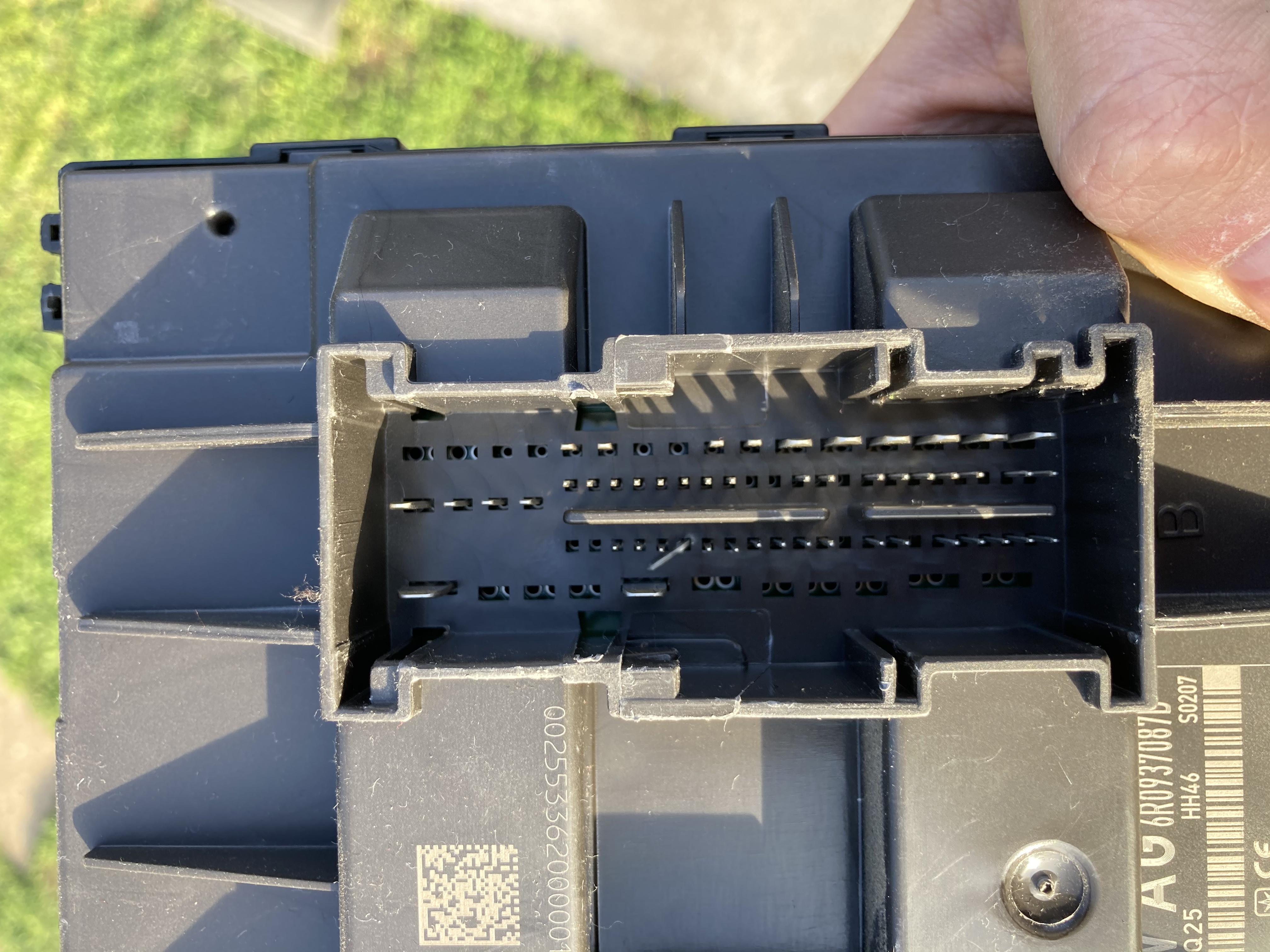

I have sorted the issue out. The problem was the pin 47 of the BCM. The pin was bent. I have fixed and it started to work.
