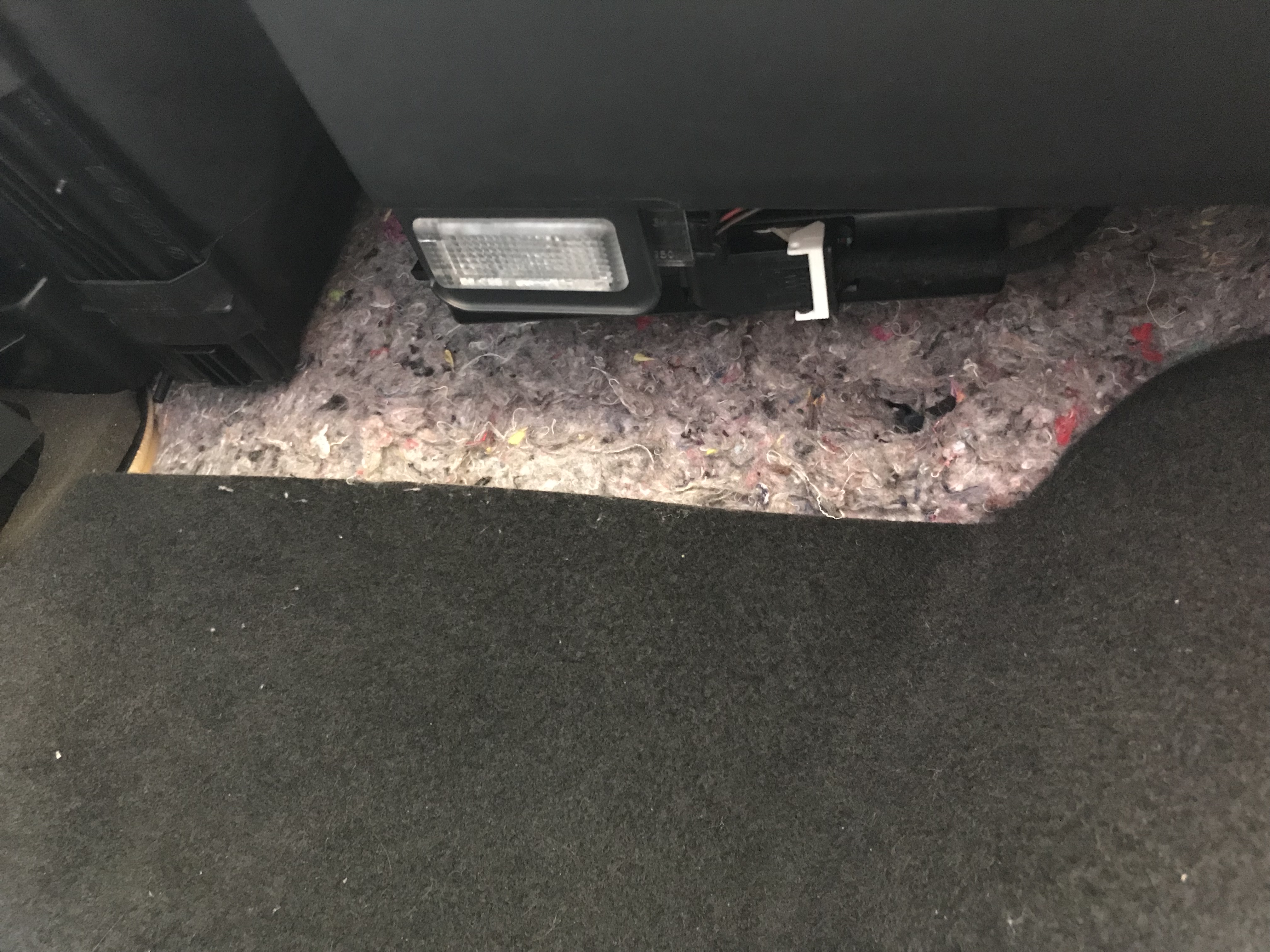

cheba wrote: Mon Sep 10, 2018 7:53 pm Since I will hopefully be installing a Bluetooth module in my Polo, where did you install your module? I guess that in the Polo there's no space under the passenger seat for the foam piece that is used in other models. Also on photos of Bluetooth modules originating from a 6R, they have 2 strips of velcro on the underside so I assume they were just stuck to the floor without a holder. Or did you find space for the module in a different location?
I installed a bluetooth module recently as well and I was unable to place it under the passenger seat because of the drawers located under the (highline, sport) seats.
I tried to place the module behind the radio, but didn't suit. Tried it upon the glovebox, didn't suit as well... so I then placed it above the footwell light of the passenger and attached it with 2 tie wraps. Think this was my best bet. Luckily, it's easy now to disconnect the wire haha. I can send you some pictures if you want.

cheba wrote: Mon Sep 10, 2018 10:22 pm Sure, I'd love to see some pics. It's always good to see different people's solution, even though I'm leaning towards fitting mine under the seat (in order to keep it as "OEM style" as possible).
Sure, wanted to do it the OEM way too but not possible unfortunately as said before. But here are some pictures of my bluetooth module:

Jasper_05 wrote: Wed Sep 12, 2018 10:22 am Sure, wanted to do it the OEM way too but not possible unfortunately as said before. But here are some pictures of my bluetooth module:
I thought it was possible to install the module on the floor under the seat (without the foam of course) even with the sports seats. This I've seen a couple of modules listed that come from Polo GTI (which has sports seats), and they have velcro strips on the back which suggests that they were installed on the floor.
