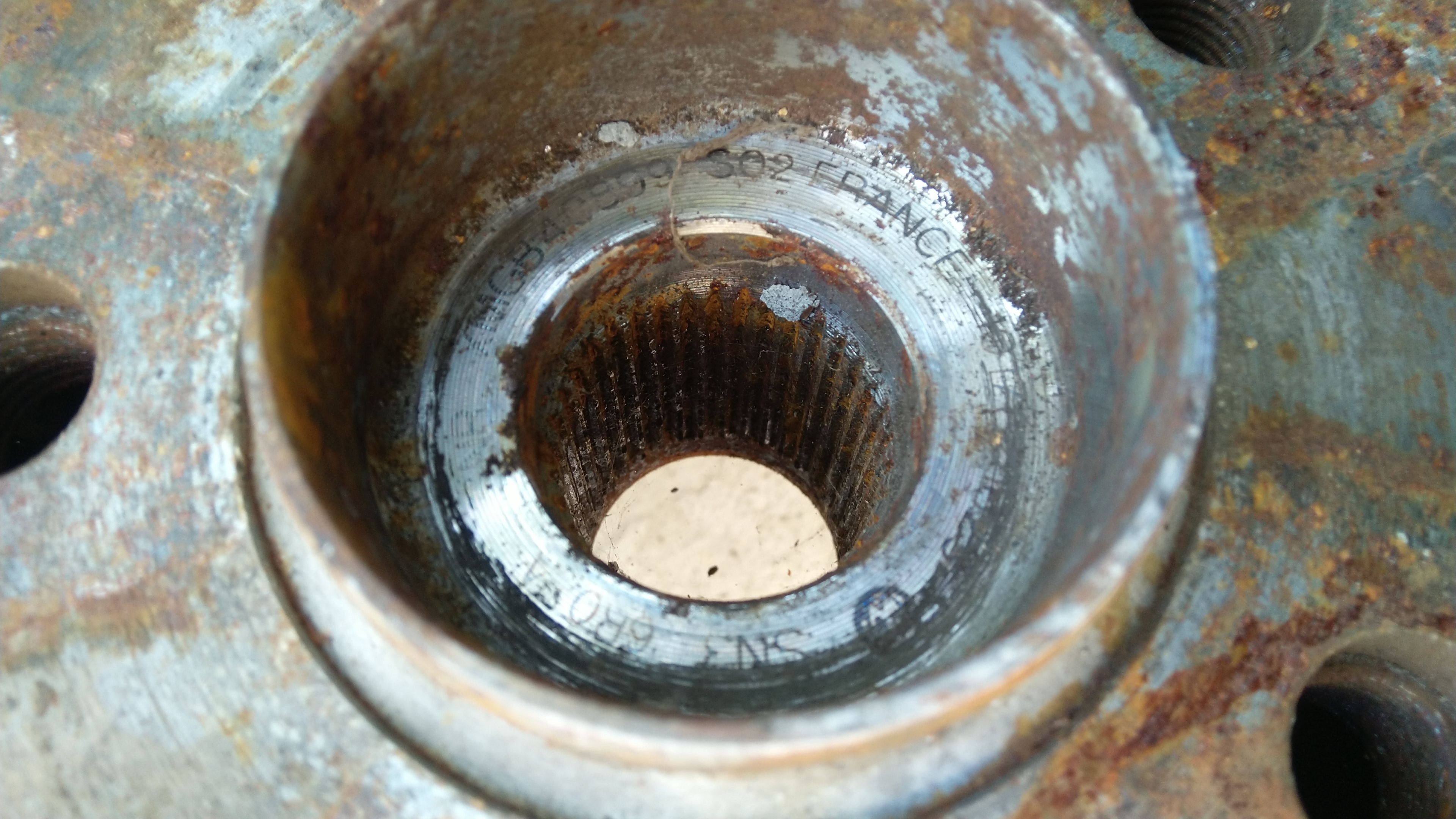

If anyone needs, SNR is OEM bearing in polo 6R
Posted: Wed Oct 20, 2021 7:25 pm
by iichel
amer6R wrote: Wed Oct 20, 2021 6:27 pm If anyone needs, SNR is OEM bearing in polo 6R
Are you sure it is not SKF?
