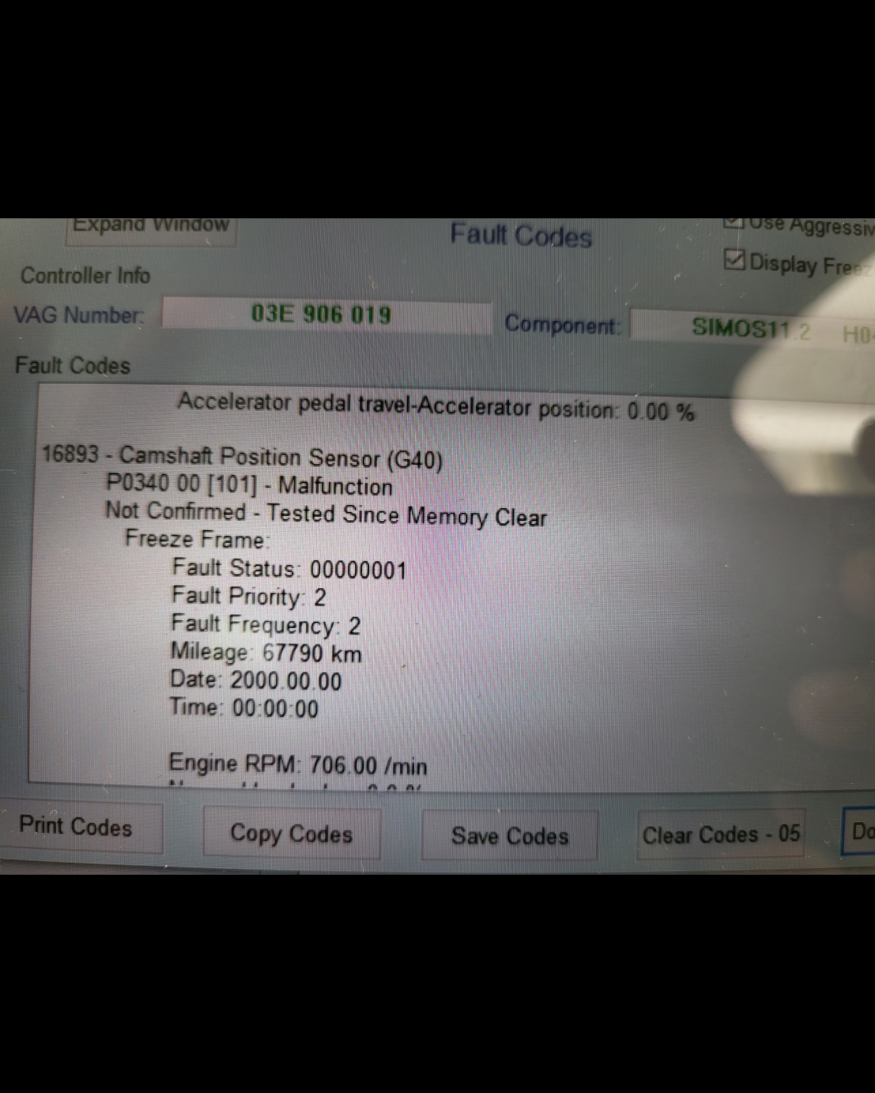

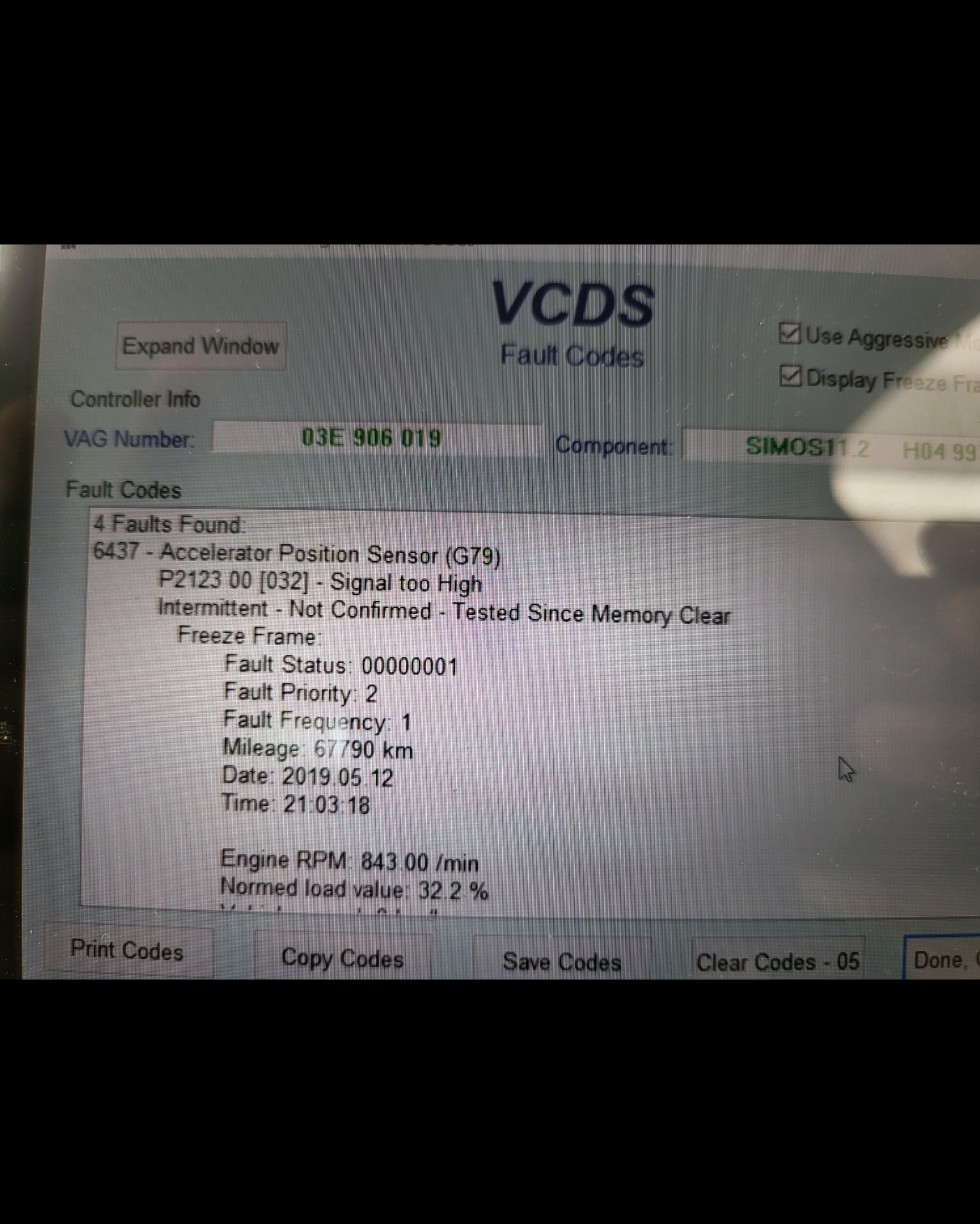

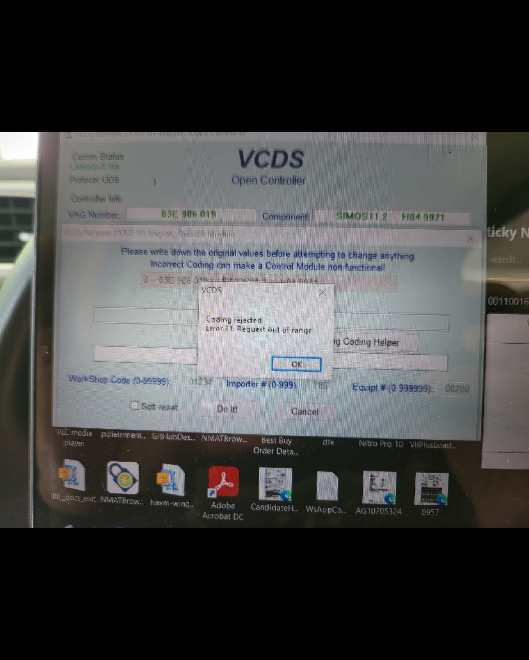

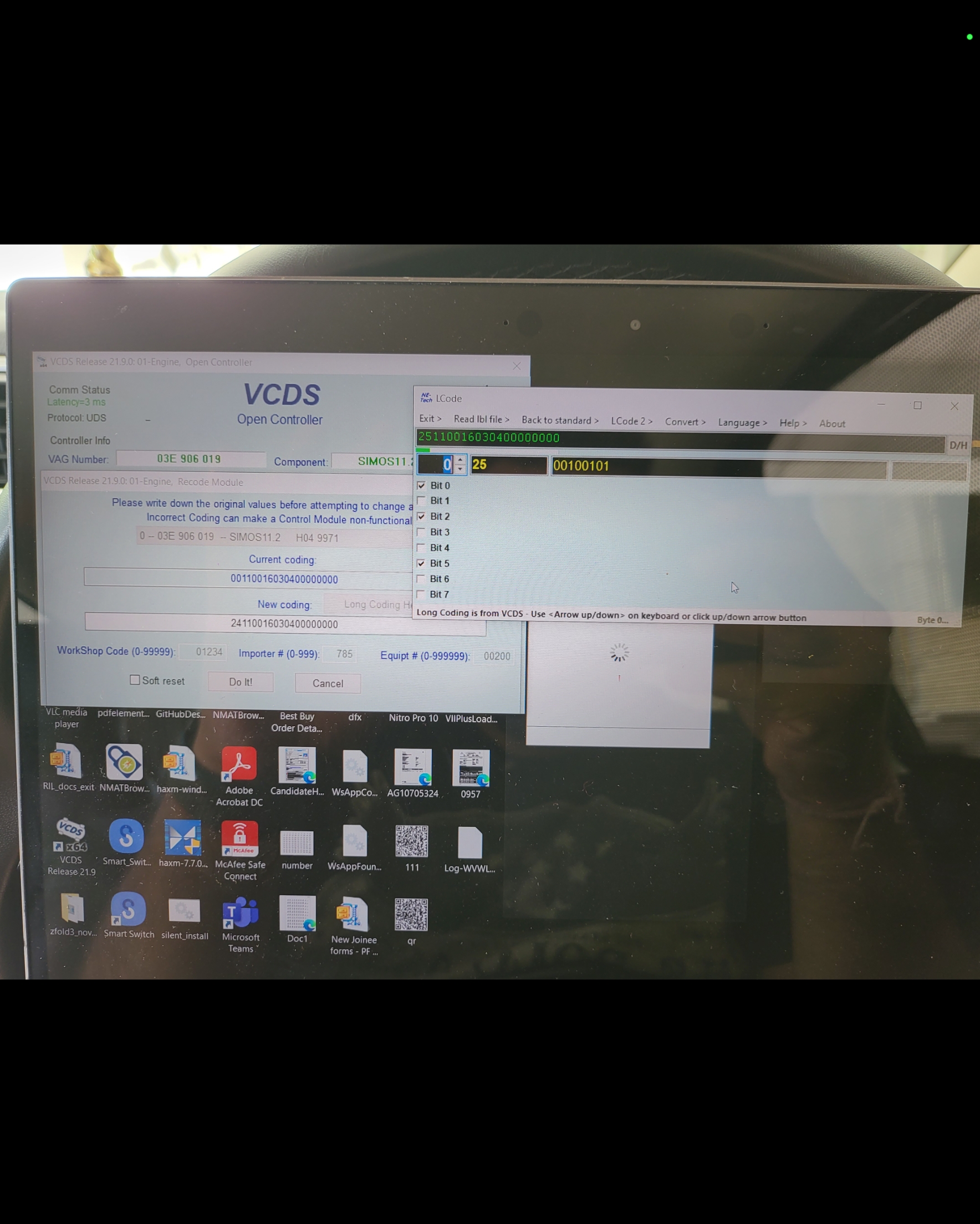

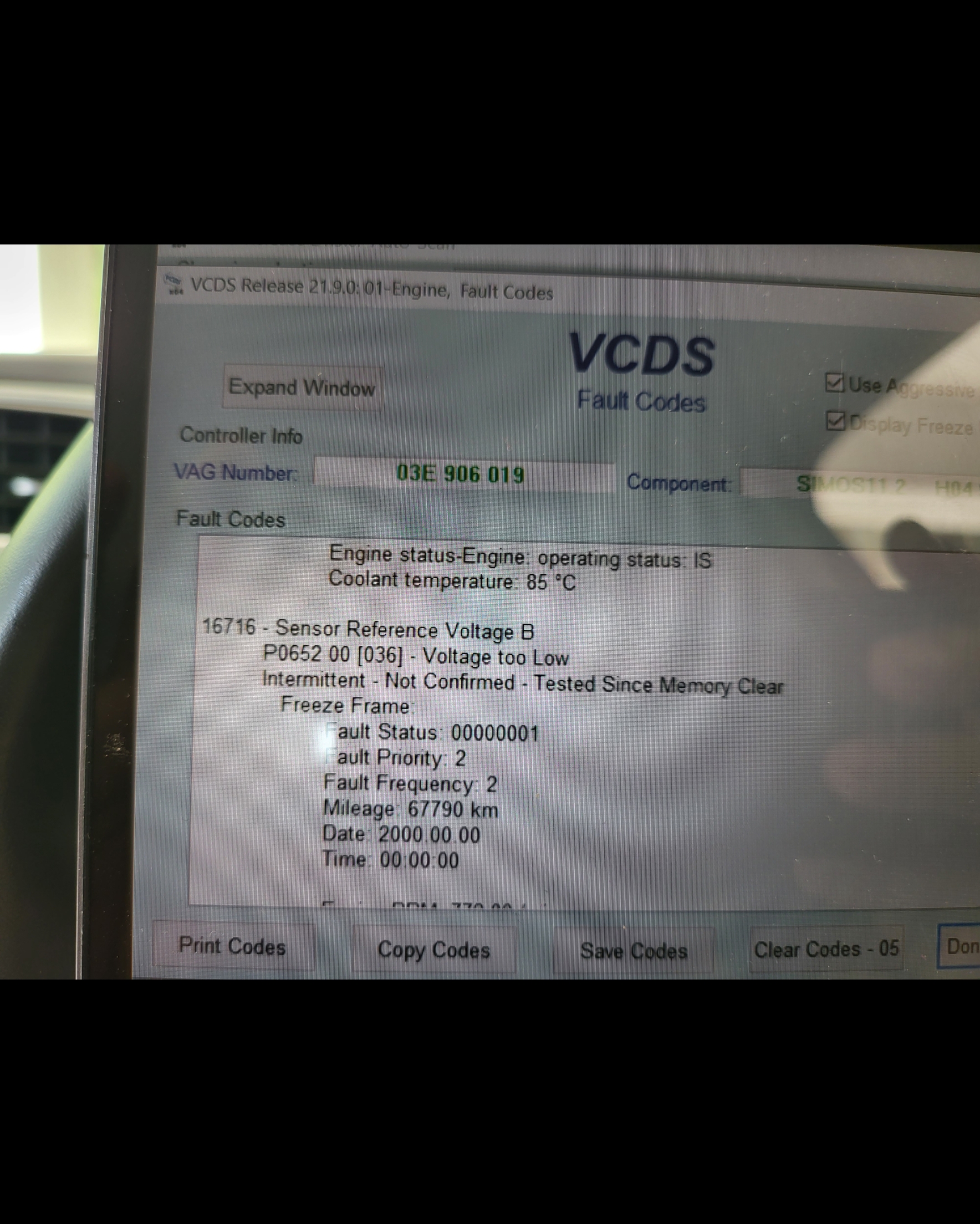

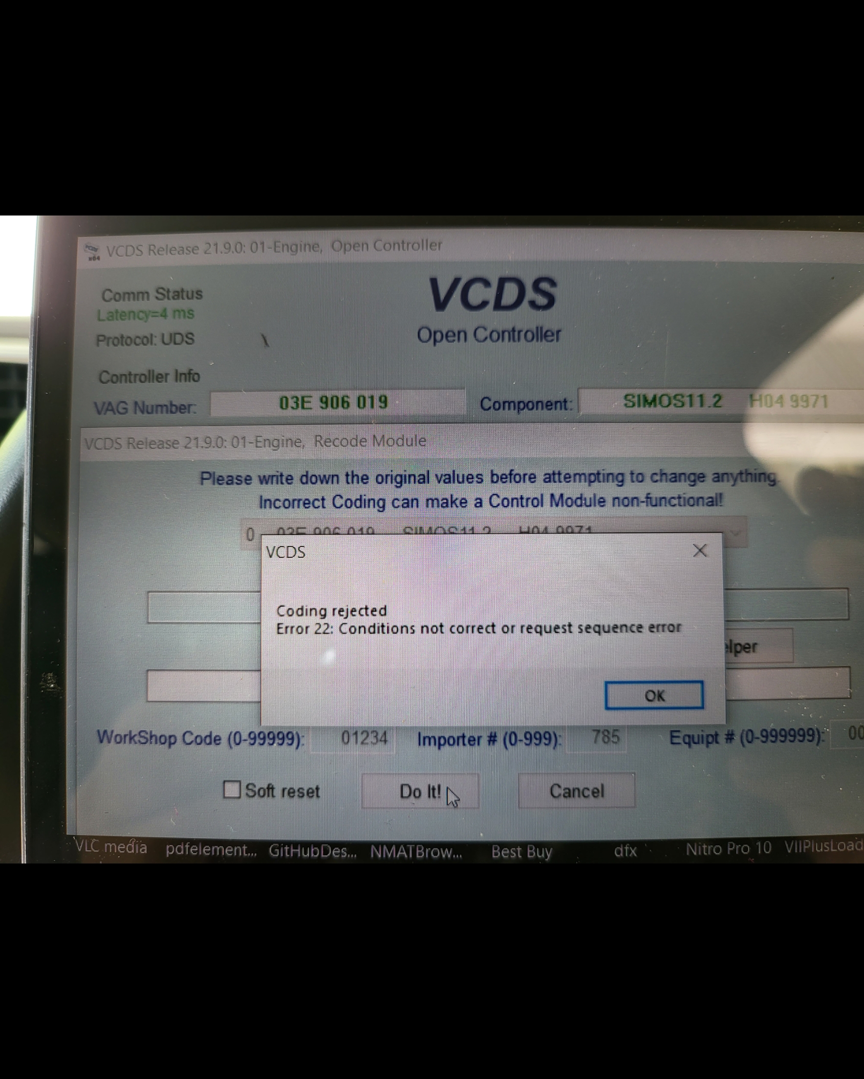

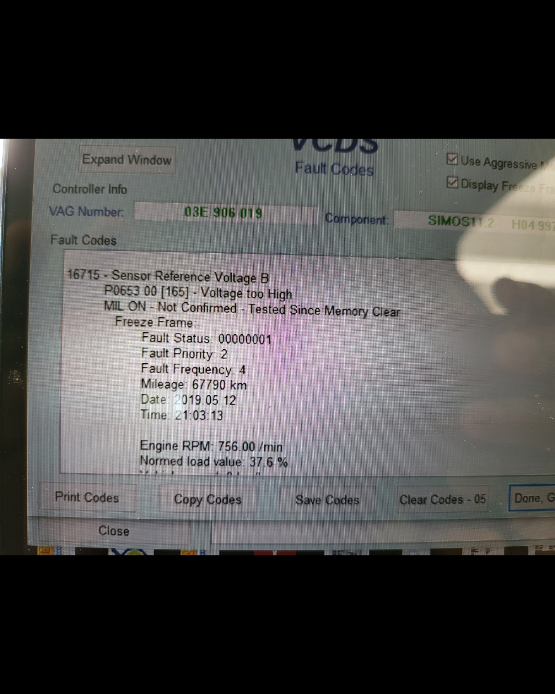

Hi guys, i have a polo 6r rhd indian unit 2015. I have installed the ccs kit from aliexpress.
The stalk i took from a 2018 car with ccs buttons and wiring from aliexpress. After installing there is check engine light and EPC light on in instrument cluster( cant accelerate my car).
Also bcm coding i have done but ecu coding says (after checking byte 5 bit 5) incorrect coding( doesnt let me code at all).
Need help guys please!
I will post vcds scan below
Any comments guys?
Any comments guys?
- Epc fault
- Screenshot_20220420-100204_Gallery.jpg (1.77 MiB) Viewed 4726 times
- Epc fault
- Screenshot_20220420-100229_Gallery.jpg (1.58 MiB) Viewed 4726 times
- Epc fault
- Screenshot_20220420-100234_Gallery.jpg (1.84 MiB) Viewed 4726 times
- Epc fault
- Screenshot_20220420-100241_Gallery.jpg (1.7 MiB) Viewed 4726 times
- Error 22 coding rejected
- Screenshot_20220420-100245_Gallery.jpg (1.67 MiB) Viewed 4726 times
- Coding rrjected error 31
- Screenshot_20220420-100249_Gallery.jpg (1.29 MiB) Viewed 4726 times
- Engine recoding byte 5 bit 5 selection
- Screenshot_20220420-100257_Gallery.jpg (1.23 MiB) Viewed 4726 times

- Posts: 8982
If you can't post an Autoscan (not allowed until you have 10 posts), upload it to a server and post the link here.
Imagination is power, especially in complicated situations...
We need the data from the most recent/fresh autoscan you have when performing this update. In the form of text (as it is generated), it facilitates our verifications about what is happening...
